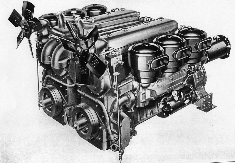

Allison diesel Engine? Photos
BOBWhite replied to realwolfdaddy's topic in Antique and Classic Mack Trucks General Discussion
That looks like a DT466 to me but what do I know. Never heard of an Allison Diesel either but my grandpa worked as a supply yard in Japan during Korea and him and his team somehow lost one of those giant Allison engines. Never found out what happened to it and his superior was pissed. Too big to steal so they think it's at the bottom of the ocean.
