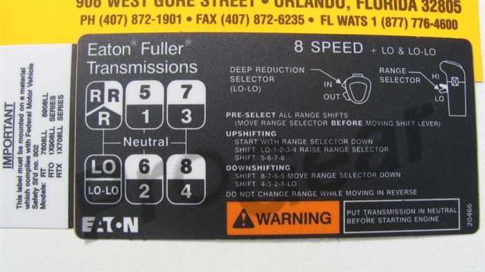

  11. Yea this is essentially what it’s for or being off road. Also might have its place under a milling machine at times. Instead of slipping the clutch.
  12. Correct, although you will find that as you go through the gears you will be at a crawl.

  24. Possible someone put the Eaton in and it didn’t come factory?
