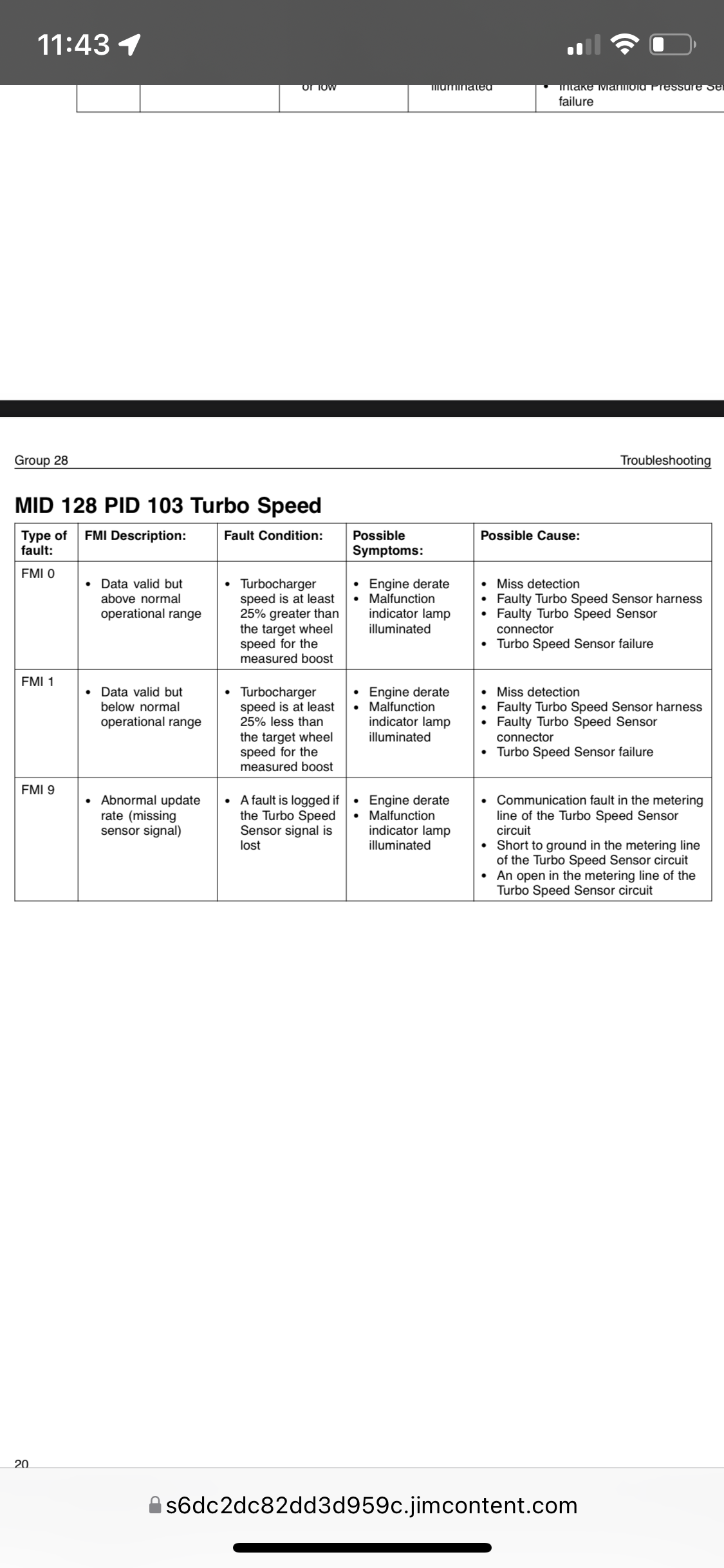

  18. Yea well without PTT I can’t tell you much more then that. These trucks are a nightmare to diagnose even in person. So it’s nearly next to impossible to do it over the internet for most issues. Volvo/Mack says for that code it can cause a derate, and to check for short to ground/broken wire in the turbo speed signal wire.
