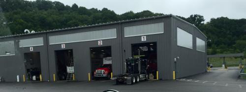

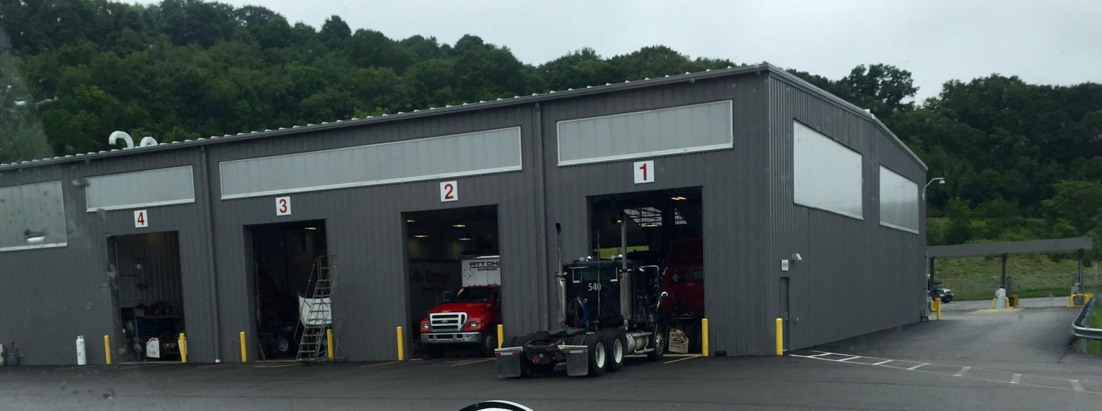

  4. Yeah pretty nice drive through bays at the garage. How are those cascadias holding up? I've worked on a couple Volvos with the CNG Cummins Westport but just for leaking o-rings in valves and fuel solenoids. Our side lot is packed with new pinnacles for delivery. The U.S. Cargo was a Hino Box truck.

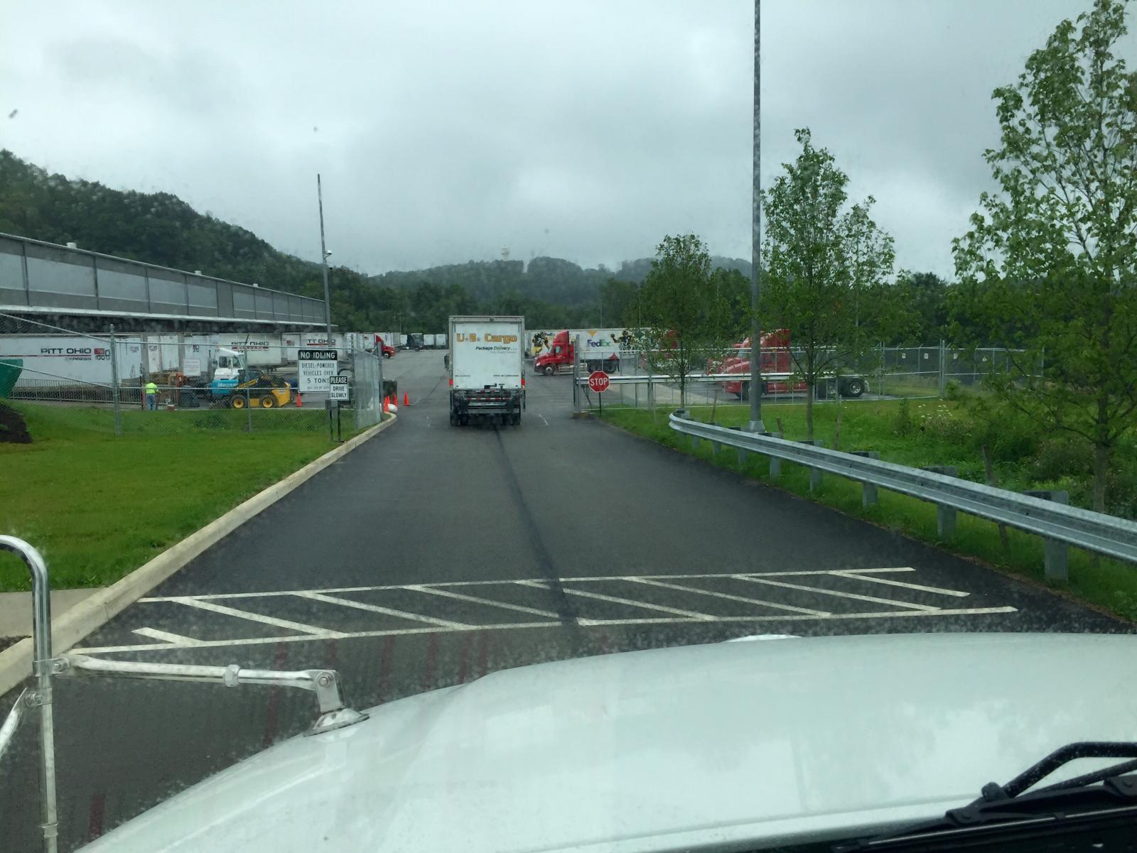

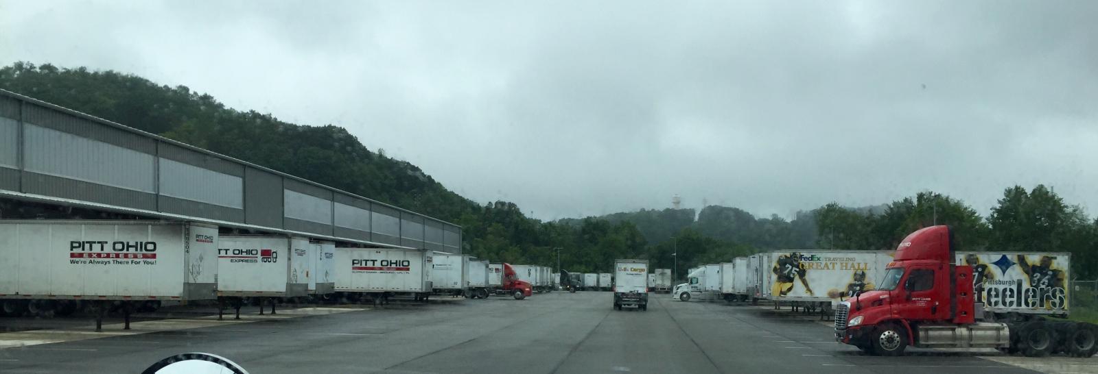

  6. We were a short a driver one day last week to deliver some new units to P-O new facilities in Harmerville. I was sent up to drop one off. It's a pretty nice complex.
