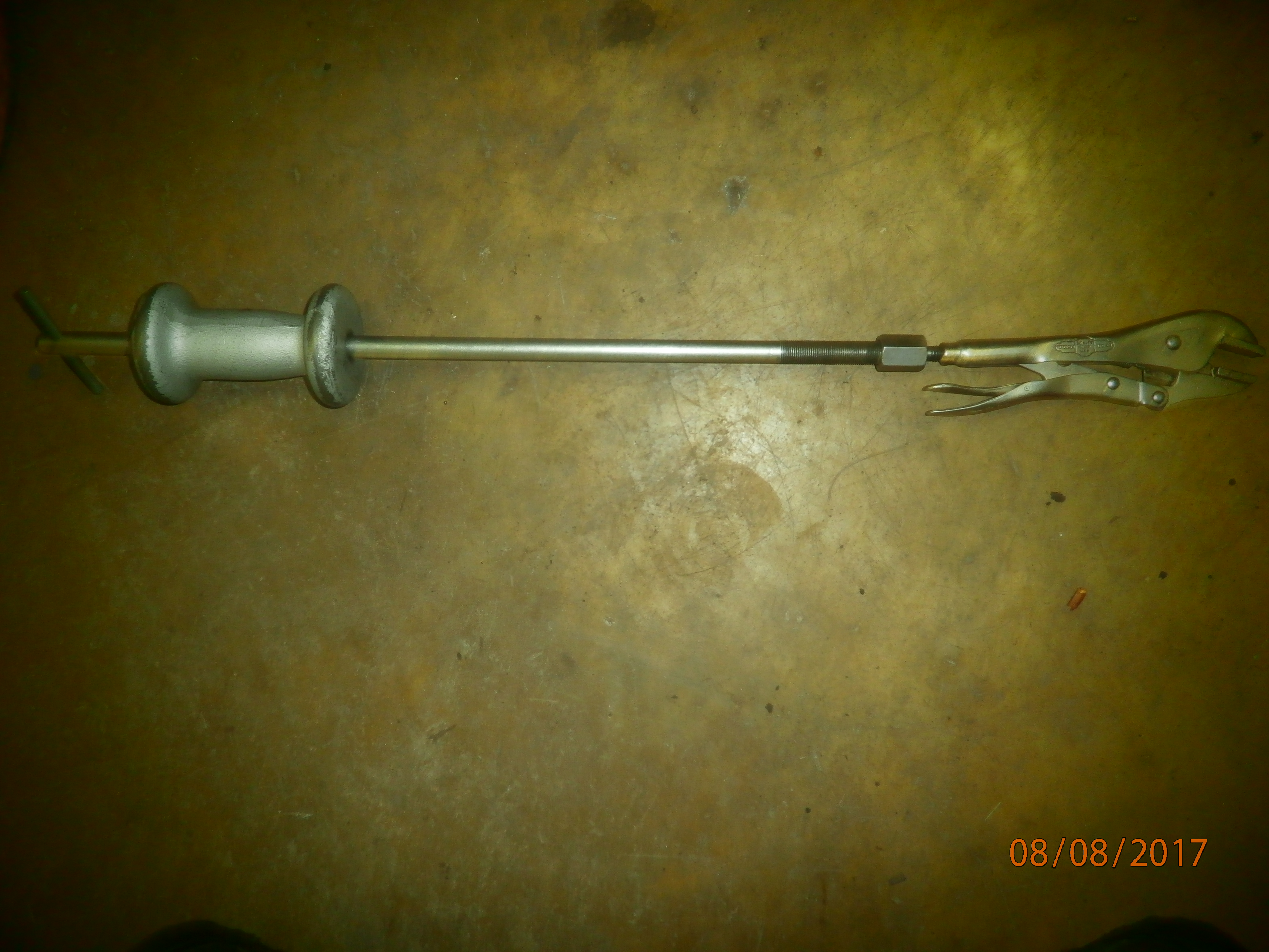

  8. Cornwell made slide hammer bits that mated to vise grip rear. It's been my friends in a lot of fights. You just need to get a hook of any kind into your victim and hammer away.
