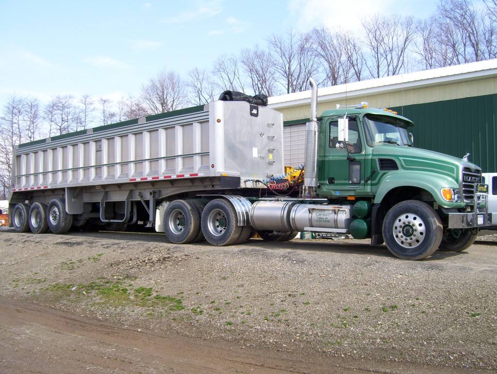

New truck Loggin Dog couldn't tear his way out of a wet paper bag below 1,200 RPM's. My buddy was panic shifting at intersections, revving way too high for shift points and was 'Quick-Sticking' for a gear hole. Having come out a 1998 PLN 427, to this new high level of dissatisfaction, we made the choice to dig in.
Retired Gernatt aggregate hauler from upstate New York. 2005 Granite CV-713, AI460, T318L 18 Speed, 200 series 4.35 Mack differential, 10MM single frame, 215" wheel base. After watching his brother suffer through DPF and SCR my buddy wanted a mid 2000's Mack Truck with no external emissions system in spite of potential low hole torque issues. He planned on 10,000 miles a year and couldn't justify maintaining an over-stuffed emission system. Gernatt pulled 107K, buddy was going to be pulling 90-100K loads hauling Feller-buncher, skidder and hot saw on tri axle low-boy.
First I'd like to send a note to any other clueless BMT newbies..... NEVER click the delete at the bottom of your "New Topic" page "moderation action" unless you want to lose all three pages of your post. I'm dedicating this second post series to all truck owners who regretted buying an AI Granite and as a memorial for all the awesome tips from NELM and MACKPRO that I cast into eternal cyber damnation.
