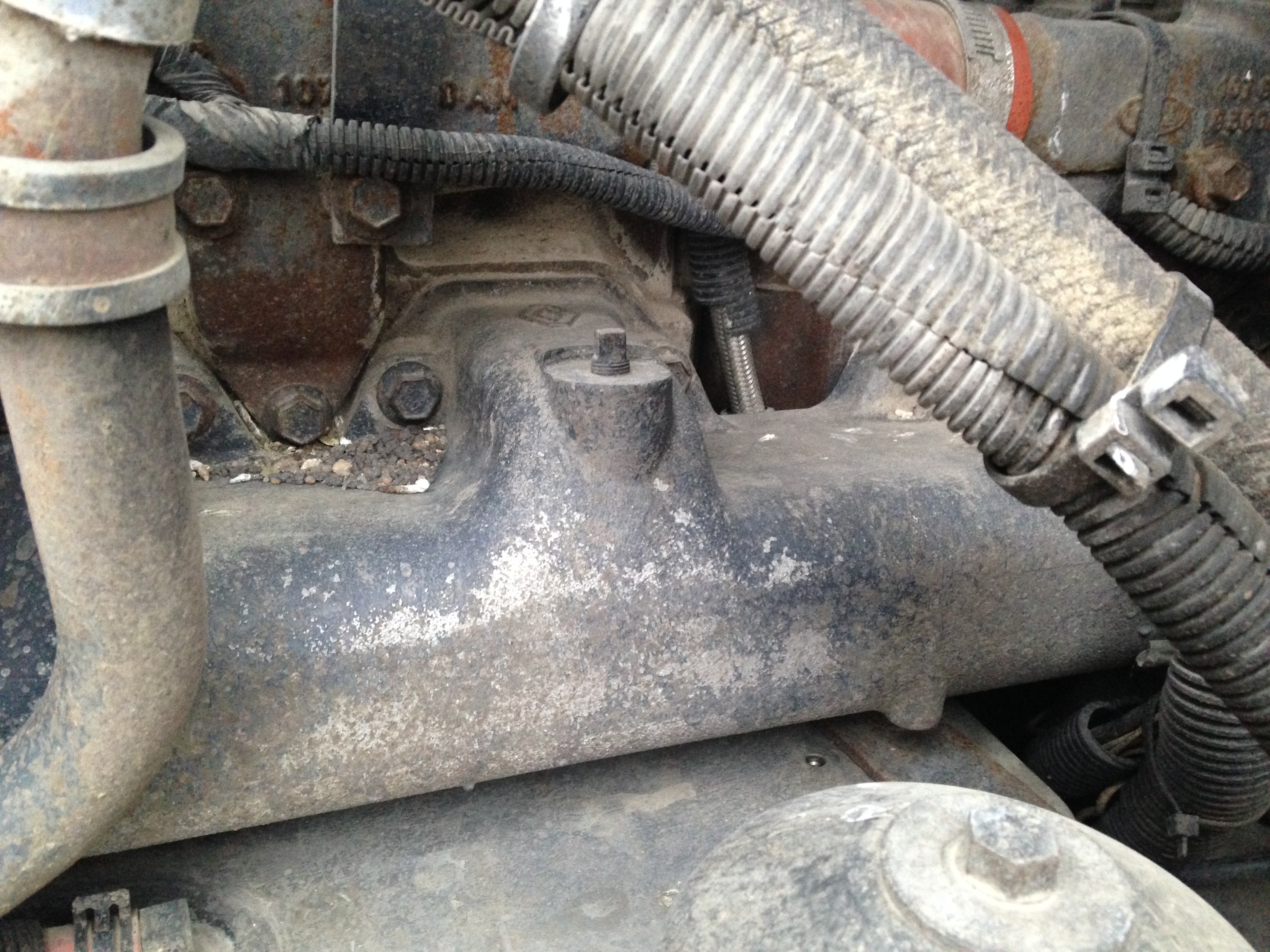

  4. So is this plug on the intake where I can put in a boost sensor? Any reccomendations for an aftermarket gauge? I'd rather put it in myself rather than take it to the dealer if possible. I'd also like an actual dial gauge rather than something that reads off an ECM. Thanks for the help.
  5. Where would I install a boost gauge sensor on a 2000 E7 350? Is there already a hole with a plug in it somehow were? Any suggestions on where to get a gauge? Order from dealer? Thanks for for the help
