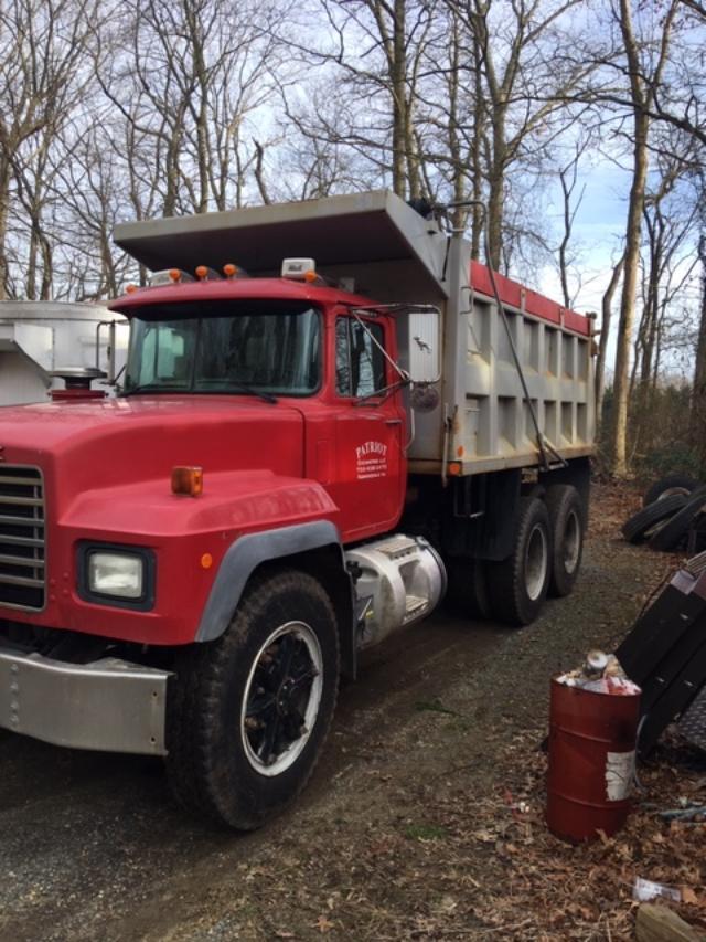

  5. No, I haven't done anything with that truck. I ran her quite a bit this summer though. It is quite agrivating the way it lays down on you. I'm probably going to do a turbo and injectors and a new exhaust manifold on it this winter.

  8. What does AI mean? I'll look at the valve cover tomorrow. My concern is if I put Rochester injectors and turbo on it, will the lag go away? I have their stuff on another truck and love it.
  9. I just bought a 2003 RD688SX tandem dump truck. It has a 8LL and 400. I really like the truck. It pulls well but has a two second lag between when you lay the fuel to her and when she starts to hunker down and pull. I intend to put a bigger turbo and honed out injectors on it, but am concerned that this lag will still haunt me. Have anyone been down this road?
  10. Do you have a gauge for boost? What are you reading on those long pulls when pyro goes up? My boost snaps up to 35 PSI and stays there. Rochester's turbo is $2,200. Well worth it. Have you smoke tested the truck since the new injectors?
  11. When you guys are referring to stage 2 or 3, whos injectors are you using? Did you put bigger turbo on with injectors? I've done two Mack E7 400's with Rochester parts. Both made a tremendous difference. My pyrometer never gets high. My first one was 2.5 injectors. The second one, which I still own, is a stage 3. It passed a smoke test with no problem.
  12. I paid $2,200 for the turbo. I don't know if that's cheap or not. It works great with the added amount of fuel they're injectors flow. I did the second installation three months ago.
  13. I've done two E7 400's. Both ran great!! One was 2.5 other was 3.5.

  15. Call Rochester Diesel. I've put his stage 2.5 and stage 3.5 on my trucks. Definite usable increase in power. He'll send you a new turbo and necessary rubber fittings to make it fit, and honed out injectors. He'll want you injectors for cores. Both trucks I did were E7-400 Macks. Both drove GREAT afterward!! Ask for Brad 507.288.8038
