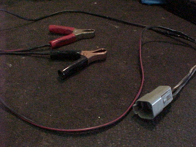

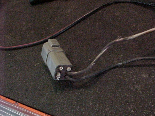

Last Friday I did my first test with my Mass Flow "fooler" and it did not work. Even with the correct ohm resistors installed it came back "open circuit" on the Mass Flow sensor. But I will not give up. Blocking off the EGR valve is somewhat easy. but I want to remove everything to save weight, I started to weigh every part that makes up the EGR system and it is close to 60 pounds of crap that we could remove from the engine. This week might be slow enough I can mess with it some more.
