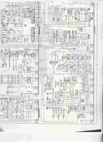

  12. Any certain area, my diagram is quite large, I can copy the part you need and post it here.
