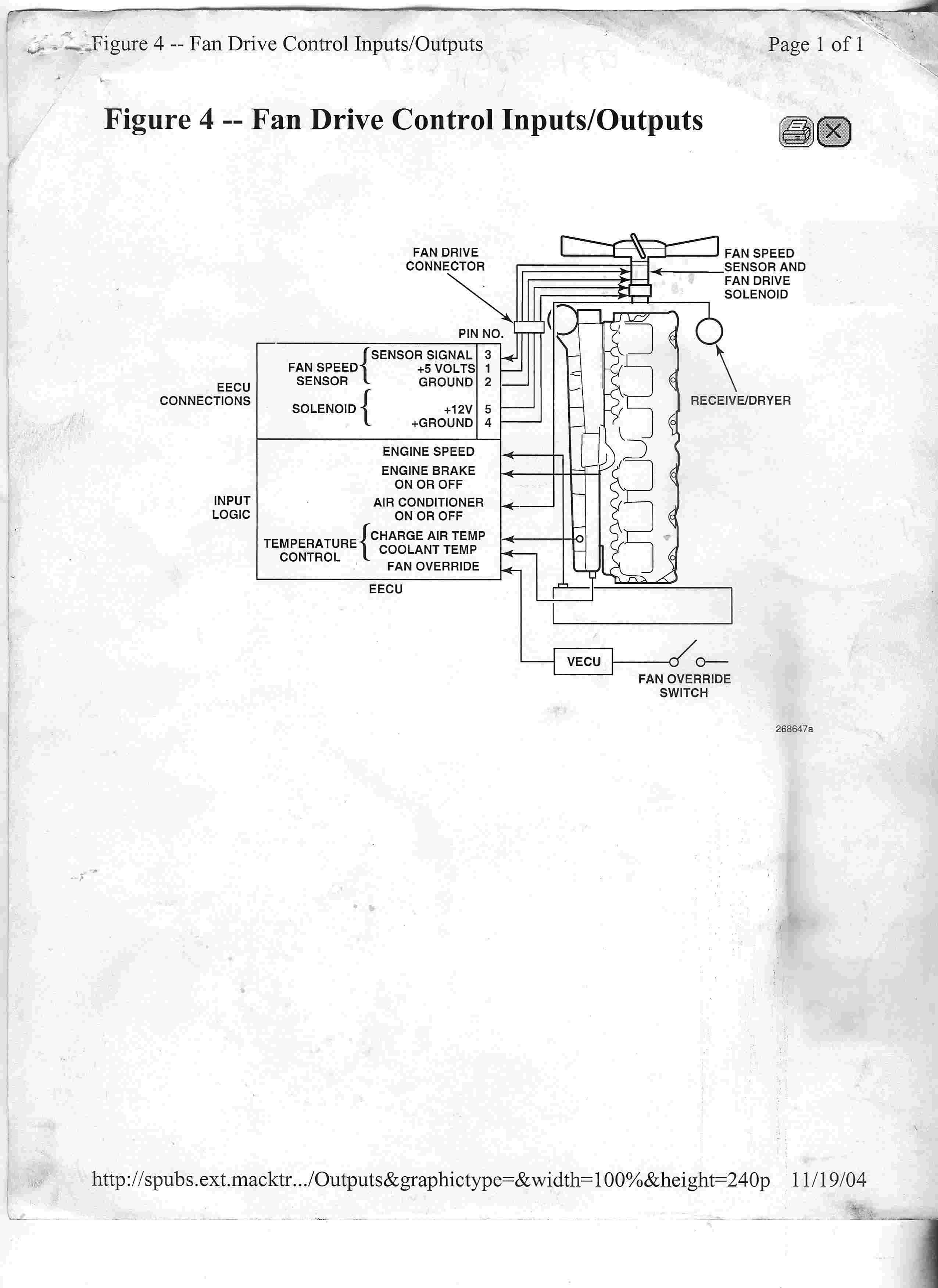

When we get a used truck in with one of thoes APADS boxes on it , we take it off and throw it away. One of the worst things I have ever seen mack put on a truck. If you dont have an air fan clutch its real easy to remove. Just unplug all the connectors from the APDS going to the engine harness, You should now only have 3 plugs, 1 single wire plug for the compressor, 1 double wire plug for the switch on drier and another double wire plug for the high pressure sensor (for air fan clutch only) on the line between the drier and condensor. Sometimes you have to buy an new drier to condensor line that has a place for the high pressure switch(only if you have an air fan clutch). Buy a factory standard high/low pressure switch and install on the drier and plug it in and thats it. If you have a air fan clutch you also need the high pressure switch. I can get you part# if you want. The APADS turns the standard simple mack a/c wiring into a nightmare. -
