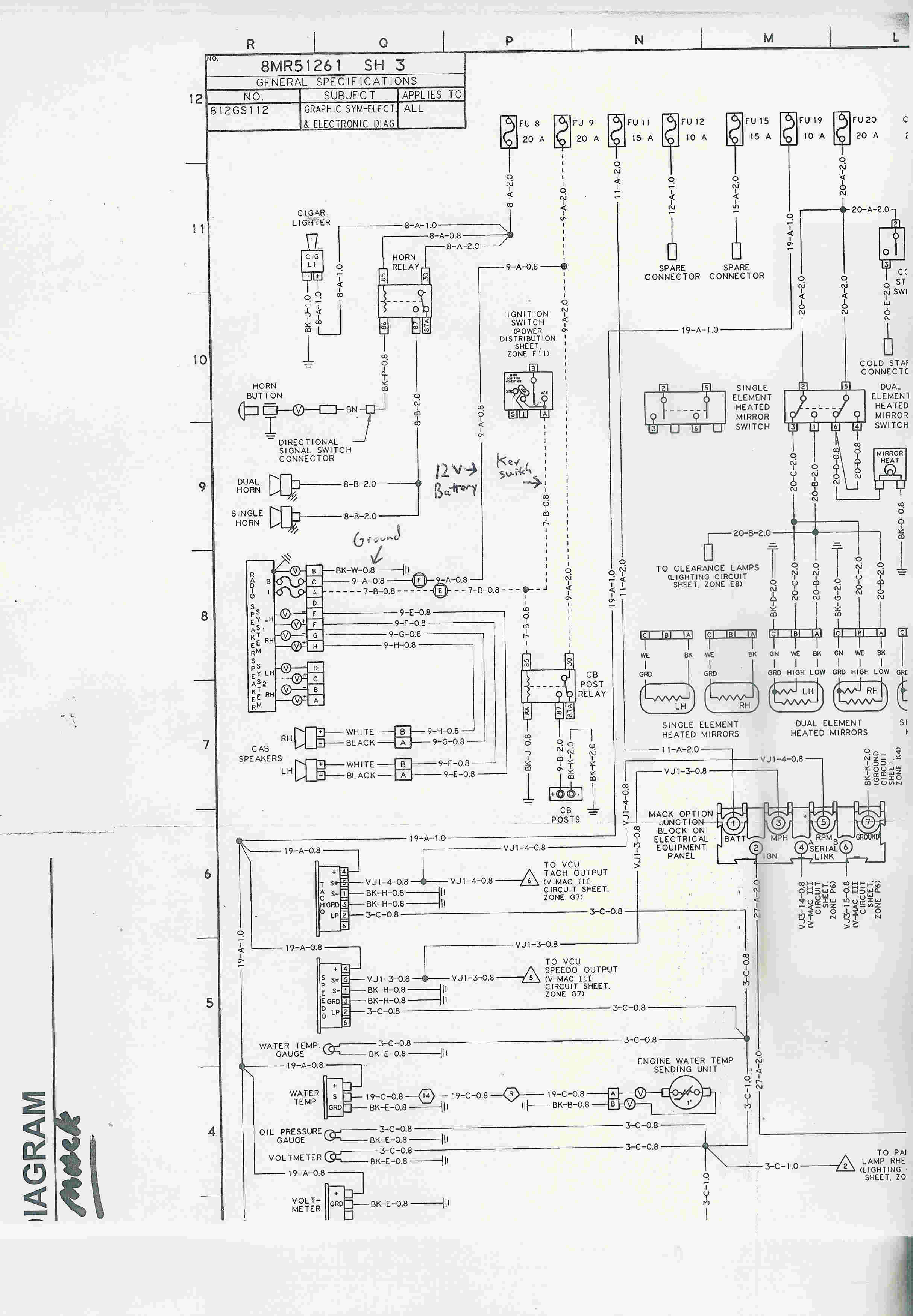

Wiring 2007 Mack Mr Stereo
Mackpro replied to eviiil's topic in Electrical, Electronics and Lighting
