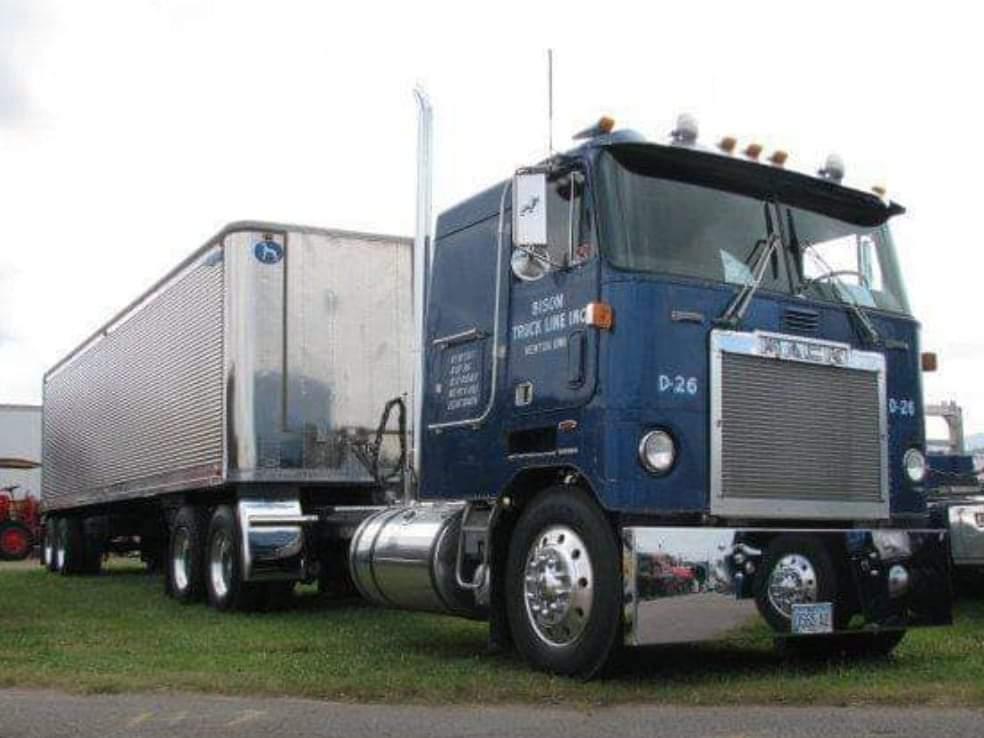

Bisom truck lines newton IA
Lmackattack replied to Lmackattack's topic in Antique and Classic Mack Trucks General Discussion
I think I was at Walcott 2005? and thats where I remember seeing it. It might have been the superliner but I just cant recall -
