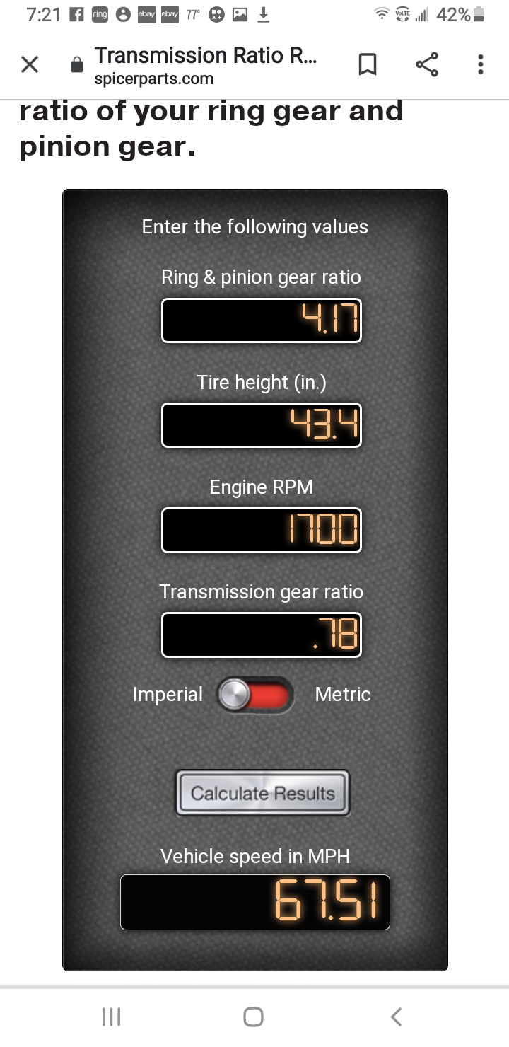

You have what many mack guys call a low rpm engine. It is set to 1700 in attempt to gain fuel economy. The trucks built with these engines would l have had different rear gearing to compensate for the reduced rpm. You will need the pump recalibrated to 2100 rpm specs to gain more rpm. Not sure if you can do it while its still on the truck but I know it can be adjusted. -

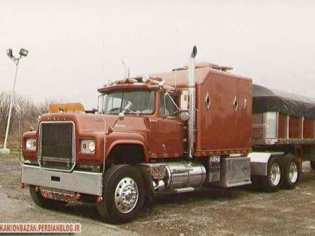

tall hood R models usually refer to the later model years of the Mack Western RS700 and the RS600/valueliner. i think the change to the tall hood was around 73 when the plus 3 cab came out? the reason for the change was for larger radiator options. it also simplified the bumper and hood assembly by omitting the hinged grill used on earlier models. i think the hoods had 4" added to the sides. here is my tall hood 700 -
a few reasons. 1 they had inventory issues and shortages. in attempt to keep up with deliveries,Mack was sending half loaded trailers with parts from the mack plant in PA to CA and emptie trailers back to PA just to build the westerns. 2 Mack didnt have a very large market share out west and Pete / KW was fastly gaining in popularity 3 i also heard staffing issues due to the laid back CA culture but who knows

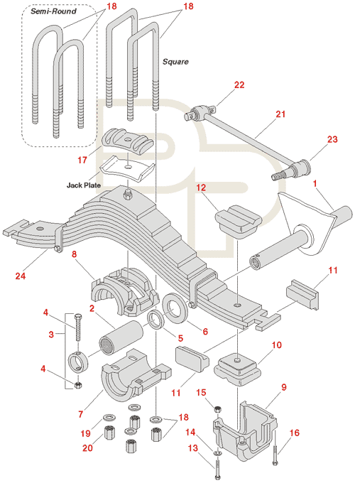

look at the spring end caps. are the springs centered? or almost touching the box?. is the trunion bushings tight? or pushed out?. track rods good? look to see if bushings are rubber or upgraded to urathane. when its loaded and you turn do the axles stay put or walk sideways. look for rust and rot at the lower trunion. patch welds? look at frame rails where trunion bolts to for rot.
