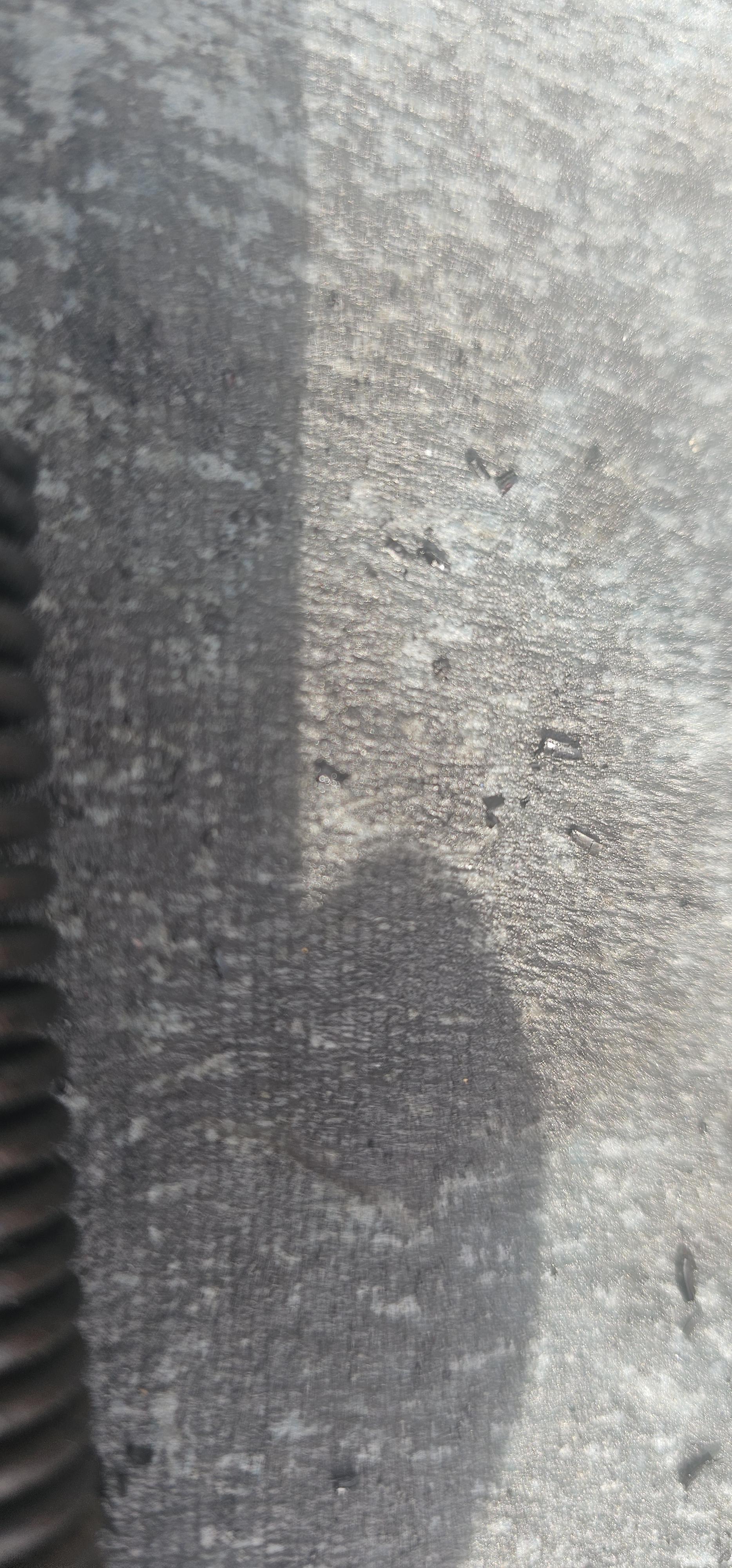

Weather finally let up from the heat wave we have been dealing with. 67 degrees all morning so I jumped on getting the heads back on. Barely broke a sweat working outside until 2pm. You can see the carbon build up on the 2 studs that was not allowing the heads to come off. I spend 2 hrs removing the stuck nuts from about 30 studs then wire brushed all the studs and threaded holes. Ran a tap thru them to clean them out and was able to put the studs in with just my fingers. Scrubbed all the old gasket material off the mating surfaces, Pressure washed the heads put New head gaskets on with new fire rings. Was able to set both heads on as an assembly just how i had removed them with absolutely no trouble. One thing I noticed with this job is when I had removed the head studs/nuts all but a few came out with just a hand held 1' long 1/2" ratchet. They took no where near the effort of 175ft lbs to remove them. Today I used a 3' long torque wrench and it was pretty obvious the old gaskets were not held down as tightly. I suspect the old gasket was just soft with age or someone did not torque them properly. My book says to check them again after 1 hour of under load time. -

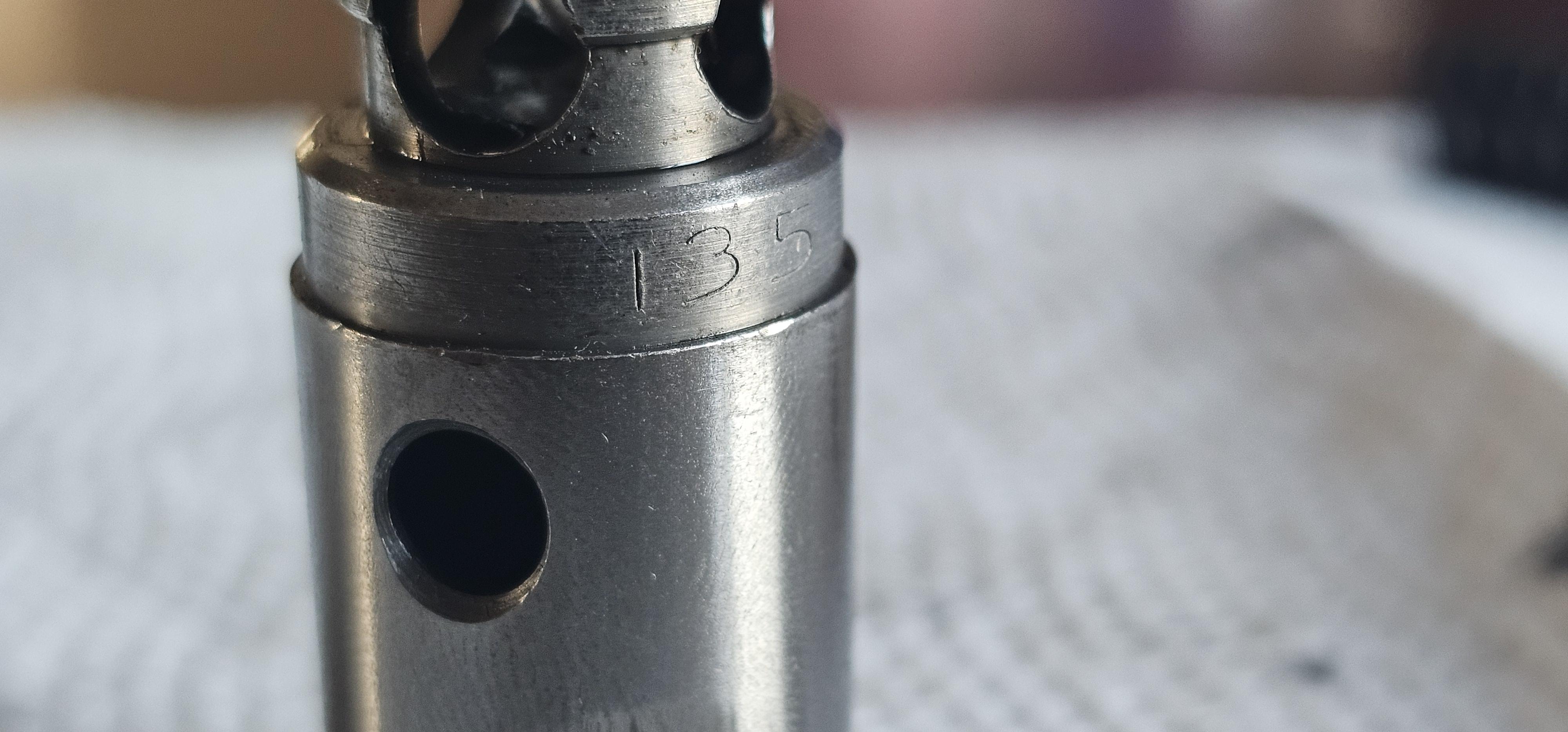

Thank you. That's what I figured. My book made no mention of that they were all stamped the same -

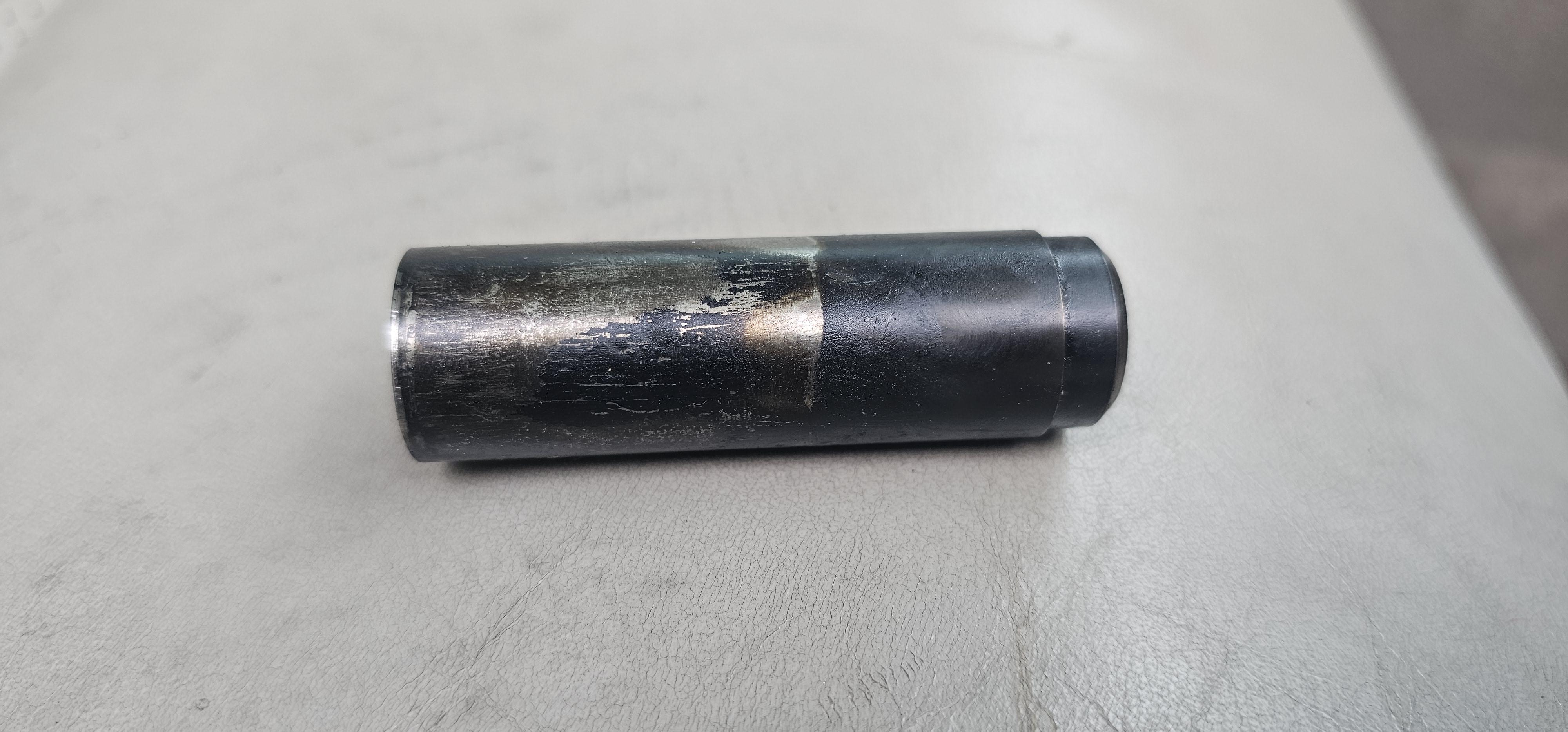

I'll get a better picture of it tomorrow. I got done with work around 4. And spent the next hour, pulling the heads off before i had to head home. I didn't feel anything but I also don't have a lot of experience with engine internals. -
2V maxidyne, issue pulling heads off
Lmackattack replied to Lmackattack's topic in Engine and Transmission
No clue. I could not feel it with my fingernail. I'll get a better Pic of it. -
Yes sir. ITS A 283HP ENDT676 -
No way I could pull this assembly up by hand !!! I had a service crane with 4 chains to keep it level. -

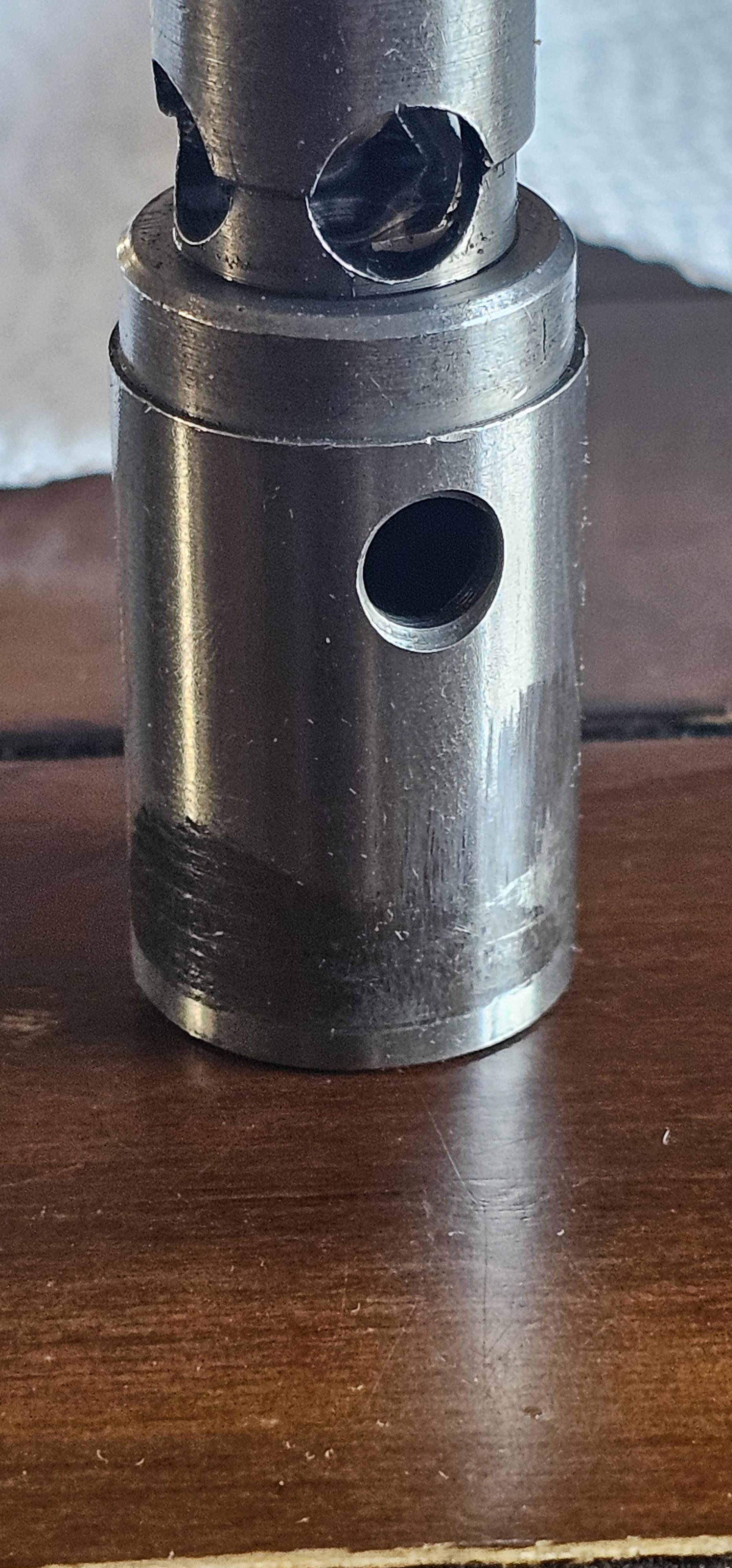

Hope not. Liners were very smooth so she probably needs new rings and a cross hatch. At that point might as well inframe it. I'm not sure if it's ever been rebuilt. Pistons looked very clean for it's age. No carbon build up on them or heads. What is the 542c stamp on the piston telling us.?
