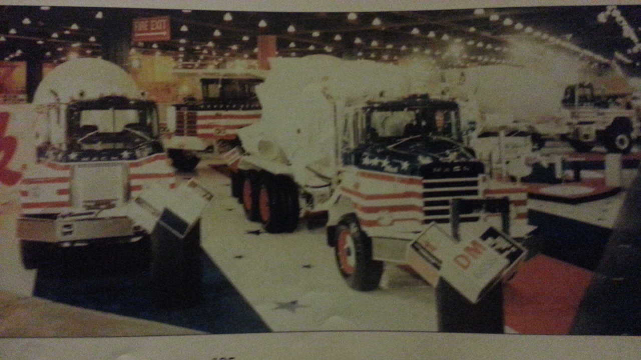

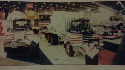

  2. Didn't the "bicentennial" colors actually appear in 1970 as the "70th anniversary" colors???
  3. Thanks, 'Dog! I thought I was on target on the older stuff. It's the newer stuff I don't know st about!
  4. Yep. Here it is. Looked all over the house before I realized I was sittin' on it! Sorry for the less-than-perfect pictures. But, I think you can see them okay. These are from a book called "Mack, Driven for a Century".

  11. Red U or DM in the background. Good eye, Vinny.
