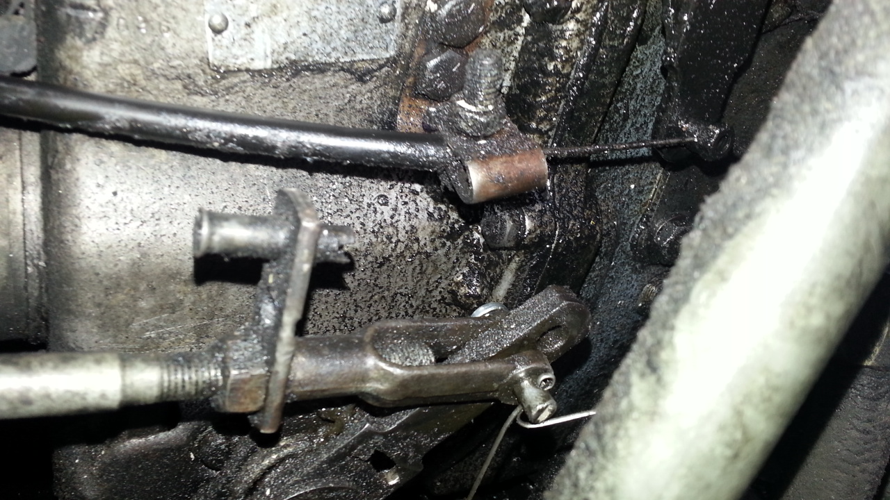

  1. Another shot, after a little more tweaking & a new Ny-Lock nut...

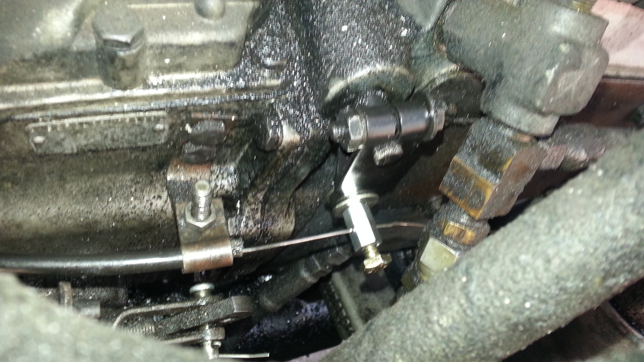

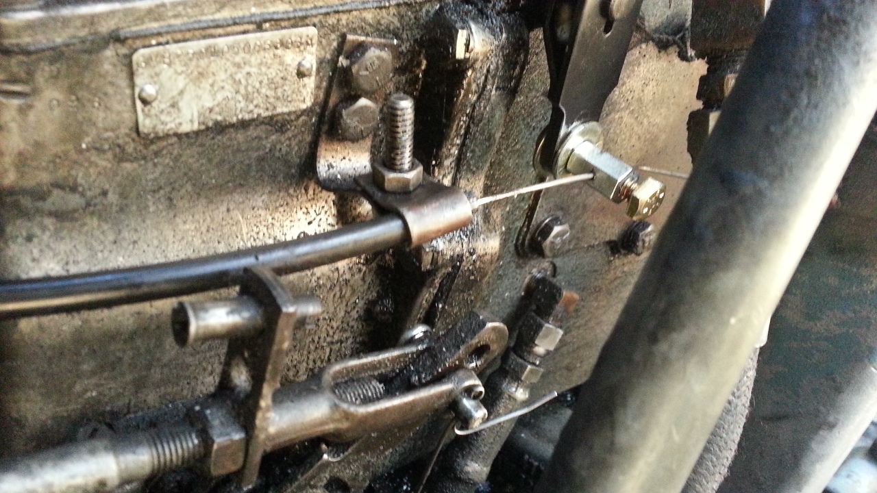

  2. Yep. Precisely what I did. The clamp now holds the stop cable. The stud on the pump arm was worn the f#@k out. Almost falling through the arm. Of course, nothing to be found. So, I had to make my own. The hex piece is a coupling nut. There is a shouldered grade 8 screw in the back. It is tightened into the coupling nut firmly, & Loc-Tired. Then the wire hole is drilled through. Finally, the outside screw clamps the wire in place. The washers on either side of the arm take up extra slack, but still leaves the assembly free to rotate in the arm. Looks pretty good, I think.

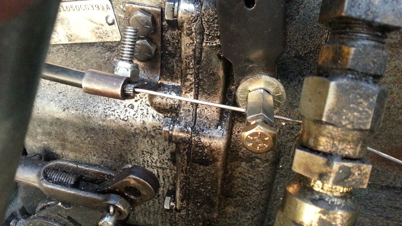

  4. The shutoff cable has nothing on the end of the sleeve. It does look like it USED to have something on it. Currently, it is being retained by the narrow slot in the clamp. The round part of the clamp is considerably larger than the sleeve, which is why i think there may have been a ferrule or something on the end of it.Incidentally, I found some cables fairly cheap on www.fortpro.com. Anybody know if these are any good?
  5. Any thoughts on the "end" of the tube on the shutoff cable? I'll see about making up a throttle bracket.

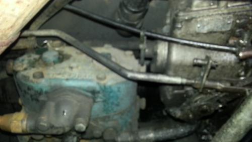

  6. In one pic, you can see the stop cable. If will fall through the clamp. So, somebody just wedged the tube in the split of the clamp. Maybe it needs an end of some kind? In the other, you can see the slip-tube on the throttle linkage. But, there is no bracket on the air compressor (or anywhere) to lock the tube in place.

  11. You ain't right, 57!
