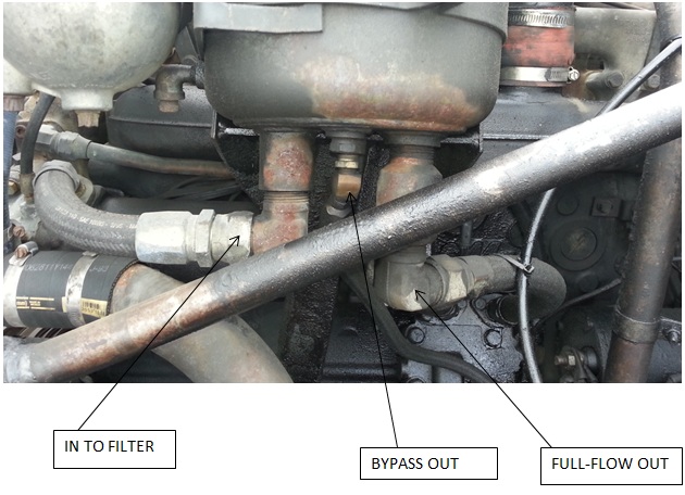

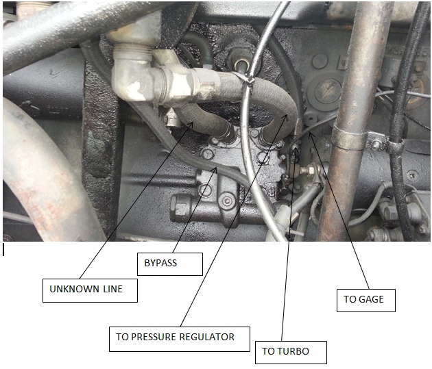

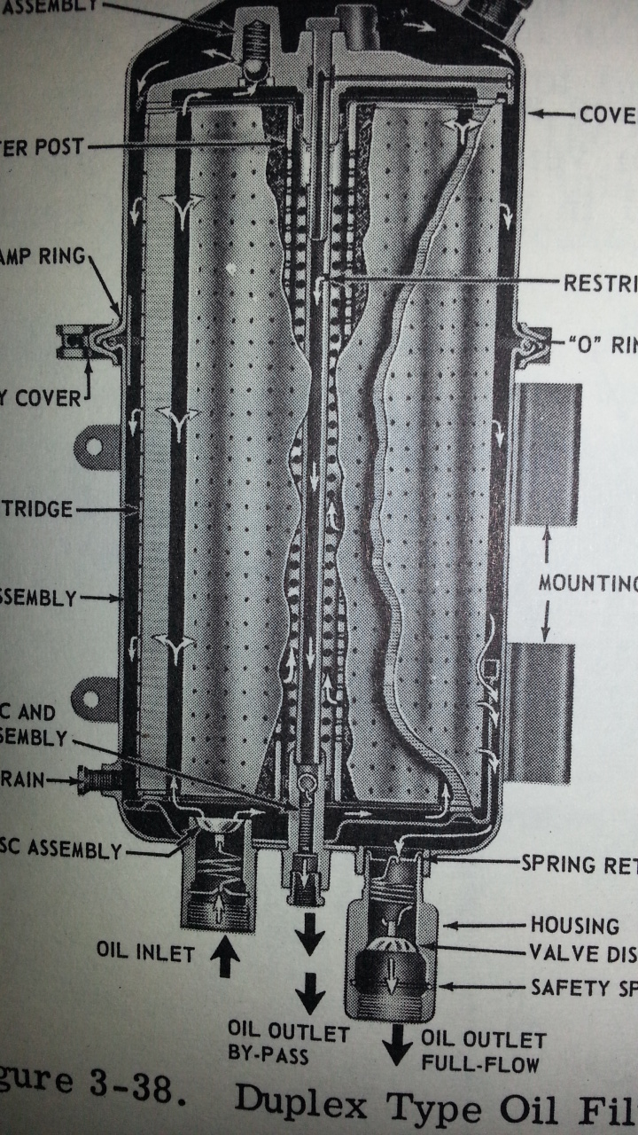

Yeah. That would make sense. If the oil comes out the unknown line, then passes through the cooler, it would then come out of the cooler and into the filter. Filtered oil would go out the big line, and bypass-filtered oil would go out the small line to the pan. What really drives me crazy is that none of this mess is necessary. If you look at the 3 lines coming out the bottom of the filter, they are the only things set in stone. If the supply line could connect to, let's say, a commercial dual-filter head, with an integrated bypass valve, the filtered oil could come out to the big line and the bypassed oil out to the smaller line...or even to a bypass filter. On your setup, it appears that the bypass valve is integrated into the pressure regulating valve. Bypass oil is likely dumped right back into the pan. Atually, the filters are probably a "bypass" type filter, with a built-in bypass feature. On mine, the bypass valve is integrated into the filter unit. On the pictures of the Maxi units I posted, I believe the bypass valve is integrated into the head. Seems like a great opportunity for a "generic" conversion system. Instead of changing all the coolers and manifolds, just need a unit that connects to the existing hoses. I could probably design it, but might need some help getting it manufactured. Am going to look into the Mack bypass valve parts a little more...- 44 replies

Look at this Mack drawing, noting the external check valve on the filter. Then look at my "OIL FILTER 1" picture, above. This is why I thought the in and out lines were where I marked them. Either I have them right, or the filter housing is installed backwards? Or something else...- 44 replies

From the looks of the PAI drawings, the 2 lines on top of my relief block MIGHT go to the top of the filter adapter? If so, they use a different manifold arrangement (3 bolts instead of 4). I wonder if the oil cooler on this 673C is the same as on the 675? If this is a different animal, too, it may get complicated. And, yes; my in and out MAY be reversed. I need to review my book tonight to see how the oil flows. Got a response from Gene at State Line. He gave me some pretty generic information, but nothing specific. I sent him some of these pictures, and asked him if they pointed him at anything specific. But, he also gave me a VIN number for a truck to use as a parts list. That might help. My biggest problem is that I simply don't have any sources around here that I know of with salvage tricks sitting around to pick parts off of. So, I have to count on others' experiences to point me at the correct parts, and THEN try to source them...either new or used. It ain't easy livin' in BFE.- 44 replies

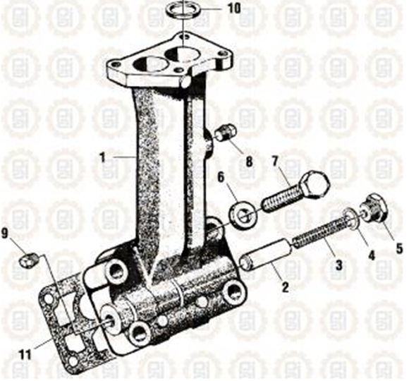

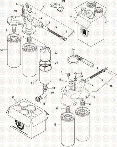

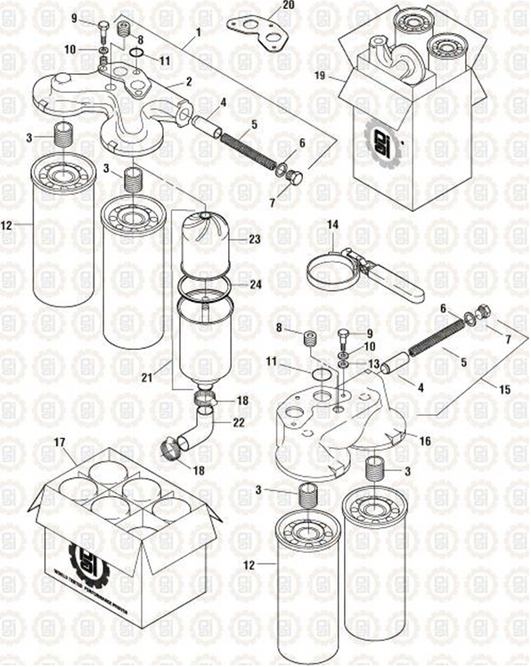

And, here is a different pressure regulator block from the PAI website. I am assuming this is the type one would use. Also a picture of their oil filter adapter. Can't tell what would happen with that "unknown" line, above. From their pictures, it almost looks like there is one regulator piston in the block and another in the filter adapter unit.- 44 replies

Here are a couple of shots with arrows to the various lines. Maybe this will jog some memories as to what goes where, and why...- 44 replies

So, from my research so far, it LOOKS like you remove the existing oil pressure relief valve assembly, and bolt on the different one with the tall "neck" on it. Then, the filter adapter bolts to the top of that "neck". After that, it's just a matter of connecting things. So, looks like it would be very important to have the correct pressure relief assembly, to line up with the correct number of holes in the block. Right gasket would probably help, too. Looking at my pictures, I can see where part of the lines go. But, it's raining outside right now, and I don't want to get wet looking around. I assume the line coming off the oil cooler is the supply to the filter. The other large line off the filter goes into the pressure regulator. The small center line off the filter appears to be the bypass return line, and goes into the block (or pan), and drains straight into the pan. i think I can see the turbo feed line coming off the RH side of the regulator block. And, the oil pressure gage line appears to be right next to it. There is another larger line, on the LH side of the pressure regulator block. In the pictures, I can't see exactly where that line goes. I think it would be inportant to know, however, since that is one of the lines which appears to go bye-bye when you put the different regulator body on there. I'll doctor those pictures, and see if anybody can give me more info.- 44 replies
