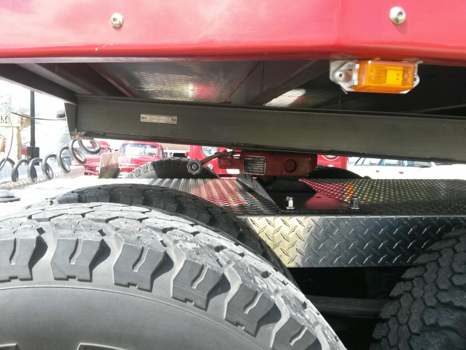

Weather turned out decent this afternoon so I was able to get these glued on with the welder. I am using it to cover the old frame that was banged up pretty hard. I got most of it straightened but after heating and banging on it, it really never looks like new so since I have some left over pieces I figured I should cover it and it will add strength as I decided to completely weld it all the way around in stead of stitch welds. I did that in hopes of corrosion prevention I left a small weep hole at the lowest point. On Friday I spent about an hour or so and did some grinder work on the gooseneck and cleaned it up and it looks pretty decent. Waiting on slack adjusters and four spring brake chambers, then I will tackle the wheels. I have the air tank, valves and new lines. I am going to start on the ramps tomorrow after I make a few calls to see what I can buy and what I have to make. I stopped by a local trailer sales today and looked at some ramps and to see what the couple different manufactures did with their ramps and the double hinge set up. I got online and it looks like you can buy ramps and hinges from Load Trail and PJ Trailers so I thought about calling them to get there measurements to see what will work. I would really like to be able to flip over onto the deck or pin straight up in the air. I have also thought about aluminum ramps and building ramp mounts to store them when not in use. They are around $850 for 20K ones. I will have to see what metal I have and will need to buy vs what I can buy and use. vs

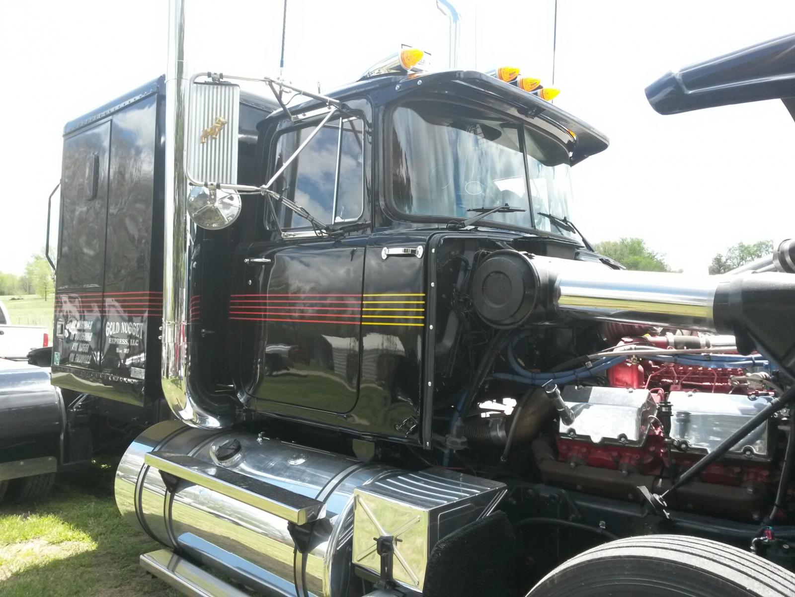

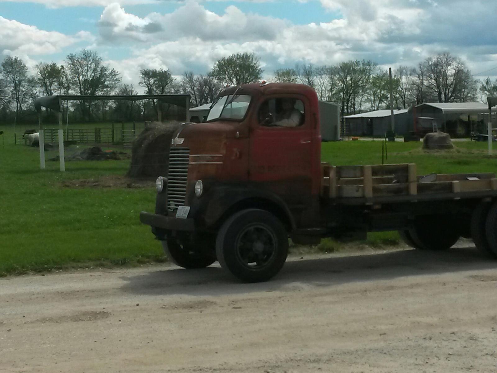

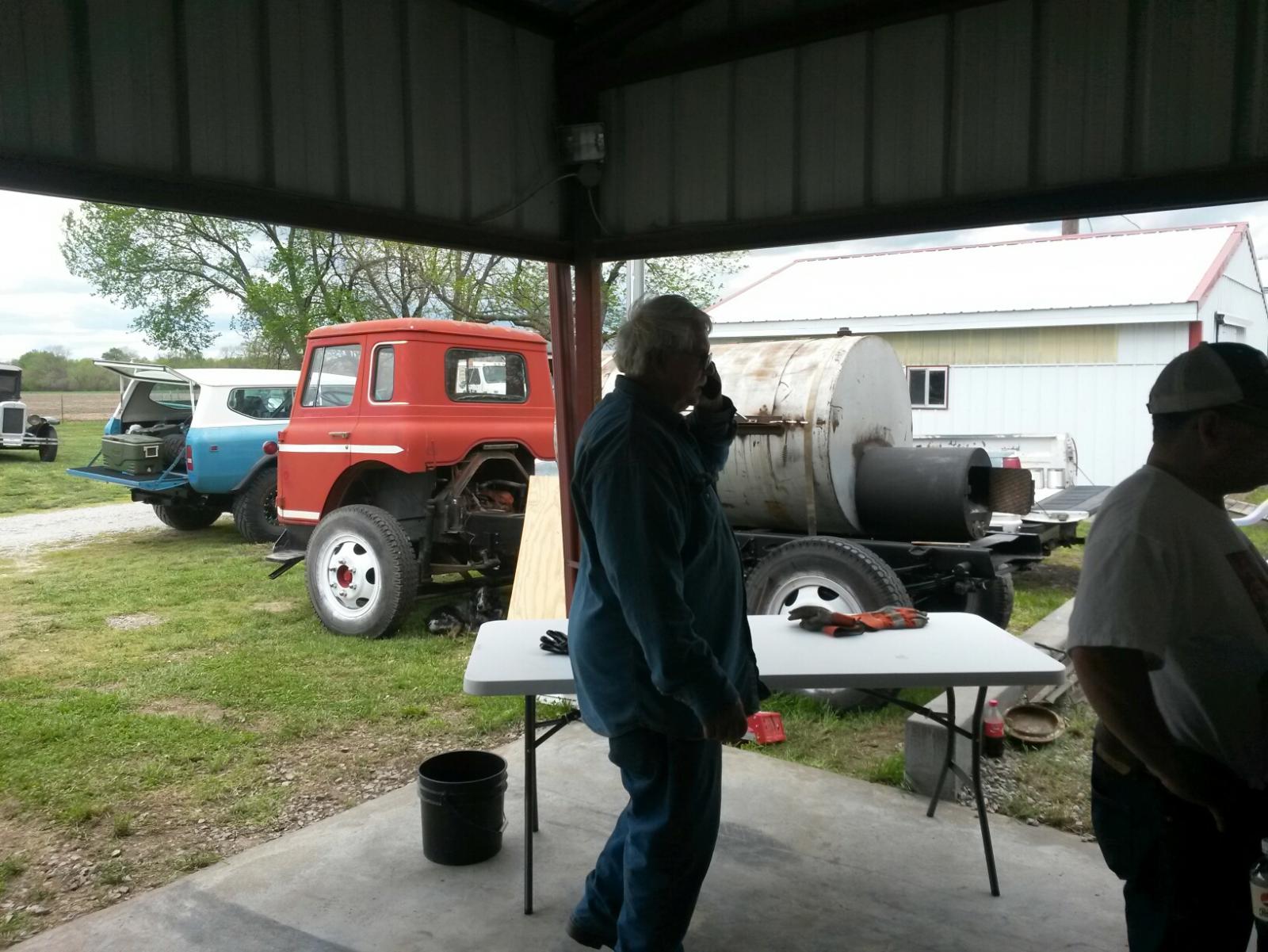

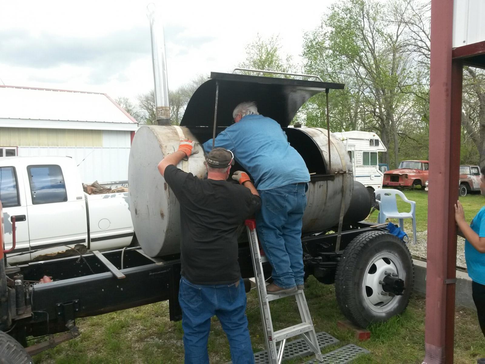

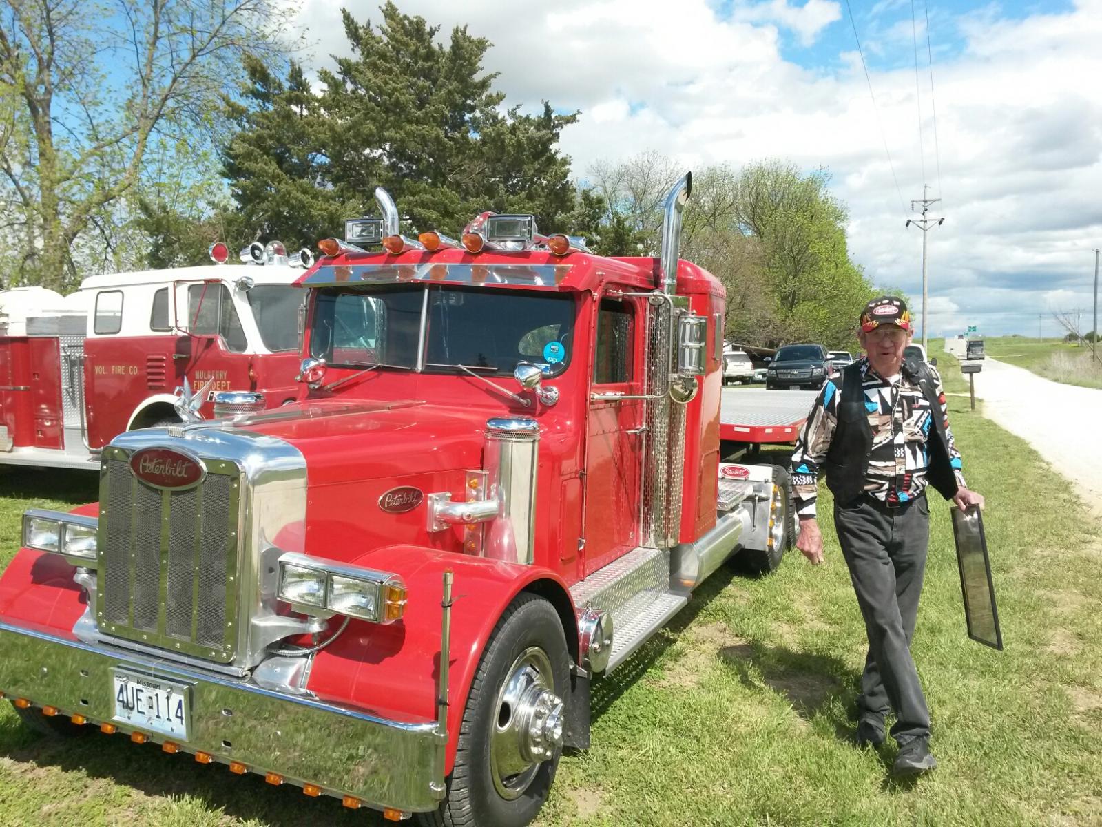

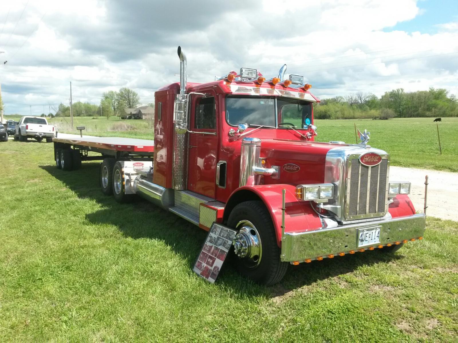

Went to the annual Hog Roast at Dan Agees IH Museum in Milo, Missouri kicking off a new show season. Folks from The ATHS Three Trails, Ozark 4 State, Chevy Club Of KC and the International Harvester Club were in attendance as well as the ATHS National President . As always great turn out and some notable rides. There were plenty of IH trucks, Fire engines and a few others like this Mack ( seen in the ATHS Wheels of Time last year.) A Custom Pete Old Dodge repowered with a cummins Some hog and burger action
