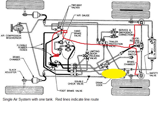

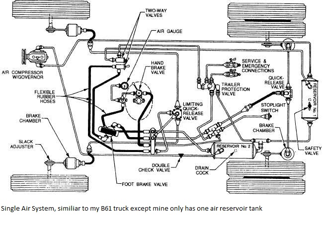

  3. Retrofit Mack B61T Park Brake System. I own a 1959 B61T Single Axle Tractor, this thread will document my process of retrofitting the rear axle to “Spring Brake” brake chambers. My truck has a single air system with only one air reservoir tank. I will not discuss air brake theory unless it is important to the retrofit. Disclaimer- Use of this information is at your own RISK and PERIL. Obviously there is a risk of accident, incident and injury this thread is not intended to be the “end all/be all” or an all-inclusive description on retrofitting the brake / parking brake system on an antique truck or other air brake system. All information that I provide is described to the best of my ability and may contain errors or omissions that could result in an accident, incident, injury or death. There is no guarantee of the validity of the information found here or guarantees about the accuracy, completeness, or adequacy of the content of what is written or posted. Use of information is at your own risk and peril. Mechanical Ability and Skill General mechanical understanding of air brake system and general mechanical expertise is required. Common and basic safety considerations and installation processes must be followed. Such as the use of chock blocks, safety glasses, disconnecting of battery and consideration of pressurized air brake system. If you do not have the required general mechanical understanding of an air brake system, general mechanical expertise that is required, doubt your skills or just prefer to have someone else perform the work, check with a qualified shop and certified mechanic to have the retrofit done. Parts There are numerous truck part vendors’ that are available for sourcing the required parts both locally and online. In my location it is easier for me to order online. Whatever your source for parts, confirm that the parts are DOT certified for the application they are to be utilized in. Parts List 1. "Spring" or "Maxi-Brake" rear brake chambers – two (one for each side) WARNING: NEVER interchange 3.0" (76 mm) stroke actuator components with 2.25" (57 mm) or 2.5" (64 mm) stroke components. WARNING: NEVER interchange spring brake manufacturer’s components, although spring brake manufacturers components look similar performance and stroke may be seriously affected which could result in Injury or Death. +++Before ordering determine the length of stroke of current brake chamber 2. Tee Fitting- two (one front air supply and one for rear air split) one to be mounted under dash one near the rear cross-member, ahead of the rear axle. 3. Rubber Air Lines- two (one for each side) from the tee to the rear brake chambers, Inspect the existing air/lines hoses as now would be a good time to replace if needed. 4. Air line from Tee Fitting to interior cab position at least 3/8” also Air line from valve to air source. 5. Air valve –Push/Pull 6. Misc fittings as required Next Order Parts and Wait
  4. Good Morning All, I am currently convalescing from a service connected surgery and since I have a little bit of time on my hands and my wife’s laptop I was hoping to research what is required to change over the brake pods. Develop a list of parts and a straight forward thread that documents the process for the future. I am no expert on Mack B61s brake systems but I am an ASE certified Medium/ Heavy Truck. Years ago hearing about converting a single air system over to springbrakes without adding a secondary system. If anyone has done a similar upgrade or familiar with the process I would appreciate comments, pictures, parts used. Thanks
