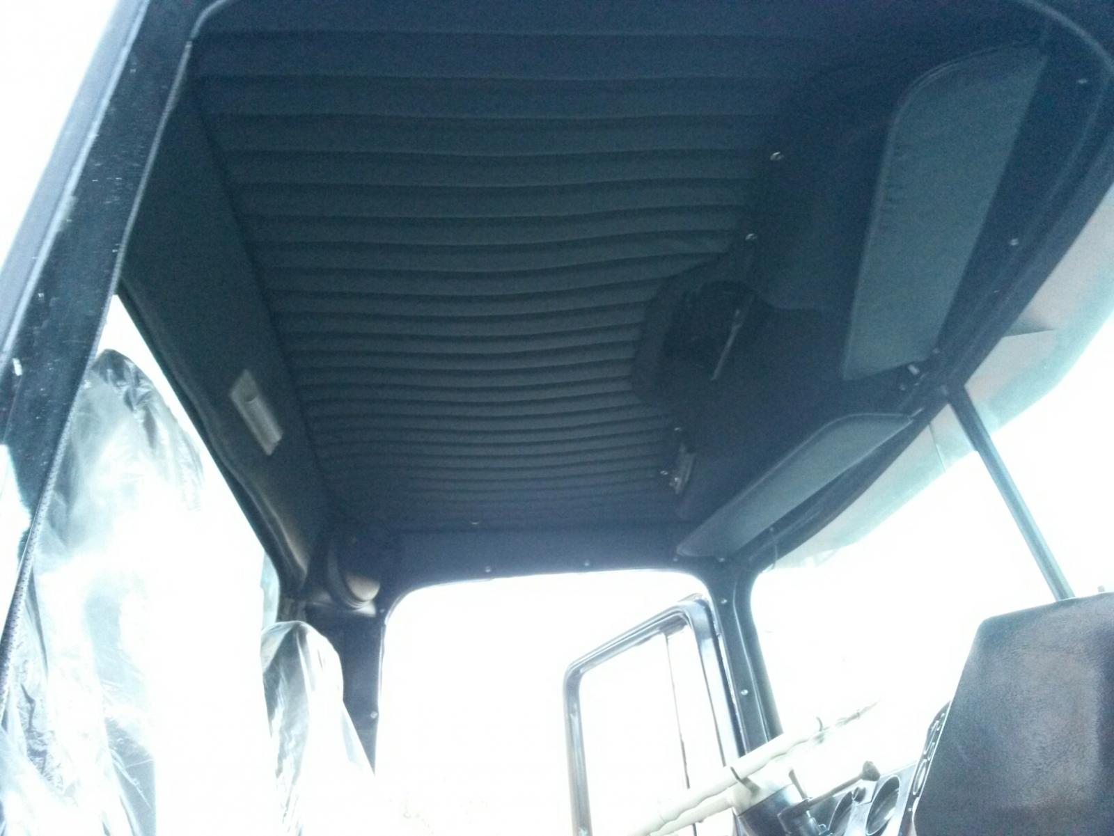

R model cab speakers
thomastractorsvc replied to dozerman1's topic in Exterior, Cab, Accessories and Detailing
Post a picture of your the headliner. The way they mount in the corner is a series of folds that boxes out the corner and the speaker mounts on a flat portion so they set vertically in the corner. Open up this picture and zoom in and you can see the round speaker and the folds in the headliner. -
The interior looks really good. I noticed the carpet was in good shape to, was that a replacement or swapped out? Did you was down the inside walls after you took the panels out and add some insulation?

Are they cab corners or over the door if tell are over the. Door my R had 4 inch rectangular speakers and I think my superliner ones are just 6 inch round they mount in the headliner on both -
An upholstery guy in town I am trying to learn the custom stuff but f'up most of it. I buy the material and jack around with it till I am frustrated. Then take it to him,10 minute's later he is all done. He cut new card board for the headliner, I did the plastic console after fixing cracks and reinforcement, I used the black cloth headliner material it looks good except were it got to close to the heat gun but it is by a screw and you can't see it. He charged me $100 per door and $150 to do the headliner and $70 for the other pillars and over the door he made new cardboard pieces. I supplied all the fabric. I have learned enough I plan on doing the sleeper.
