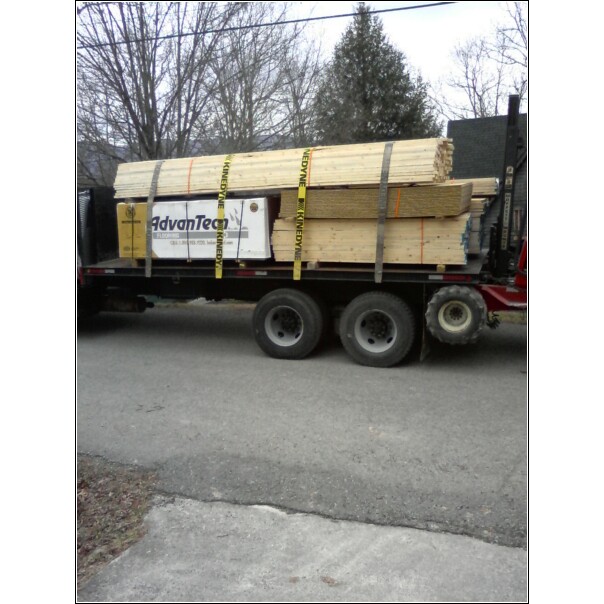

MACKS, when I first read your post, i was kinda shocked, but figured you are allowed to have your own opinion. I realize that turning up any motor for more power can possibly reduce its life expectancy. I'll explain to you how it is: It is in an '81 Mack econodyne (is what it says on the side of the hood). The truck is set up to carry the roll off boxes like waste management uses. Empty weight of the truck is almost 31k. Empty on the highway the truck can't even hold its speed up hardly any hills. What sucks is that the way it is geared, the truck is in high gear and maxed out on rpm's and can hardly hit 55-58 mph according to my GPS at which the trucks speedo is reading 63 which is definately wrong. Now if i get about 20k in the box and then i'm around 51k or so, it really slows it down, that 237 has what, 220-225 hp or something like that. Just on the interstate here on I-35 in southern iowa and at that weight there are hills that I hit the bottom maxed out at around 55 and when I get to the top then i will be anywhere from 30-42 mph and if it gets below 30 then I gotta downshift a gear because its really luggin the engine. It won't go above 30 mph in 4th gear on the high side. This thing must be geared for low speed around town driving/hauling. But I have roughly figured that it gets around 6-6.25 mpg which doesnt sound that bad. I figured if i can get even 20 or 30 more horsepower easily, that might help a bit on the highway. I don't want another 100 horsepower which would not be easy or cheap. Thanks for any help guys. I love this site.
If you think that things underpowered you would die driving a 3126 Cat cause they absolutely suck. The truck I drive is a '94 chevrolet 6500 w/a 8LL, and i so underpowered that it gets down right ridiculous. It has a Moffett Mounty lift on the back of it so thats a extra 4000 pounds which dont really help at all. The first pic is just to show you the truck, the second pic is a load i took to a marina we deliver to frequently. On one hill I skipped 2 gears the first downshift and dropped 2 more gears puttin me into second gear before i reached the top. That's at a 45 mph run at the hill. I'd love to have a R-model with a 237 or 300 just toget away from that damn 3126. A least the mack has the torgue behind it.

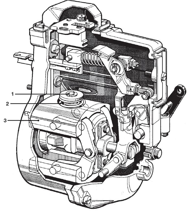

I have the robert bosch on all my #$it trucks. But they all have the Smoke control built into the top of the pump..... If you remove that "cover" in the rear top of the pump, then remove the "rack limiter" now get a flashlight and look into the pump straight down. you may have to turn the engine over to see what is nessecary to turn up RPM's it is a funny shaped spring holder about the size of a dime with 2 dimples in it... you push the spring down and turn in the "spring holder" clockwise, may be a 1/2 turn or more. The spring pushes against this nut thingy and holds it in place. remember how many clicks because you have to turn the motor over and do it again on the other side of the Governor flyweights (inside the pump).
I'm attaching an awesome picture of the inside of the governor housing as viewed from the engine side of the pump (physically impossible to do).. the "nut thingy" I'm refering to is item 1 in the picture.
MAXVILLE's DISCLAIMER-------That is not the right way to turn rpm's up, the proper way is to take the cover of on the engine side of the pump and remove the springs and put the right springs in for the required RPM, also it should really be done on a test stand by a trusted Pump Shop. In my area both Lacrosse Diesel and Eau Claire Diesel are good at it.. When you turn rpm's up you also increase your HP a little too, doing my method will make your throttle more sensitive and if you do not get it precisely the same on both sides your governor may act "weird"
