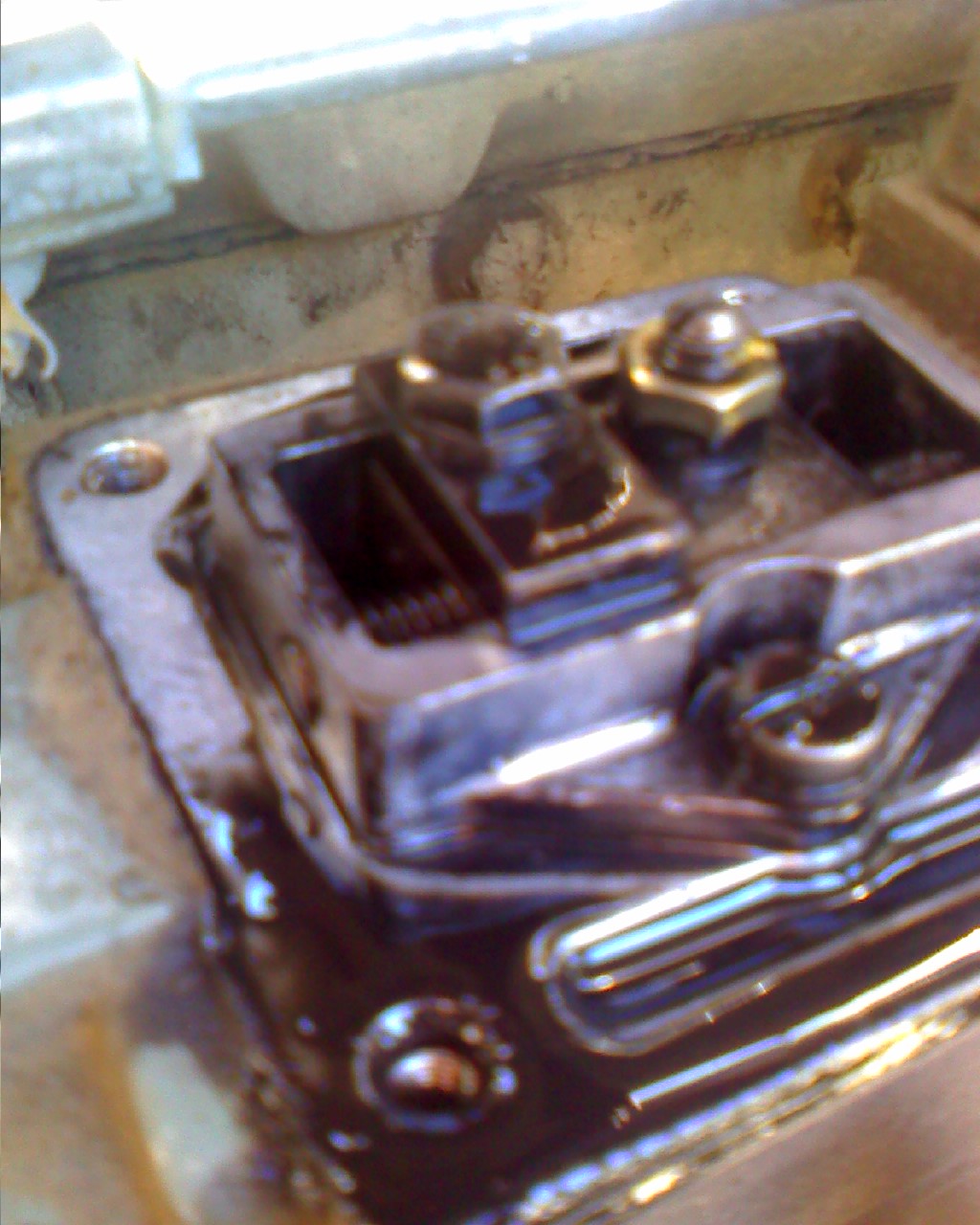

Alright guys, I finally got around to using a chisel and hammer to get that special screw out so that I could finish getting the cover off and then i find out that it doesn't look like what was being explained. I'll post the pic on here that I took. It looks like there are a couple bolts that are attached to a long adjusting screw from the back that you can see in the image. It has 2 screws that hold the whole assembly down, but it doesn't look like it can slide without hitting the gasket for the cover. I was afraid to move anything after seeing what it looked like. What do you all think? Thanks in advance!!post-2666-021188100 1275861269_thumb.jpg
Try loosening the bolt on top turn the screw on the( end one) turn tighten the bolt and try it! ( Note )I beleive ya turn that one counter clock wise to increase!You can always put it back where it was if you don't get the results your after!
