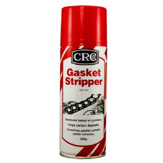

On the topic of gaskets anyone tried carbide scrapers for gasket removal? I've got an aluminum head that is being stubborn.
Edited by BOBWhite
https://www.bigmacktrucks.com/topic/75768-300-rebuild/page/9/#findComment-584217
I used to get this stuff at grangers that you sprayed on a gasket, and it loosened it up so scraping it off was a lot easier cleaning the gaskets off cat aluminum oil pans were time consuming and the spacer plates also. I made real good gasket scrapers from the blades off the power hacksaw
https://www.bigmacktrucks.com/topic/75768-300-rebuild/page/9/#findComment-584218
I have some solvent that eats gaskets and sealers.  Get it from my local engine shop.  They use it exclusively.  Just melts crap away.  Can't recall name, have to look when I get home.  I thought it was Malco products?
I did use a carbide scraper on the gasket.  I have a razor blade holder but it always gets jammed up.  Just have to be careful with carbide as you don't want to gouge the surface if you get a little ever zealous.
