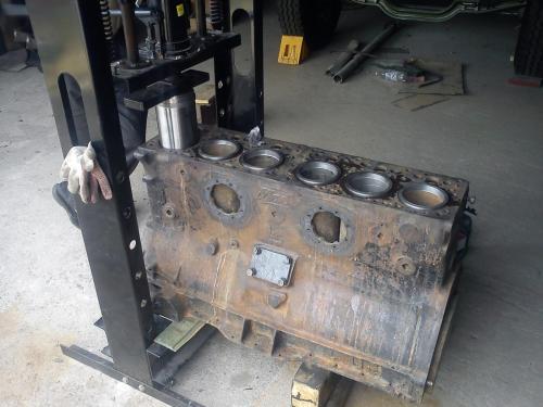

Now if you cast your memories back a week or so and Vlad shared a link to his Lanova motor getting rebuilt
The whole block went in the normal smallish shop press to press sleeves
Can this motor be flipped over amd just press the sleeves/liners out
Me thinks so
Paul
