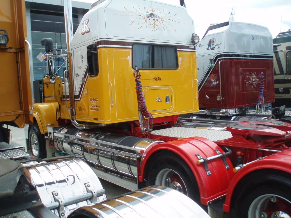

Hi all. Question to put out there. The auzzie Mack’s that had areodyne bunks on them how was the bunk mates to the cab. With a sub frame then put on air? Or was it just hard mount?  Looking at the pictures of them and looking for some advice  before I mate mine.
https://www.bigmacktrucks.com/topic/75637-areodyne-bunk-install-on-86-superliner/

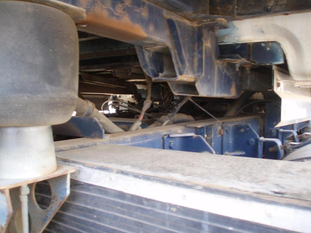

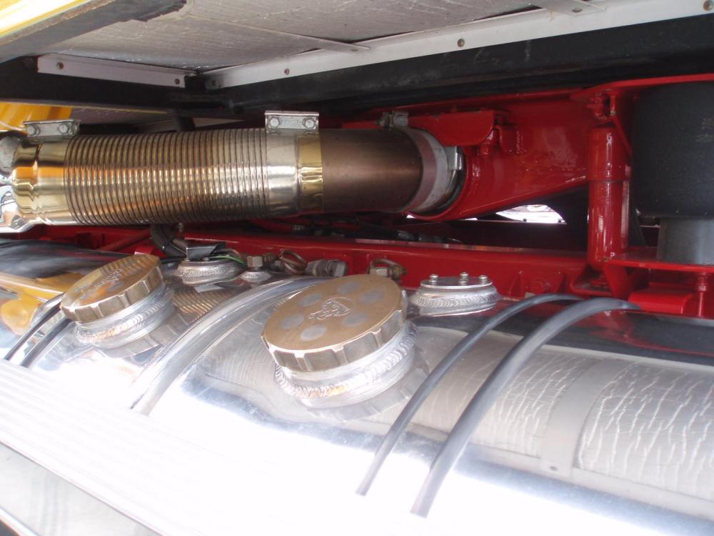

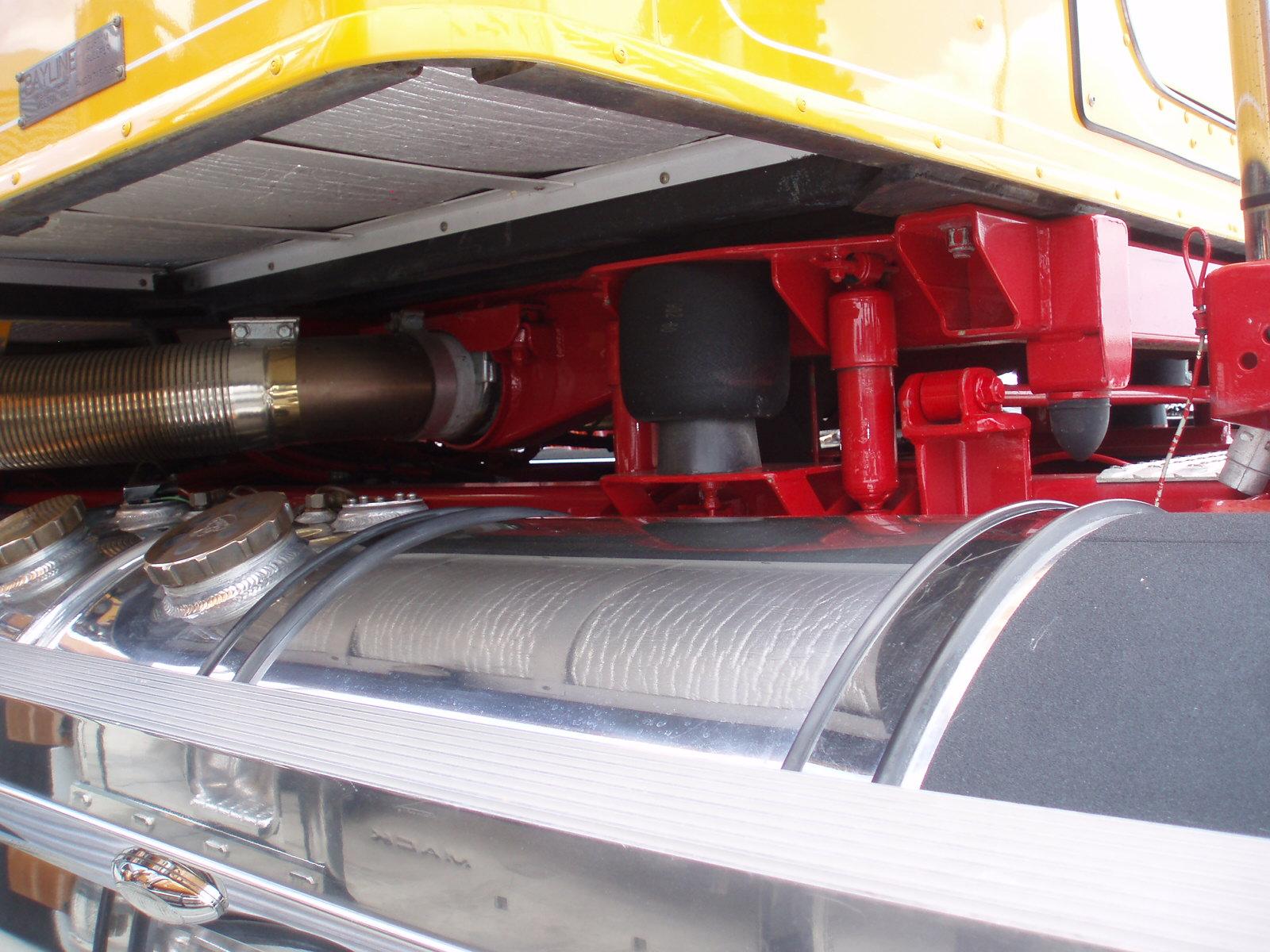

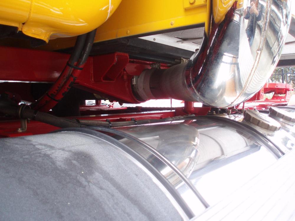

Almost all air ride cab Macks I have seen mount the cab and bunk on a frame
Two air bags at the rear, one each side of the chassis
The whole shootmatch moves as one
Don't think they all came from the factory like that, but with the usual rebuilds over the years and improvements most were modified as mentioned
