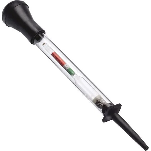

But to stop a battery failing in the future the batteries need to be monitored for charge as regularly as checking your oil and water
A hydrometer can be used once a week
There are other methods but this is quick and simple and accurate way to monitor the batteries
