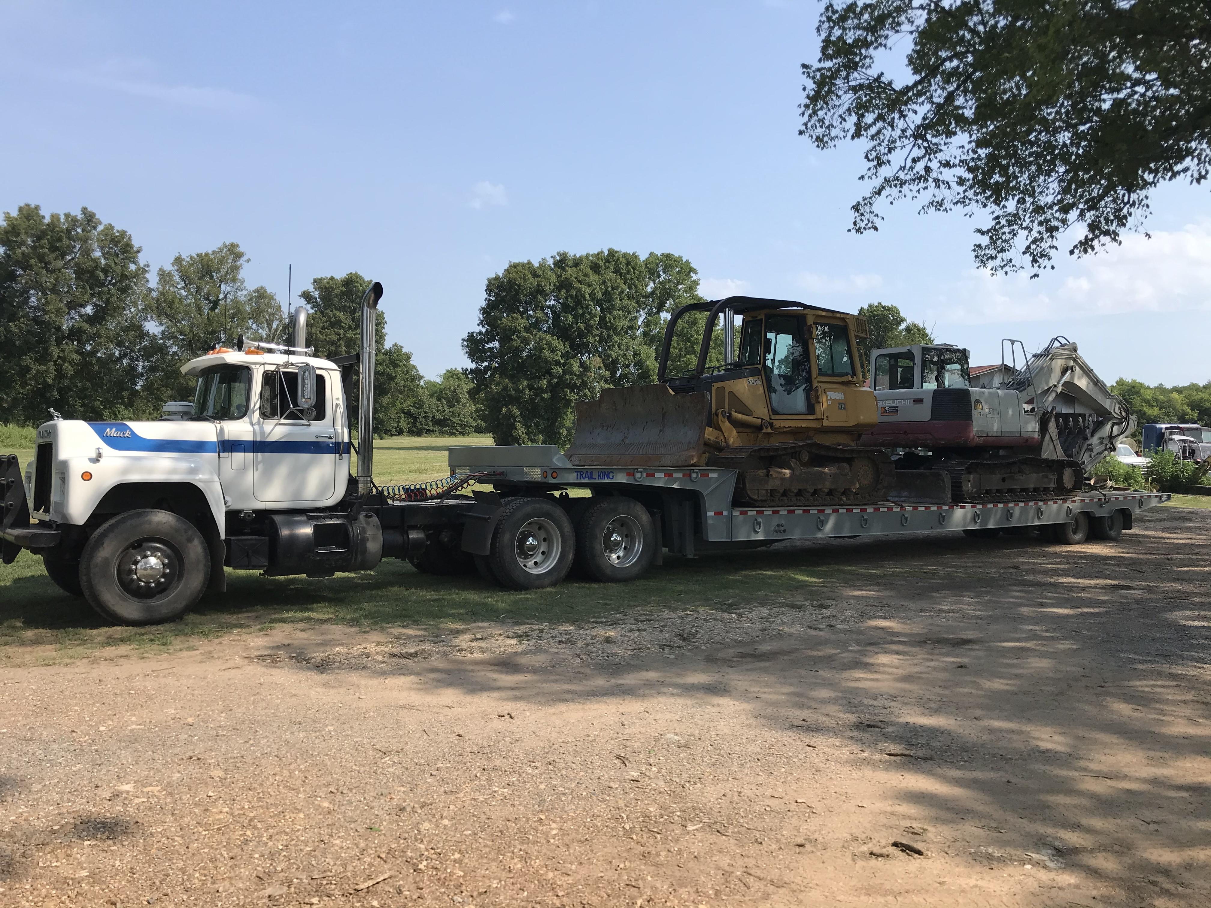

Awesome information thanks so much to all of you. Yes Joe it’s single frame and all budd wheels. 38 camelbacks and I’ve got a bottom leaf broken and all the bushings need replaced too. So I’ve got some decisions to make concerning this old thing. I put a cab and hood on it a few years ago and painted it. Swapped the old 2 stick 6 for an Eaton 9LL and built air ride for the cab. All new interior and insulation. A/C and stereo and the works. Got lots of information here from all these good folks on this site at that time too010889F4-3090-452B-A5E4-05B825CE2030.thumb.jpeg.60729d654663838469a6354b71815ac7.jpeg
