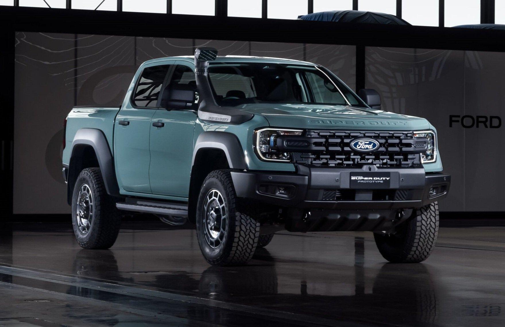

I bought Ford Ranger a while ago, 12 months or more, shouldn't have as I hardly drive it, but it does go well
Dunno if the Ranger is in the states or not, Ford Australia is bringing out the Super Duty Ranger, 8 stud wheels 4.5 ton towing capacity, skid plates to the back of the transmission, snorkle and all the tough stuff
Thinking maybe I should but probably won't

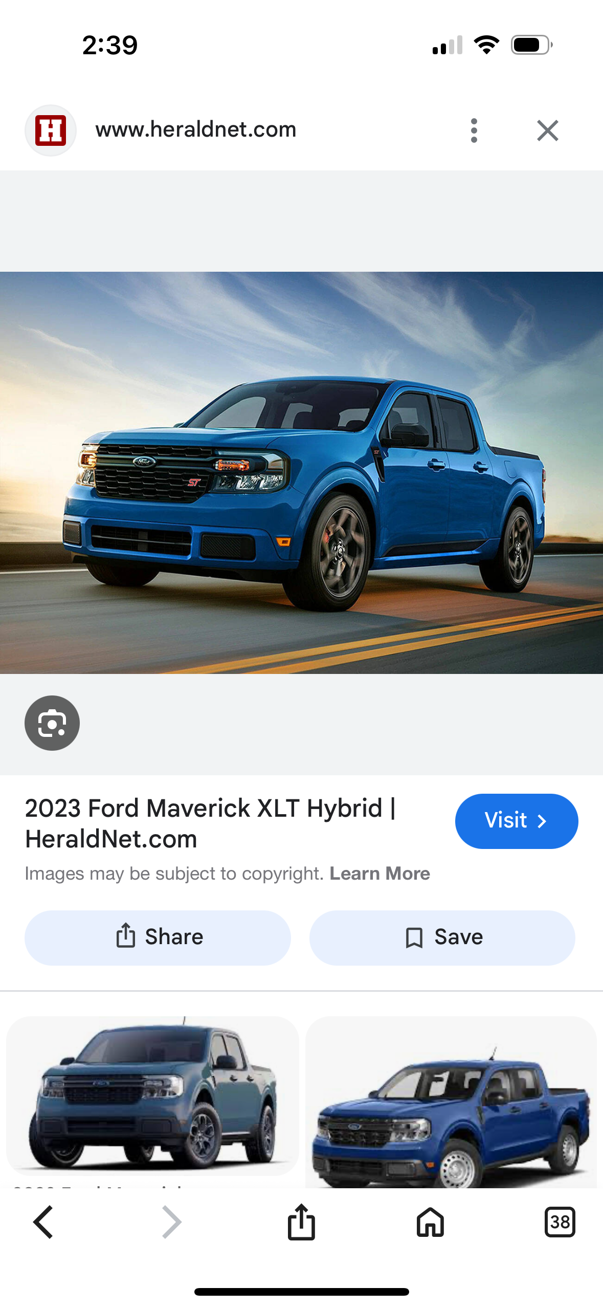

That looks like our new ford maverick pickup I suggested that but the old lady is all hot and heavy over a brand new pick up full size. We really like our 2006. It’s a four-door 6 foot bed but it’s tired and old and it has electrical issues I’m kind of hoping I could get a pretty good price for it. It’s been a pretty good dependable truck. I hate to give it away. I’d rather just sell the Mustang and fix the pick up and continue driving it. I have to keep it plugged now, slow trickle charger. I had it diagnosed the shop, said I had issues with the heater switches and the gauge cluster both drawing juice.
