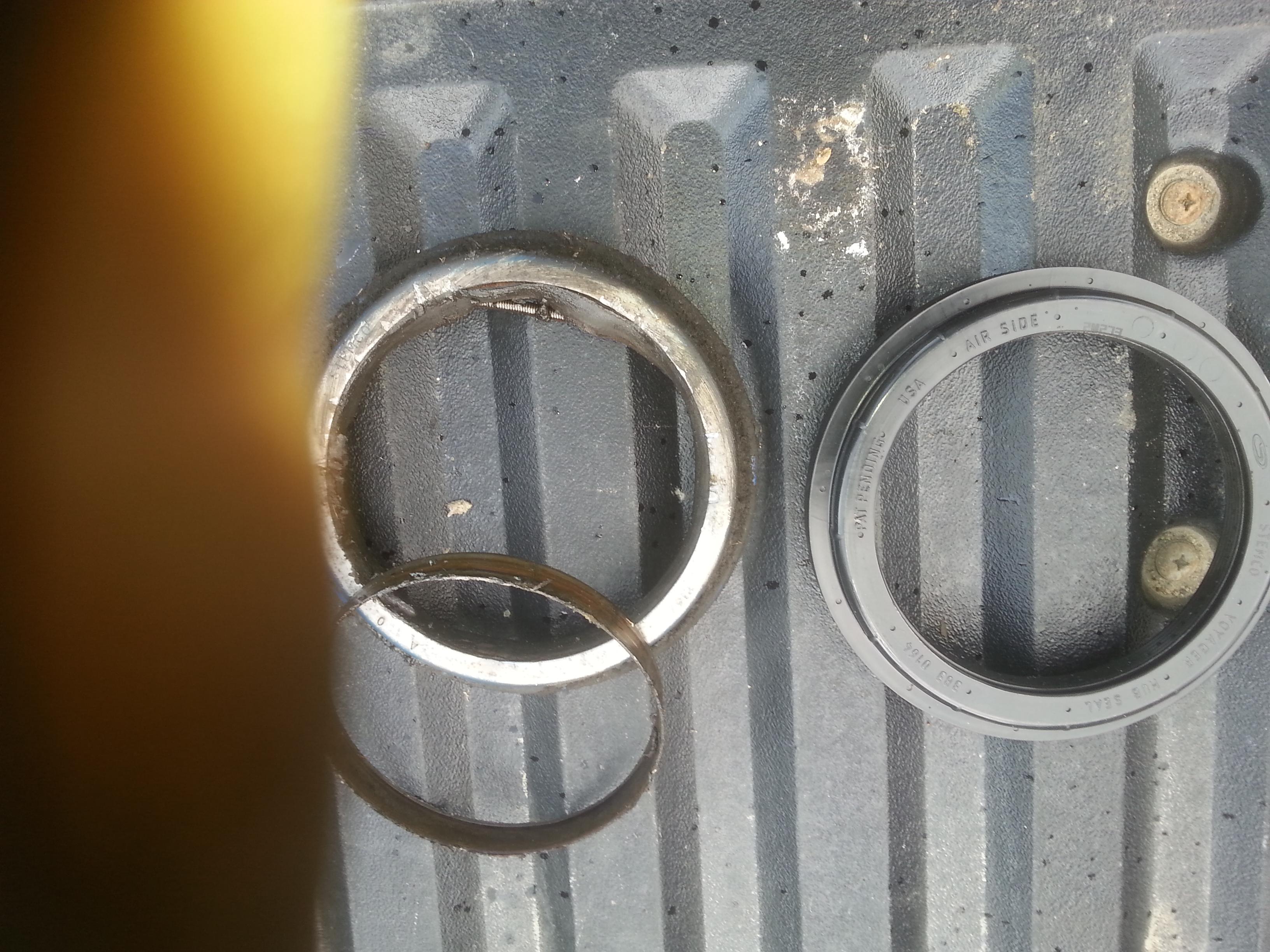

can you clean the old seal and post a picture of it and the seal number???  If I can get info I will post it for you..  Hell, i'll buy the seals and send them to you..
4 hours ago, Joey Mack said:
do you mean the steer axle???   What year model?  If it's the steer axle, there is a dowel pin hole in the spindle to secure the inner wear ring..  no biggie, just see if it's there.  jojo
challenge with the steer axle seal is the "wear ring with dowel pin" looks to be part of the spindle . there is also an  o-ring inside that wear ring. don't recall the need to change the o-ring,    old school seals are taxing the brain cells again;;isn't the steer axle seal a 20?? number series. can picture the seal not the number.
Yes, I'll take some pics.   The Stemco number is 320-2137, crosses to a Voyager 383-0164.   I did manage to find some early seals at Finditparts online and ordered them for on the shelf for later.  But the Voyagers are the only thing I can get here locally at any of the jobbers
Stemco 2 piece vs Voyager.  The voyager went in nice and smooth and seemed to fit well.   Running Lucas Hub oil.  Will see how it lasts.
Edited by Full Floater

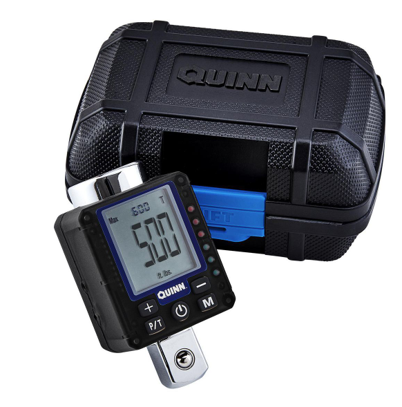

Also a tip for anyone doing this type of job in a more or less shadetree scenario. Get a 3/4" drive digital torque adapter from Harbor Freight. I debated laying down some serious coin for an average quality 3/4" torque wrench that would go to 350+ ft*lb then I found this handy device for $70. You can basically turn any breaker bar into a precision torque wrench. Everyone has a 1/2" breaker bar laying around. Just get this tool and a 1/2 to 3/4 adapter and you are good to go. I have a 3/4" breaker bar and a long piece of 1" EMT conduit slides nicely over the handle for extra leverage. I was a little reluctant but I found many positive reviews on it that were not on Harbor Freight's website. It's also made in Taiwan not China so the quality and precision is good.
https://www.harborfreight.com/34-in-drive-150-750-ft-lb-digital-torque-adapter-58707.html
