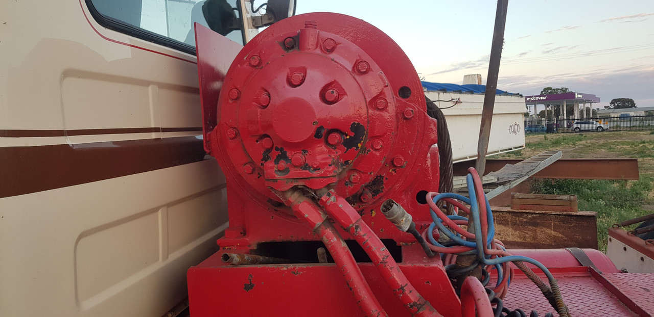

4  0f our trucks have a Garwood 4MB Winch mounted BHind the cab
they all have a 3/4" cable that we able to break @ idle revs with a mechanical drive thru chain & Sprokets
they all set up with a PTO that has UP - Nuetral - Down  control
Cya
Edited by Swishy
I installed a Garwood winch, the same model as Swishy's, on my B61. My transmission is a Quadruplex and I used a PTO with forward and reverse to drive the winch. An extra gear was needed to reach in to the pto drive gear in the transmission.  The pto drives two # 80 chains to the winch. It could have been a fairly easy job, but I got carried away and made the whole thing more complicated than it needed to be.  One of the things I didn't like was that the pto shifter, if mounted straight up through the floor, would have been right where a passenger's leg would be. I spent quite a few evenings making linkages to move that pto shifter over next to the 5-speed stick. I have not yet run the truck; it is still a work in progress.  Steve
