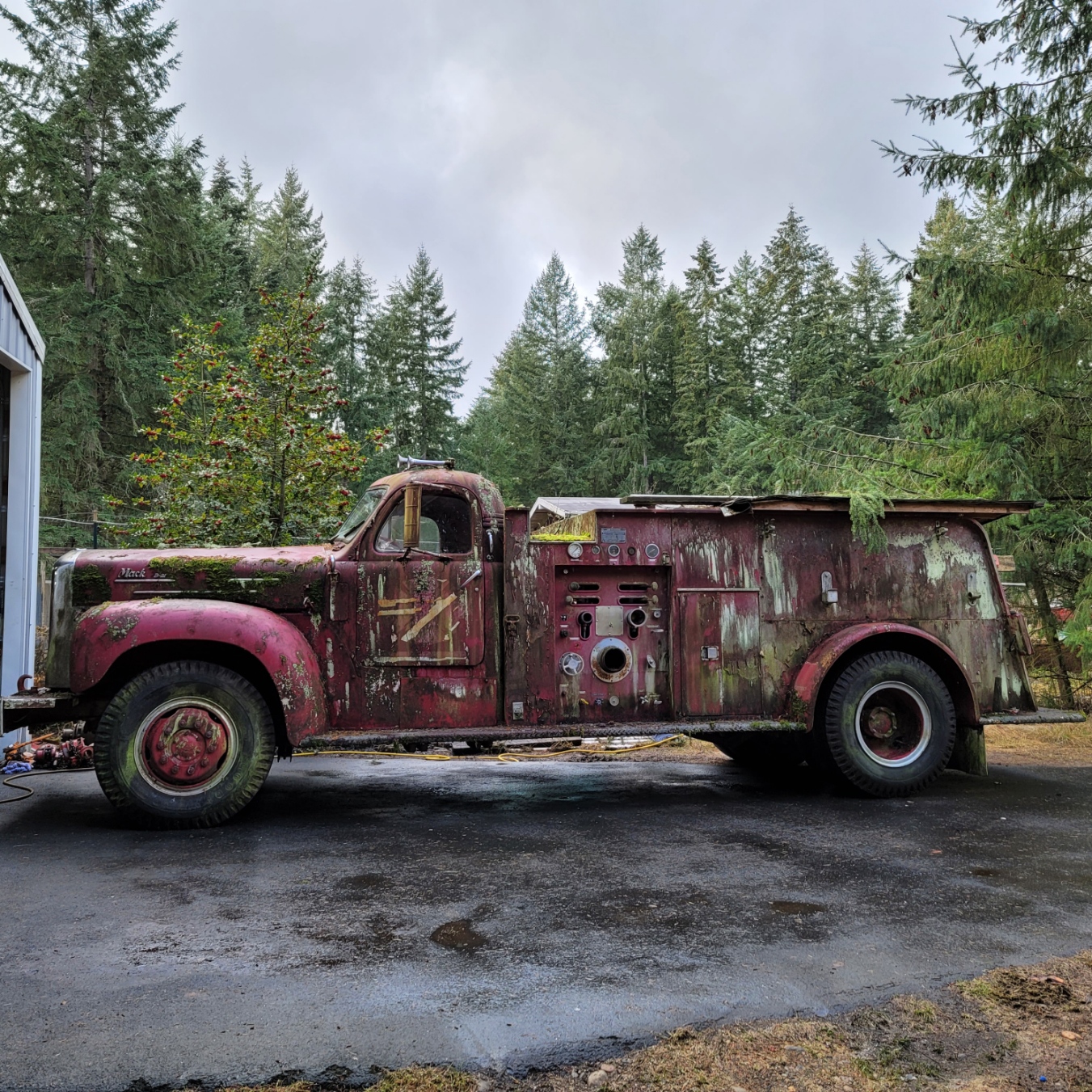

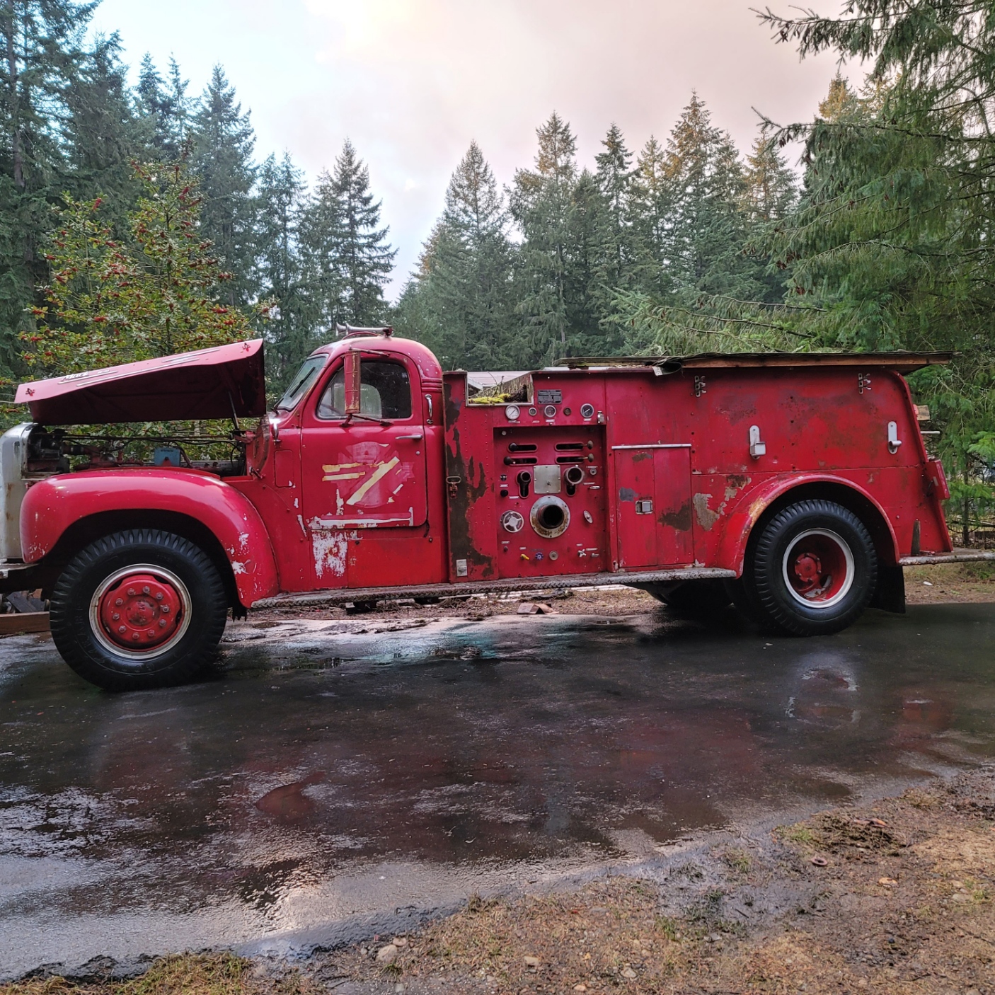

engine turns over but the starter is not engaging, so I get to start there with this one.

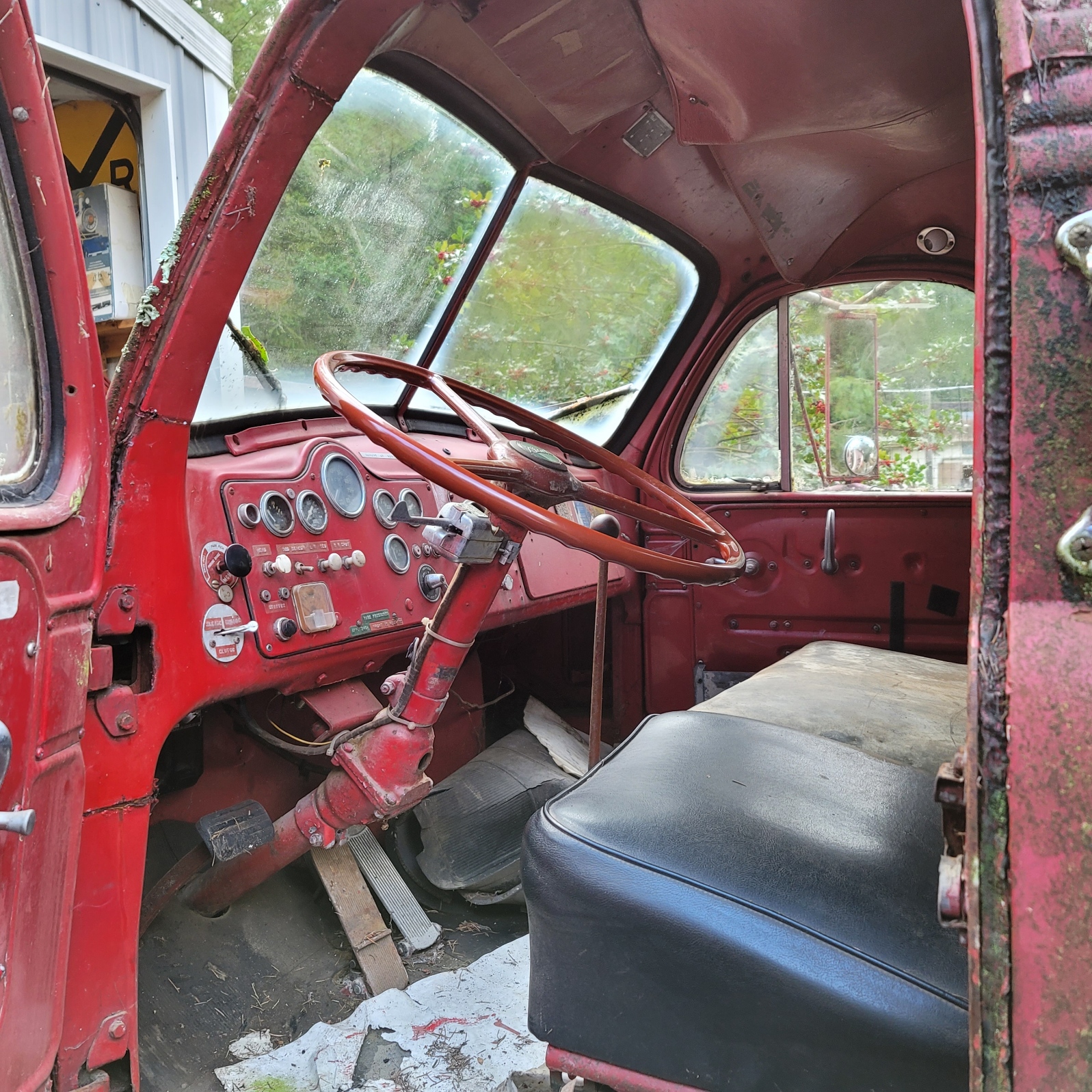

Found a bunch of new / rebuilt / spare parts for this under the seat, great treasure hunt lol.

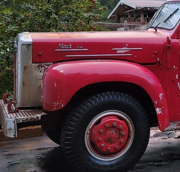

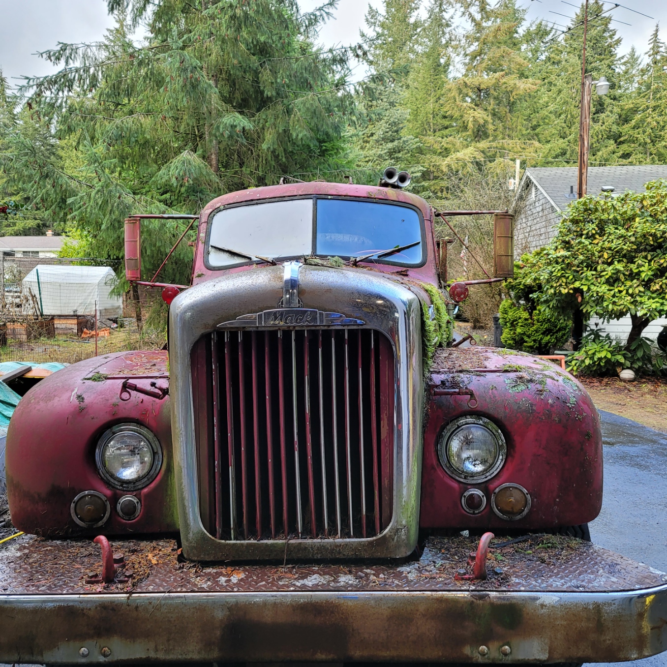

Also discovered that the Mack Dogs for the sides of the hood are much larger that the standard B model Mack dogs?
I found a new old stock set of hood "Dogs" for a model B,  but they are way to small to fit the hood.  Does anyone know where I can find the correct emblems?  Are they specific to the B-21 or did they come on other trucks as well?  I would guess that they are about 2" bigger then the ones I received.

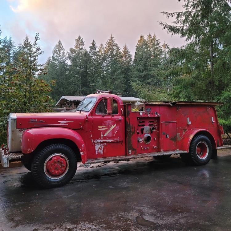

Well number two is also up and running, although after about two minutes of running I blew a oil line.  My son did take a "startup video" of it and when he gets it finished I will post it.
Ran beautiful and smooth once it got fuel.
Anyone know which Dog emblem I need to buy to fit the hood?  I purchased some B-Model dog emblems for the hood but they are too small and angled up, the hood outline of the Dogs are standing flat and about 2" bigger.

On 1/6/2023 at 4:57 PM, Draggin Wagon said:
Wonder why they have a u-joint half way down steering column? Guess steering box is mounted further forward than B20 thru B60s?
Hell I didn’t even notice that I was too busy pissing myself over that perfect looking steering wheel lol bob

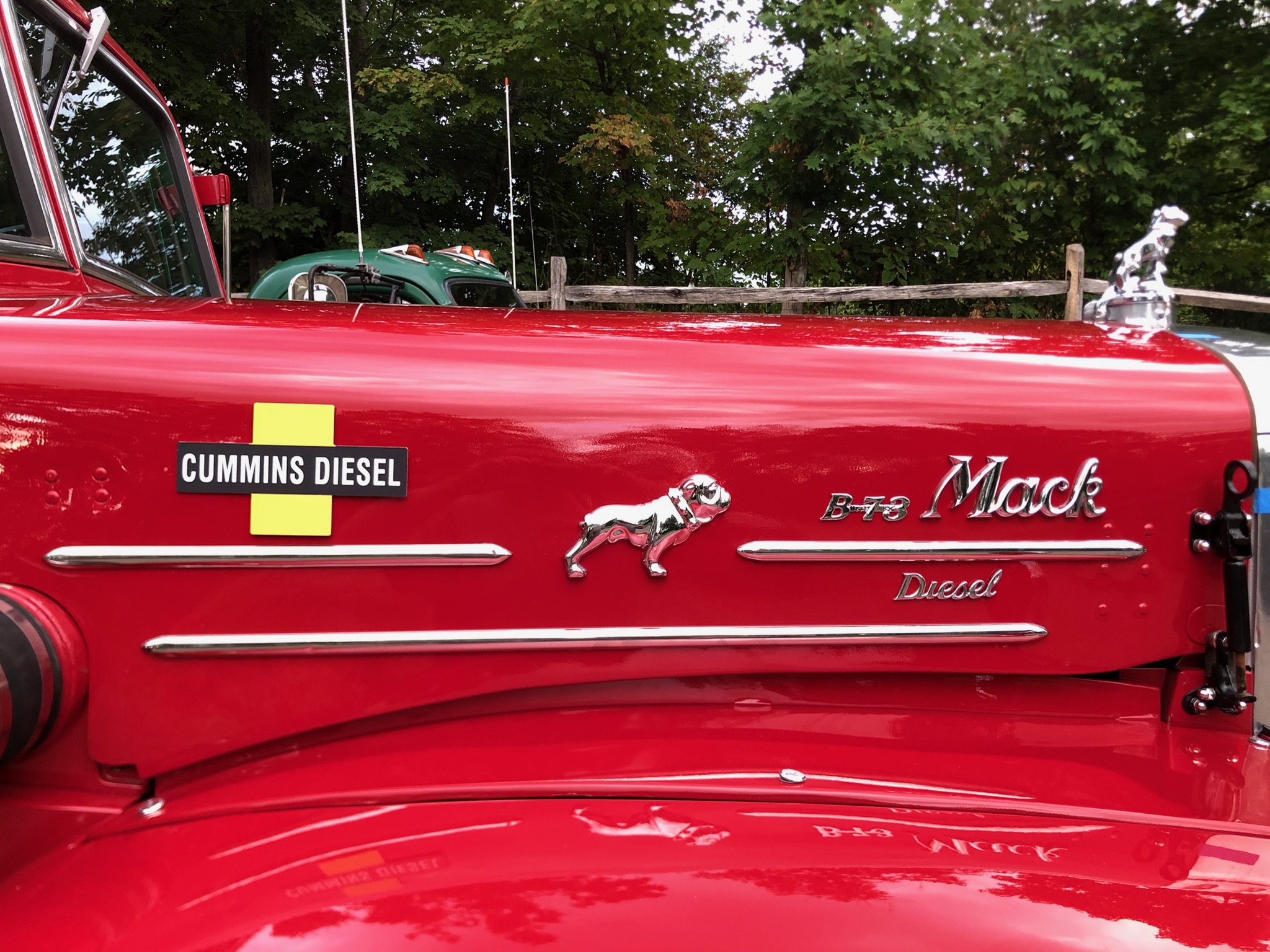

I never realized that they did both the fender extensions and the extended radiator shell to fit that huge Hall-Scott in there. I always thought it was just the radiator shell, but I've never seen one in person or close ups pics of one. Kind've like using B73/75 and B71 parts to fit it in there. I know a Cummins is 6" longer than a Mack engine, so maybe the Hall-Scott is about 12" longer?
Hall Scott is pretty big (one of that model anyway)  I've only ever saw one in real life.  It was big ,  sorta like big bore Cat in some respects.  An impressive looking engine somewhat like it was ahead of it's time or something.  I bet as far as length , an E7 would fit where the Hall Scott would.
