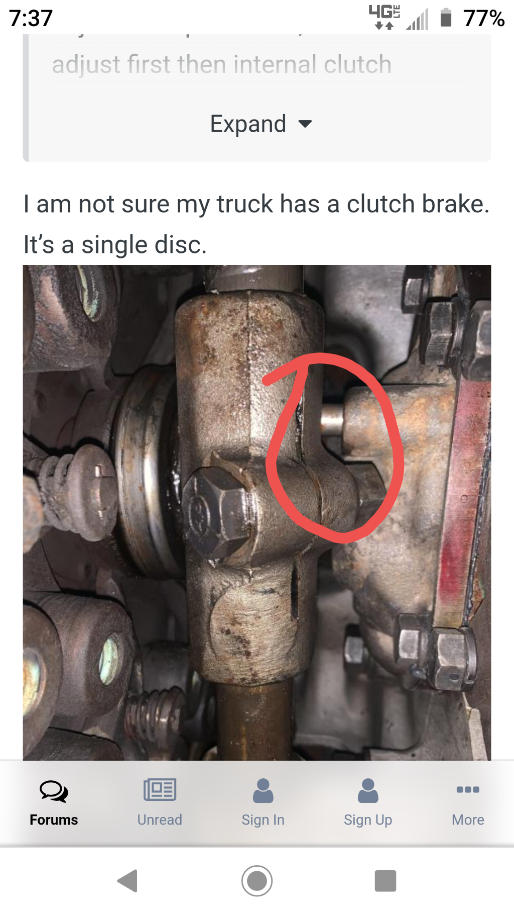

if you have to wait  20 +- seconds before trans will go into gear without grinding; i would look at the possibility  the clutch brake ( if a single disc  has one) isn't working. looking up from bottom on trans bellhousing through the 3x4  opening, the pilot shaft might have a 3 piece tiny clutch assembly known as a clutch brake. later versions were a one piece unit.  a 3 piece consist  of two fiber disc and one center steel plate. the steel plate  usually shears off the two tabs connecting it to pilot shaft. on the bottom of trans  bell housing is there an adjustable (3/4or 7/8???threaded stud sticking out????
older Macks the clutch was adjusted using exterior linkage/ clutch brake internal adjustment. the spicer clutch in most Macks just the opposite adjustment procedure; brake exterior adjust first then internal clutch adjust. you do not have a spicer clutch. If the clutch is working proper under load ,just doesn't allow for going into gear ; i would check the clutch brake adjustment in bell housing. loosen lock nut , turn out threaded bolt ONLY a little does alot.
I am not sure my truck has a clutch brake. It’s a single disc. 17DD4204-4556-49D1-A235-AE2E2D09B806.thumb.jpeg.5b32e950a6def3d1ec2057599bd01ad0.jpeg
