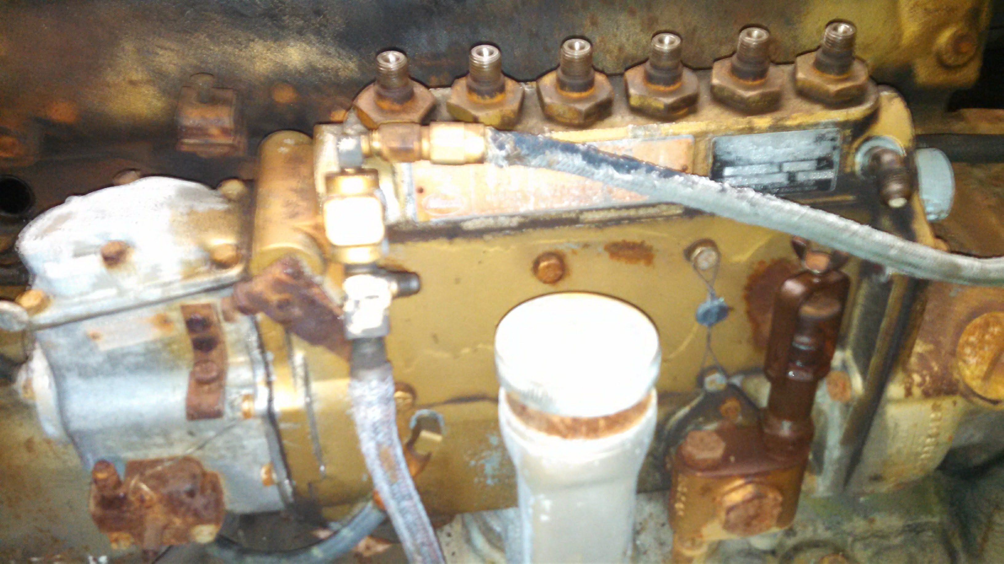

with the fuel filters fuel of CLEAN fuel; remove cap on fuel tank  air hose and rag in filler; with LOW air pressure ;pressurize the tank. have two tanks use the one that does NOT have the return hose. one tank have to  disconnect return hose ,cap the line to tank (use vise grip pliers). fuel shut off  in run position.sometimes pedal down  and this is done with the engine OFF> many times the hand pump is more of a hassle. have seen the lock screw loosen and primer is bouncing up and down with fuel leaking . it was helpful back then to keep a couple hand primers in the toolbox  for those road calls . doesnt do much good now though.
24 minutes ago, skydawg said:
So the plunger just threads into the pump,no other parts?
Should be two nuts on top of lift pump, with plastic check valves under them, be sure to put the primer on the one that draws from the tank.   terry:MackLogo:
Incidentally, I bought some off-brand primer to put in the R once, because the original was leaking. The new one worked, but I never could get it to seal in the housing. Leaked around the threads.
Bought a set of seals from a pump shop in Knoxville and rebuilt the factory piece. Worked fine from then on.
