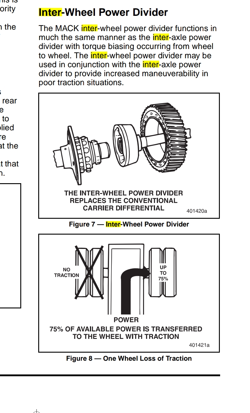

I'm not sure that mack rear ends had "full lockers".they did have interwheel locking differentials which I believe uses cams just like the interaxle power divider.But I think they are pretty rare and parts would be hard to source..

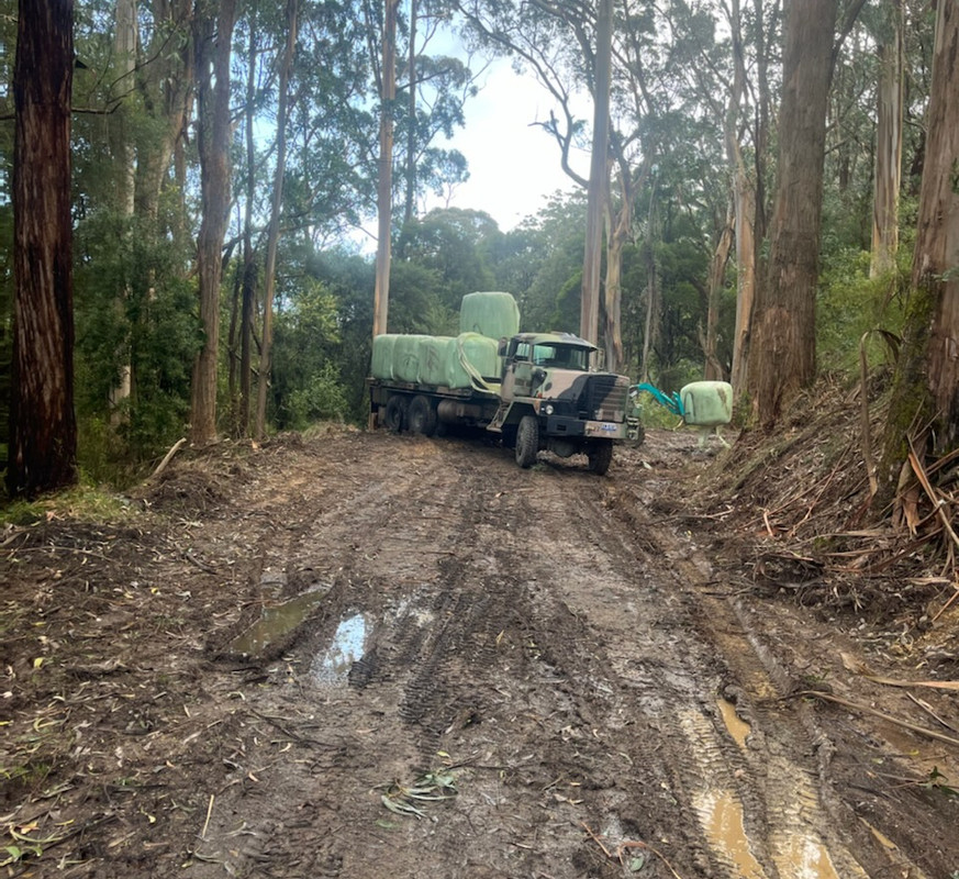

My brother has in recent times finally after many many decades had a life changing event happen, he has bought a Mack, think it is 1984 build
His is a ex army (Australian Army) 6x6 and it has 44 rears and has full cross locks on all three axles from new as well as inter axle powerdivider lock and transfer case lock
It is standard from Mack Australia full time 6x6 fully locking 6x6
So I'm guessing that if we had it in Australia then they are definitely available else were as we really got the scrapings from the bottom of the barrel compared to the states

I have seen this setup in single axle plow trucks, the little peanuts come out and lock against the outer plate, but I did not think it was selectable, thought it acted as a locker/posi works in a car differential.

Yeah..it engages and disengages at will..Great design
