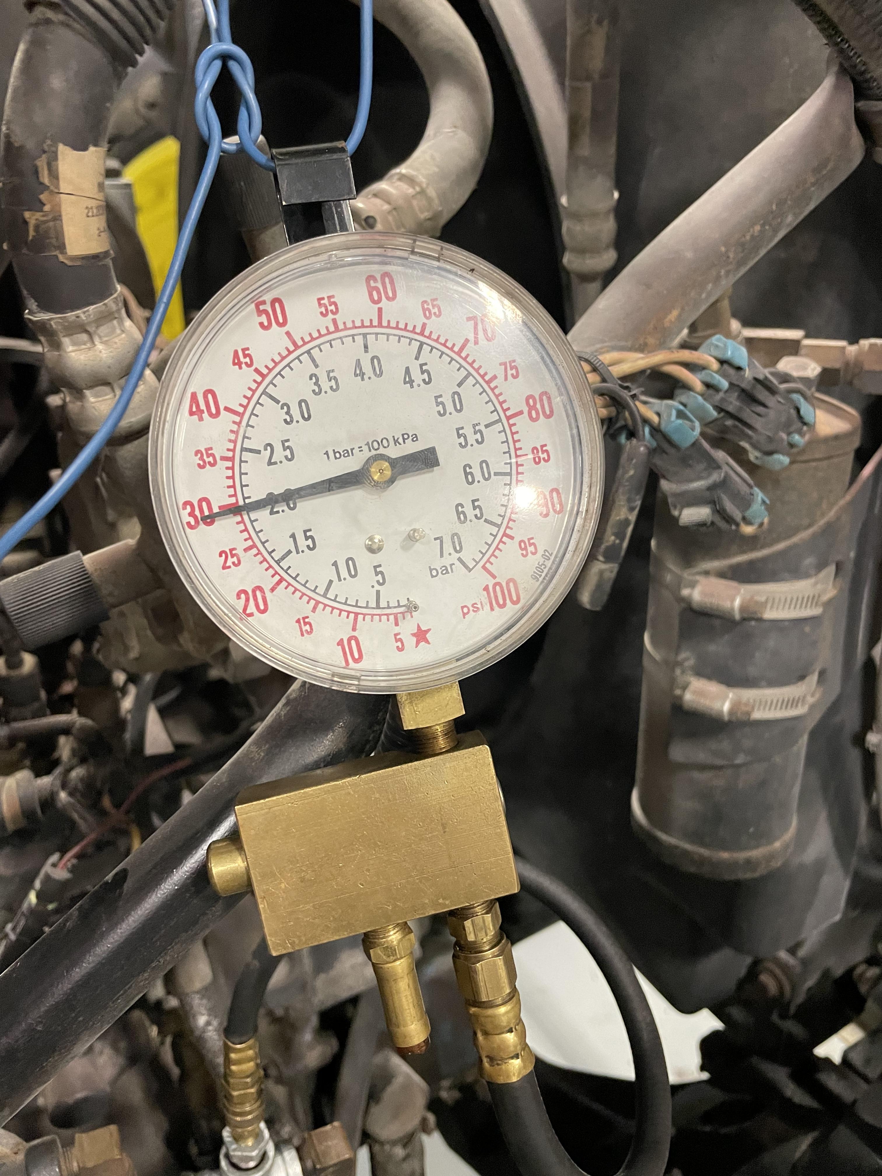

Ok, it has new filters and tanks were clean. I will pinch return off to see if it changes. I did remove the pump and the cam in the injection pump looks good.
5 minutes ago, br549 said:
There is a line that comes from the intake manifold around front of engine to back of injection pump.  As the turbo pressure comes it put pressure to the back of the pump to open up fuel rack.  If the hose has a hole in it or the diagphram in the back of governor it cannot let the rack open up.  We made up a fitting and gauge to put air pressure on it to see if it would hold air  around 30 psi, if it leaked down it could have a hole in the line or the diagphram in the pump which can be easy change without removing pump.  W also used to adjust it to pick up faster if it was just slow response pickup.  You pulled the plug and there is a cog like a brake adjuster in it you take a short screw driver and click it but I can't remember which way to go.
This wouldn’t reflect lift pump pressure though right? I don’t mind to look into that but the lift pump pressure is half of what it should be apparently. Thanks

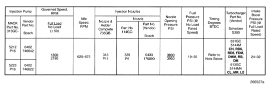

10 minutes ago, Vmac3 said:
The specifications that I gave were, no load idle and rated speed. These specs are published by Mack for this model year.

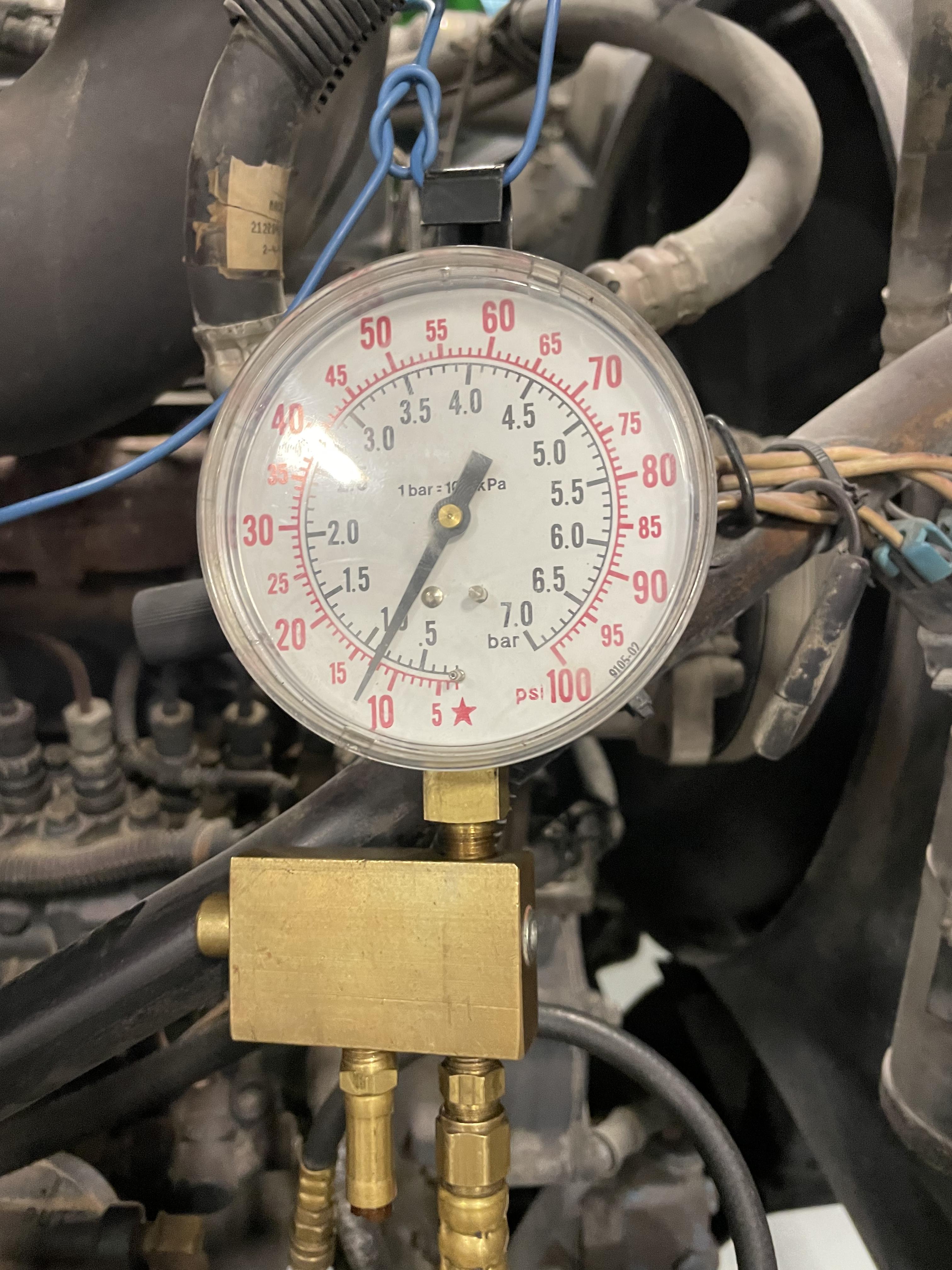

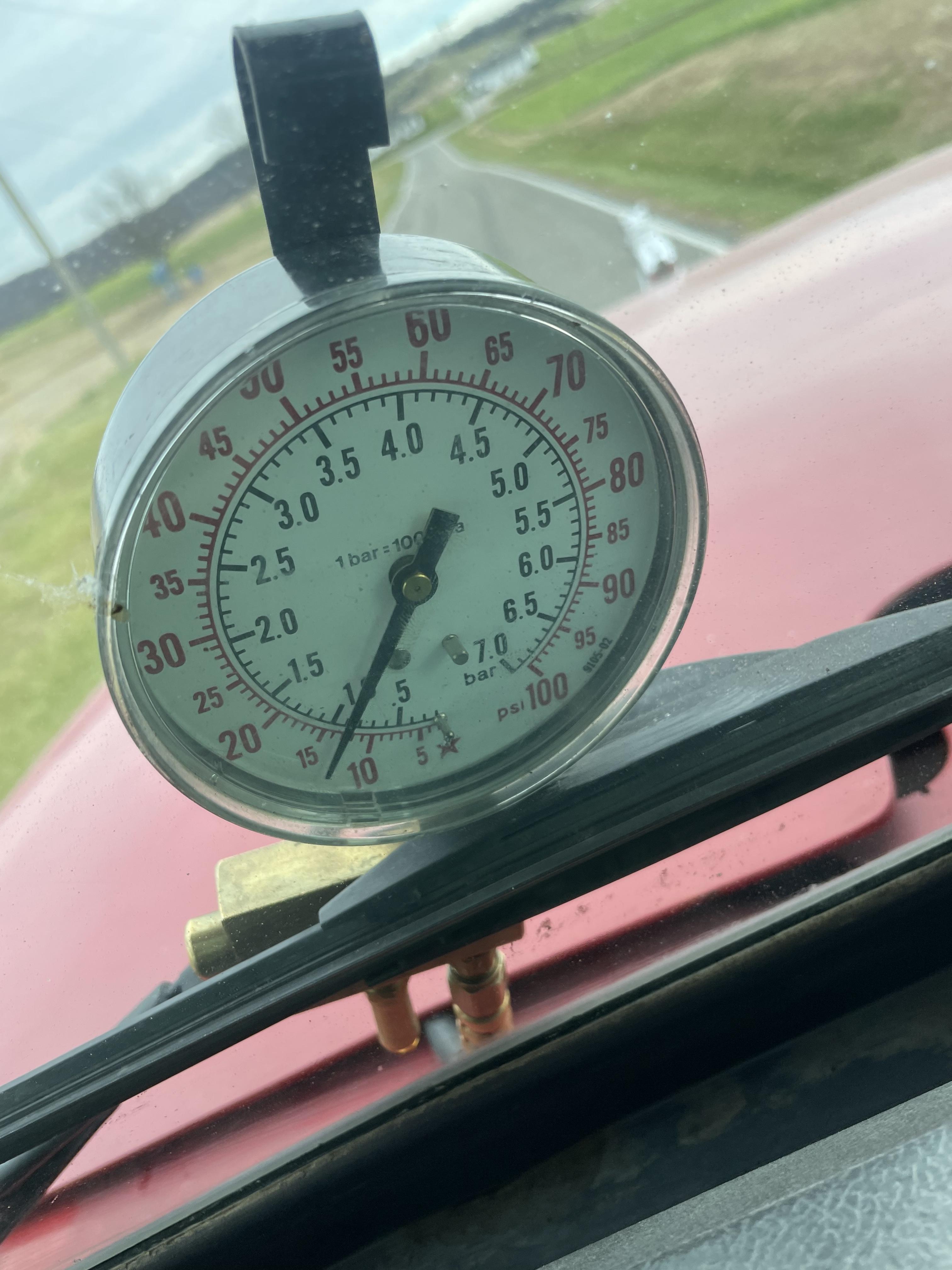

Thanks guys. Took it for a road test and still low pressure. When making boost pressure would drop to 11psi and when let out of the throttle it would bounce between 20-25psi
V
Yes thats right for a fuel pump check but for checking pressure thats got a know problem only god knows how many i have seen that would hold that pressure but as soon as you load it and start to consume more fuel per hour a restriction  or sucking air would drop the pressure.I think all manufactors of engine only give you the stactic pressure reading.Not long ago one of the guys that i work with had a power problem on his nack and it had pressure sitting here in the shop but i checked it under load and it would go to nothen.i found a big night crawling bug stuck in the primary fuel filter inlet fitting.

Thanks, I was thinking the same thing and didn’t see why running it under a load would raise the pressure at all but it was an expensive pump and easy to reinstall to try it. I will try to run straight from a bucket of fuel tomorrow to see what we get.

So I have a suggestion for you Before you go any farther ! Those numbers Aren't that bad seen alot worse if that engine is maintaining 25 psi plus under load the charge pressure is OK!
REmove the 3/8 plastic line that goes to the smoke limiter at the back of the pump at the top suck on the the tube if it won't hold a vacuam  the diaphram in that device is fubar you need to go there ! Remove the four screws you'll likely find your problem!
Just sayin!
So I re read the other posts and eleven under load is to low for sure your heading the right way fuel transfer pump or a leak prior to it! also check your tank vent! The above check is worth doing if you have good fuel pressure !
