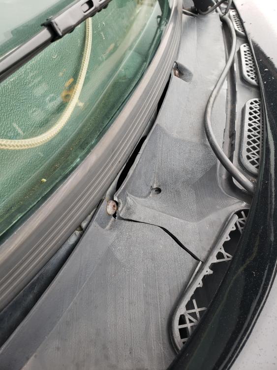

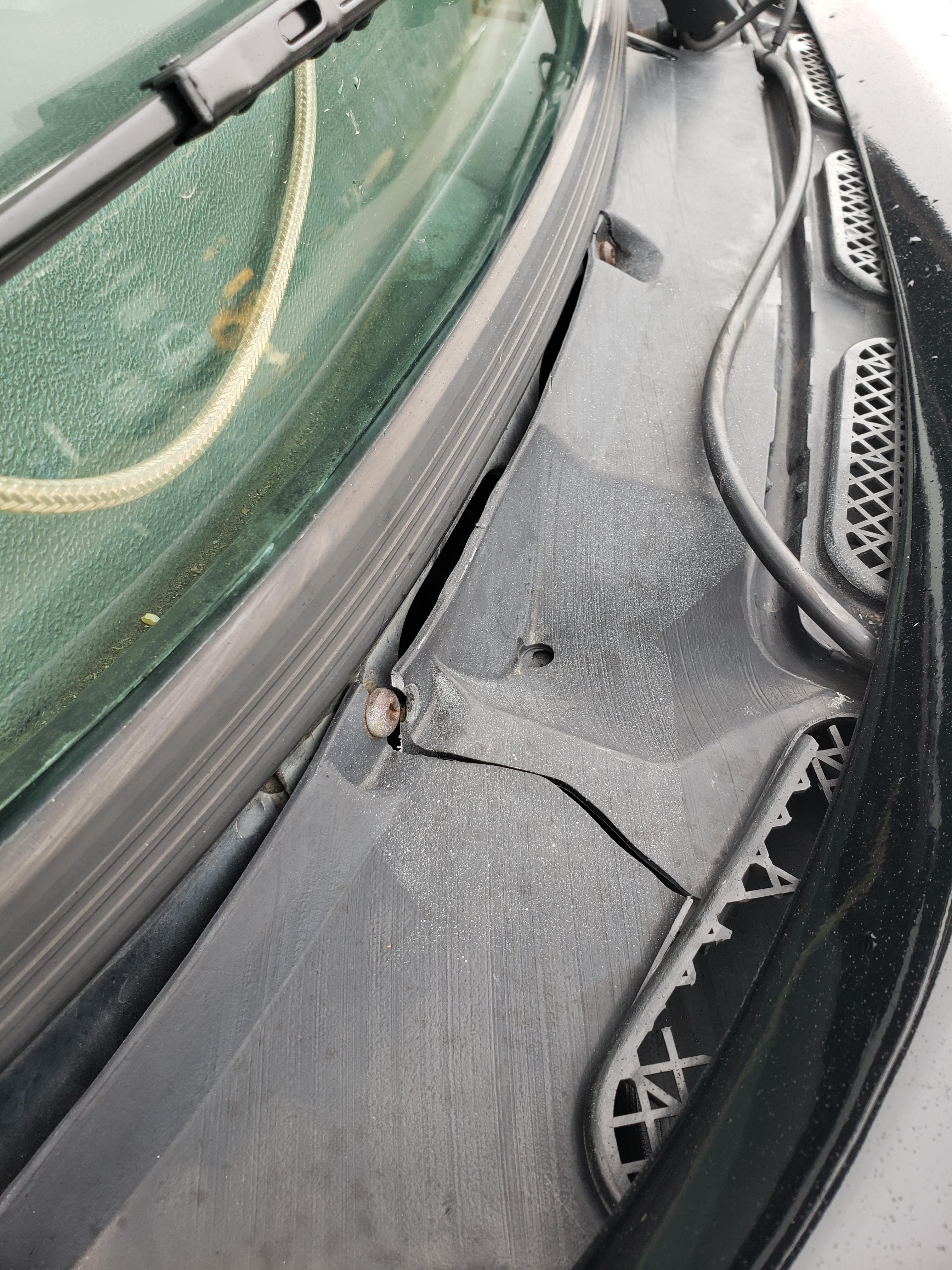

  14. Upon inspection I found the plastic water trap in front of the cab is cracked. If water gets around this can it end up in the cab? I attached a picture
  15. Hey fellas, after a day or two of some heavy rain in Southern Illinois I went out to move my CH around the yard and found an uncomfortable amount of moisture in the passenger floorboard. No puddles of water on the floorboard but it is definitely soaked on the passenger side. It seems to be wet in the very front right corner of the truck as well near the firewall. This has me pretty concerned since the VMACII module is mounted right in front of the passenger seat on the firewall. Without doing any extensive searching it looks like the only place the water could be coming in from is the door seal on the passenger side. Is there any place else on these old CH cabs that were common for leaking? Thanks in advance
