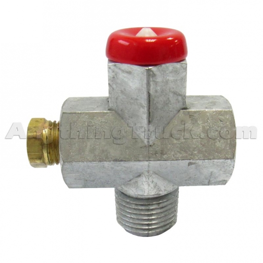

stsrted the truck and let it air up until the governor shutoff. Shut the truck off. Could hear some air leaking from the front of the truck, o opened the hood and started spraying airlines. Not exactly sure what this thing is or does but it was bubbling at the red part. Secondly I confirmed that when I flip the switch to drop the lift axle, the green needle dropped. So it seems that there’s a leak somewhere in that system and when it loses pressure, the axle drops. It’s a start. Hopefully when the rain stops o can lift the bed up and start checking under there. As well as the brake cans as I have a feeling that could also be a culprit
That's a cutoff for if the air drops too low. It's purpose is to stop air from going to something less important than brakes. ( like suspension ) they're regulated and colored for how many pounds they allow.  With the truck shut off ? The gauge should drop as the lift axle is put down ( air's going to filling the bags )  there's reservoir ports on the govener that'd probably be really easy to charge the truck with shop air

So I’ll need to replace the cutoff?

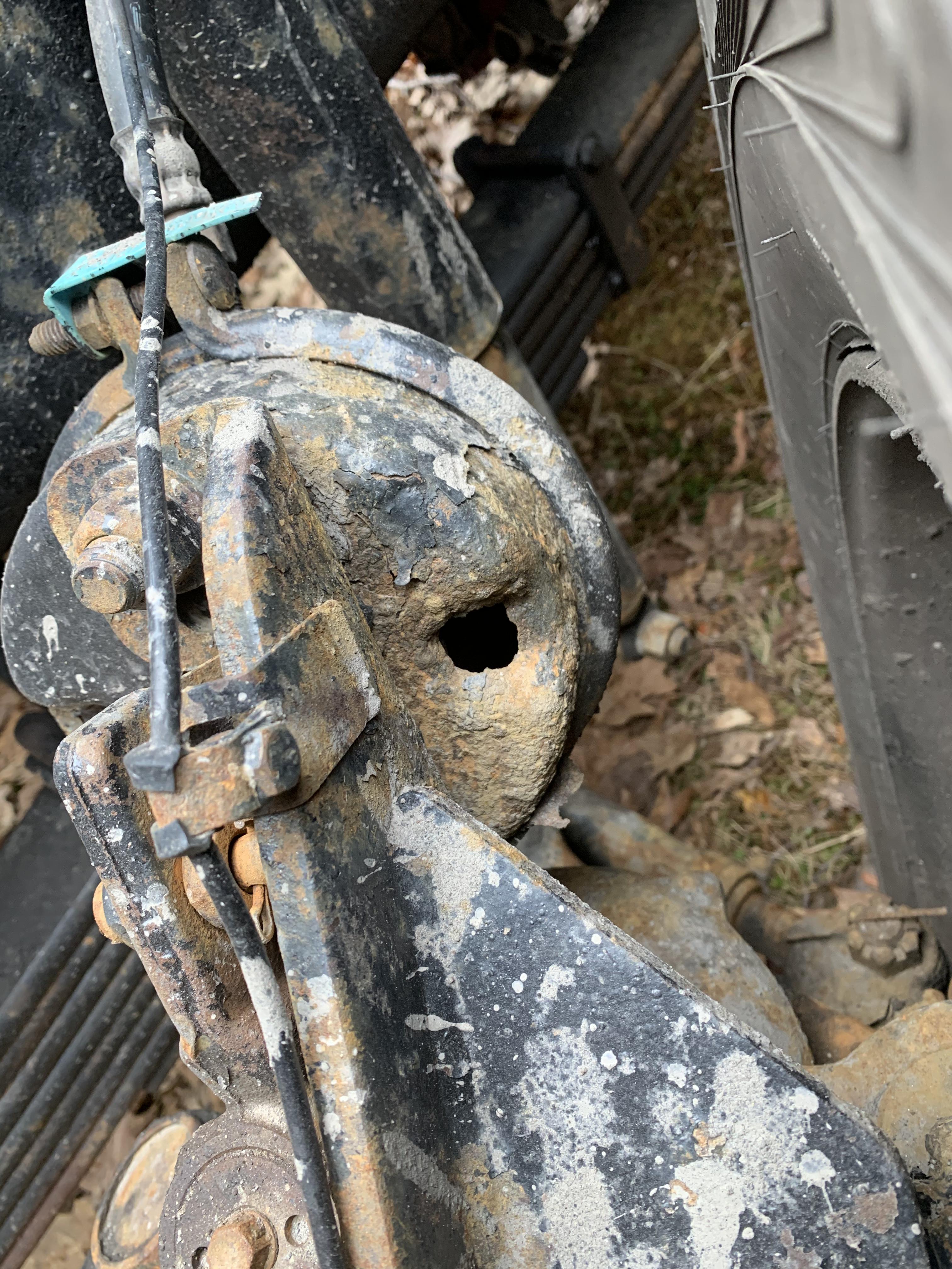

The CLs I had, the air dryer was right in the area about where the back of the transmission is. Mounted inside the frame. ( this doesn't mean your's is )  Yes the tire valve you mentioned, you can put shop air in there. The cutoff/ regulator ( thing with red cap ) if it's leaking, it's shot.  The brake air leak is likely a diaphragm in a service chamber

For the regulator thing with red cap, is that a dealer only part? I believe it’s a pressure protection valve?
I’m going to assume it’s the diaphragms that are leaking. But going to start with the smaller things first.

I'd get the red thing from your dealer by the VIN of the truck . I've seen them at parts places, but not sure the port sizes will be direct replacement on your's.  Charging the truck from shop air ?  not much chance you'll hurt anything. Joey's idea about going in the compressor discharge is a good place, and when it hits @ 120 you'll hear your air dryer go off. ( if you're worried about too much )  Likely charging in the primary tank won't hurt either.  If this truck has leaks from valves you may want to consider finding that air dryer and replacing the desiccant at least.  Only reason I suggested the governor  was it's marked and probably easier to get at....and air will go in the truck much slower through a tire valve in one of those little ports.

Th@ red button doodadd isa  pressure protection valve
The velvac valve available with 85,70, 67psi or black button of 45psi
could B setup to air up the air ride cab when the psi is reached

I will have to call the dealer tomorrow and find out about the part.

I looked and I still for the life of me cannot find the air dryer. I’m not sure what the issue is with that. I called local Mack dealer and they have a pressure relief valve in stock so I will pick that up. I noticed this today, so looks like I’ll also be needing to replace at least 1 front brake can unless the hole is there for performance 😂 so add that to the list.

its possible that there isn't a dryer. I would expect this year model to have one, It could have been removed by the previous owner, who knows.. judging by the brake chamber picture, i'm guessing "Pre-trip" was not part of the previous owners day. and maintainance,,, well????.. All of us will help him get his truck fixed up. :)
