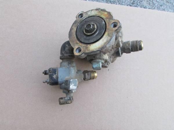

there is a brake can leaking also on the truck.  if i took the valve off for no reason im going to cry.

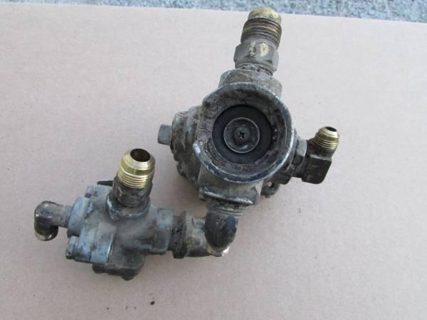

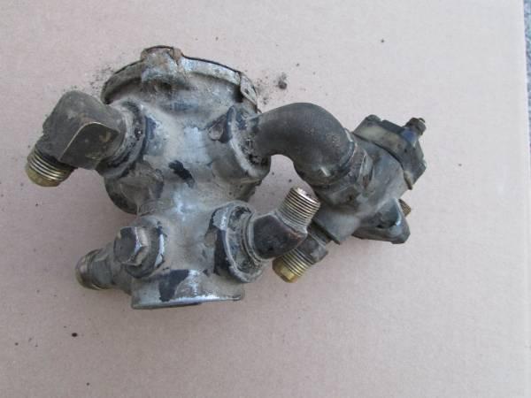

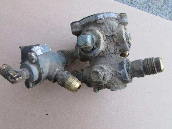

the valve leaked when i released the brakes.  i put the new valve on and it leaked when the brakes were applied and released.  i caped off the two air lines going to the leaking brake can and that didnt help.  i ordered another valve.  im at a loss.

did you take off the SERVICE line on the other cans and release the brakes; with the wheels chocked of course. possibly another can is by-passing you can't hear. is the pedal itself working free and not oxidized to mount sticking partially on. with parts today , could be bad new valve.  does it have a trolley valve that may be part way on ? did someone have lines off a can then put them on backwards ? these may sound like dumb questions, after xxxxxx yrs of 24/7 road calls ; you get to where you have to start basic with questions.  35min trip on road for liftgate not working --- power cord to trailer not plugged in. next call for same , I said to driver :" is power cord plugged in ?" ; reply - yes it is .... 40 min trip front of trailer  power cord hanging . I said "thought you said cord is plugged in!!!!!! . he points to LIGHT cord and says that's it right.  light cord green , 2 wire power cord black ...  OK I'm paid by the hr, still have rest of fleet to maintain.
