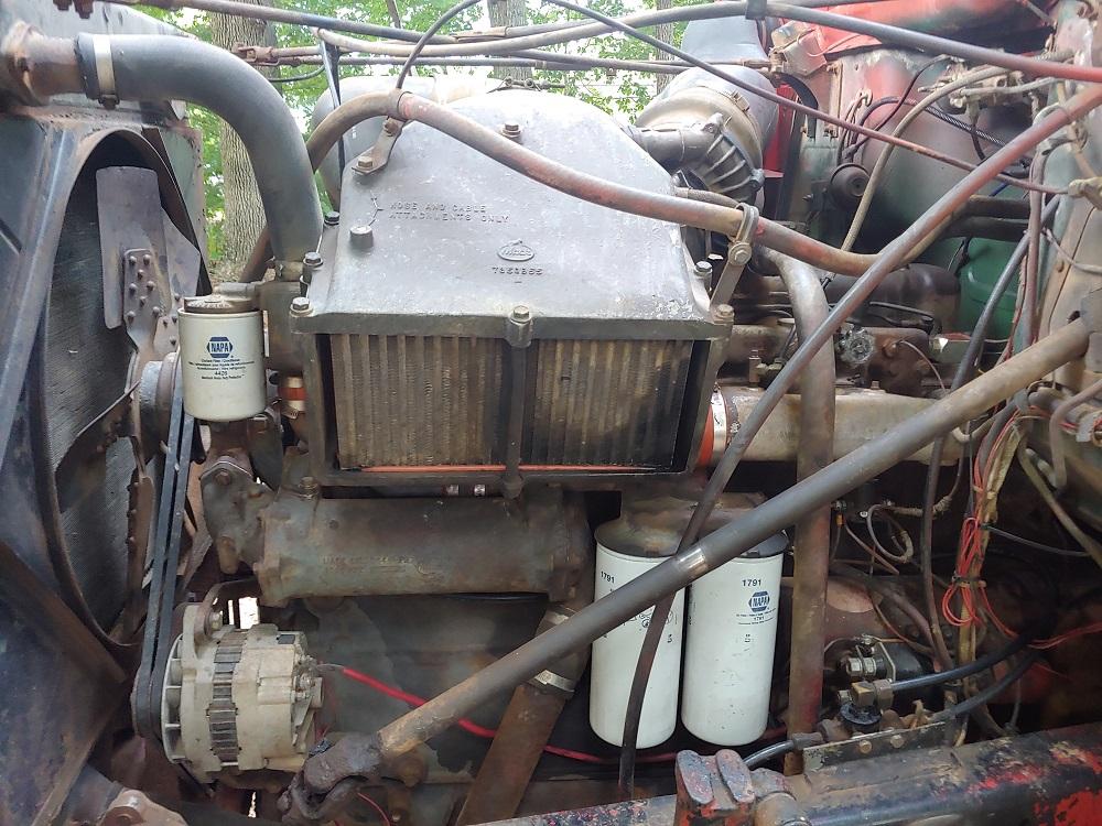

I have posted here before, I now am running into a problem with my 69 R685,

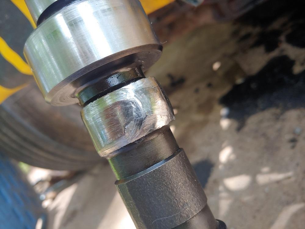

Last week while hauling stone for a local job, I noticed a noise from the RH side of the engine, not really a knock, but a rythymic high pitched tapping. Upon getting home I pulled the valve covers to find #3 and #5 intake valves with about 1/4 inch lash.
I pulled the rockers and checked the push tubes for bending or deforming, all good, It seem to me I am gonna be replacing the cam and tappets now.
 I am fairly sure this is not the factory engine for this truck as I believe the  Tip turbine aftercooler did not come out till 73?

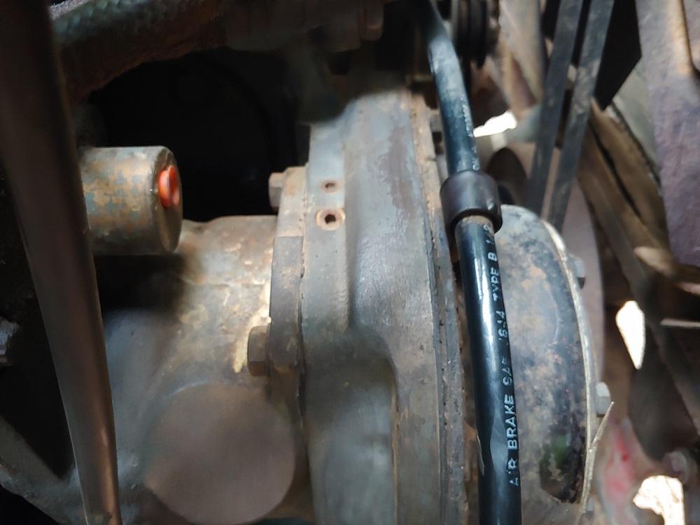

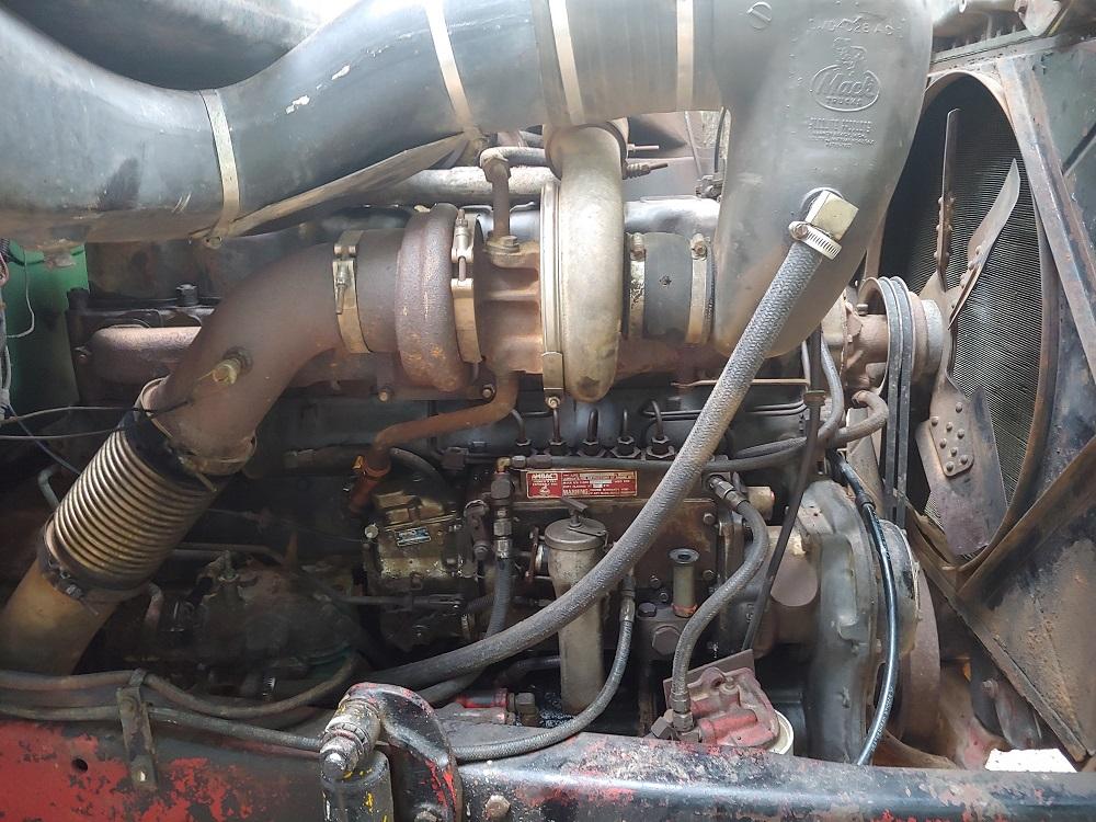

My problem is that at some point it has had a Mack reman engine installed before I ended up with it, and there is no serial number stamped anywhere on the front cover or behind the injection pump, or anywhere on the engine for that matter.
I am wondering now whether I need to order parts for an EM6, T675 or T676 engine.
Pics attached
If the block is out of a cabover the number is clear on the back of block, right below where block and head meet, will be hard to see in a r model, have use a mirror maybe, a reman mack engine should have a tag on it, maybe torn off.  looks like a T676, but cam and lifters might be the same on a 675 and 676 engine.    terry:MackLogo:

Would a factory New short block be stamped with a serial number? I have noticed that the bell housing and injection pump drive are still painted the gold color the Maixdynes were painted from the factory but the engine itself is Mack gray.

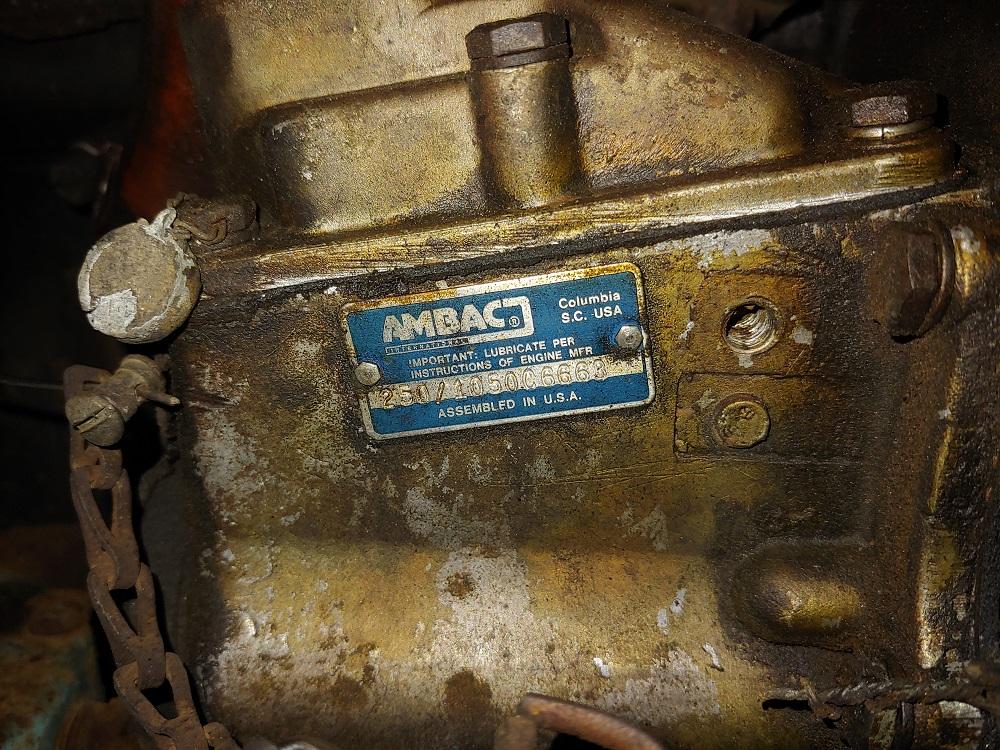

On 7/7/2020 at 9:27 AM, j hancock said:

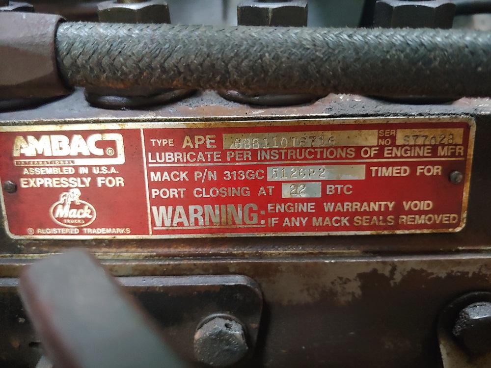

The AMBAC pump number 313GC5126P2 was used on the ENDT676 285 HP engine.
Thanks Mr. Hancock, Than information confirms my suspicion on this truck, The Mack museum and my local dealership state that this truck was built with a ENDT 675/ 237 Mack engine.  I am guessing it had a ENDT676/285 swapped in sometime before I got it.

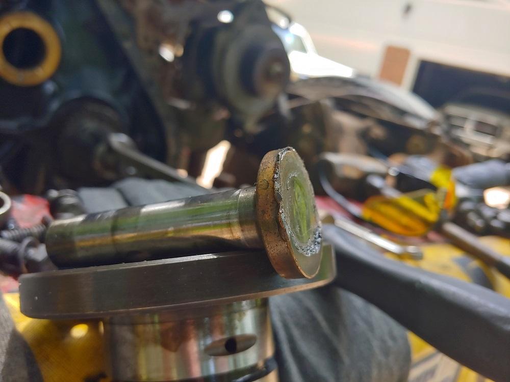

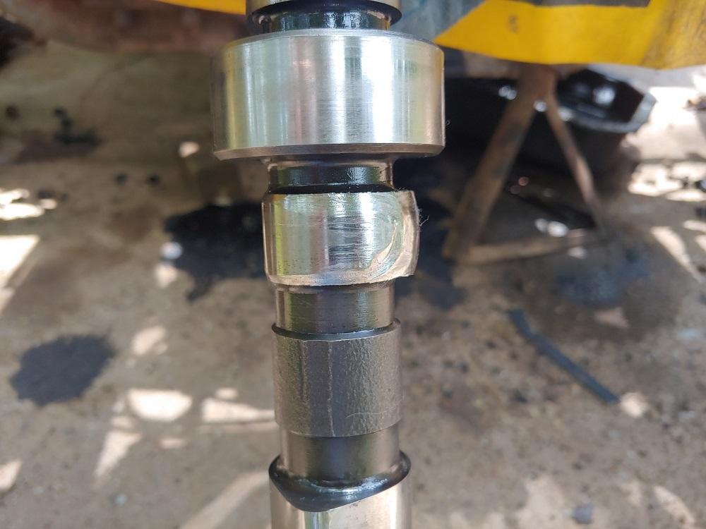

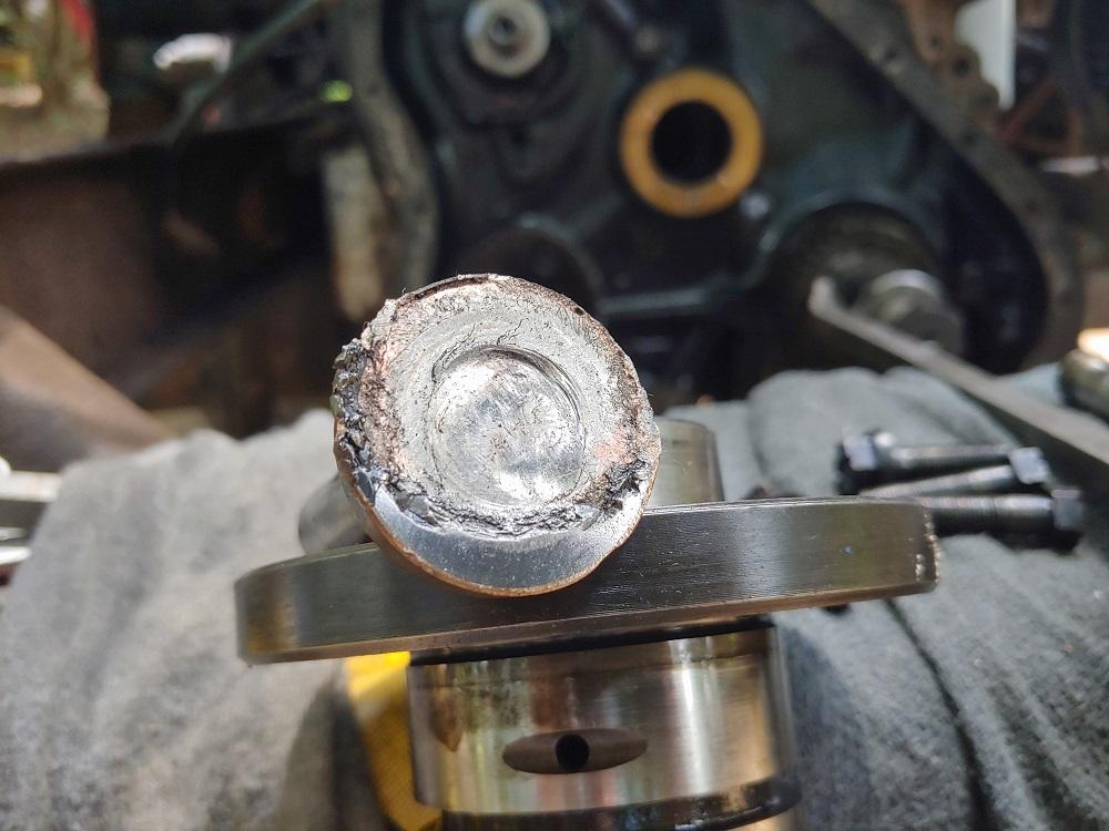

My suspicions were confirmed though, after pulling the oil pan this morning  I could clearly see that #3 intake valve cam lobe and tappet have some serious damage, I got most of the engine torn down today and will hopefully get the cam and tappets ordered tomorrow.

new style lifters are of  better design the original lifter had the hard surface silver soldered on the new style seem to be one piece these never or rarely fail !

Long story short, I actually ended up sourcing a New camshaft and 12 new tappets from Capitol Reman in CO, they stated that PAI in GA still produced the parts, part # PAI272949 or ECM-9002 for the cam and EML-8583 for the tappets.
I did measure all the surfaces before installation and noticed that all cam lobes had at least .015 wear on them when compared to the new one.
