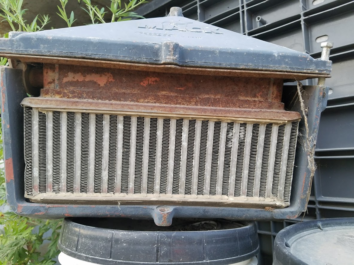

I have an E6-350 from an 82 "Cruiseliner" and it had a chassis mount charge air cooler. This is slated for my 58 B-61 and runs well. Had an 81 R model that was a 350hp ETAZ-673 something with the water cooled tip turbin setup. I still have the engine but it was knocking in the lower end. I'll have to look at the block for the full set of numbers.

I don't know for sure. The four valve E6 engines were coming out in the early 1980's but I've not seen a tip turbin setup myself past early 1982 as the move to chassis mount charge air coolers was going forward.
The two valve continued to be used in DM's into the late 80's with the tip turbine because the steel hard nose wasn't able to accommodate the chassis mounted air cooler (CMCAC).  In 1988, the DM-690 was fitted with the CMCAC.

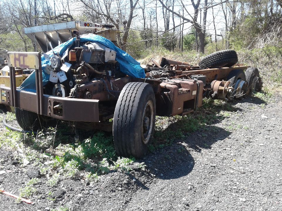

Has the look of a DM.  Big frame and a DM style fuel tank.

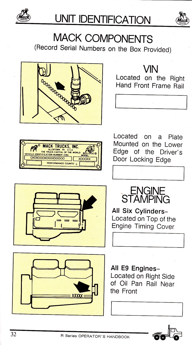

Can you get the engine number?
Its not local, can you tell me where to have the seller look?.... and, what's that rig worth?... as pictured The 6 speed is already sold.

If the sheet metal data tag is missing from the pass. side of the block, the engine code is stamped into the top of the timing gear case in front of the injection pump.
It's worth?  Depends.  Does it run?  How well was it wrapped up?  Did water get in and freeze?  Why was it taken out of service?  How many hours?
It is 2,000 lbs.  What is the price of scrap?
