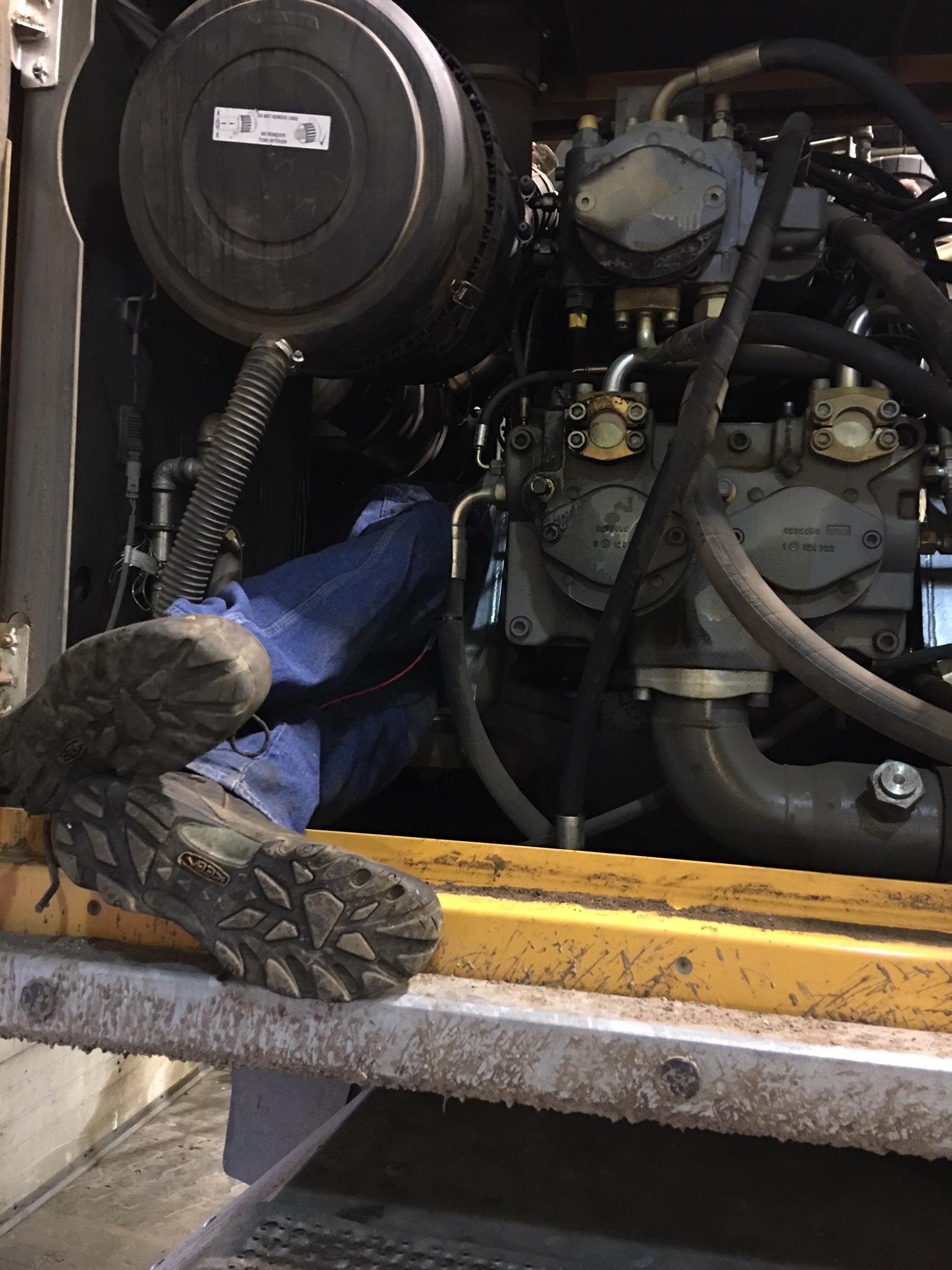

Yesterday I worked on a European unit which converted from tier 3 to interim tier 4 with, I'm guessing, a 6" increase in the engine compartment. Keep in mind they made this jump from internal (AI style) EGR ...........to complete external EGR with multiplier turbos. Basically they just cut the inside of the counterweight out for the DPF.
My co worker snapped a pic while I was working, under the DPF, on the engine's blind left side by pressing myself into the pump group. Luckily he saw the second successful attempt getting in and not the first attempt when my pants snagged and pulled off.  I'm inserted between the DPF on my left hip and the basement of the engine compartment on my right because there is no top access around the emissions system and a superstructure below.

It's a good thing you're skinny because I'd never fit in that engine compartment. This emissions crap has made it tough on everyone who has anything to do with it, from the engineers to the consumer and everyone In between.

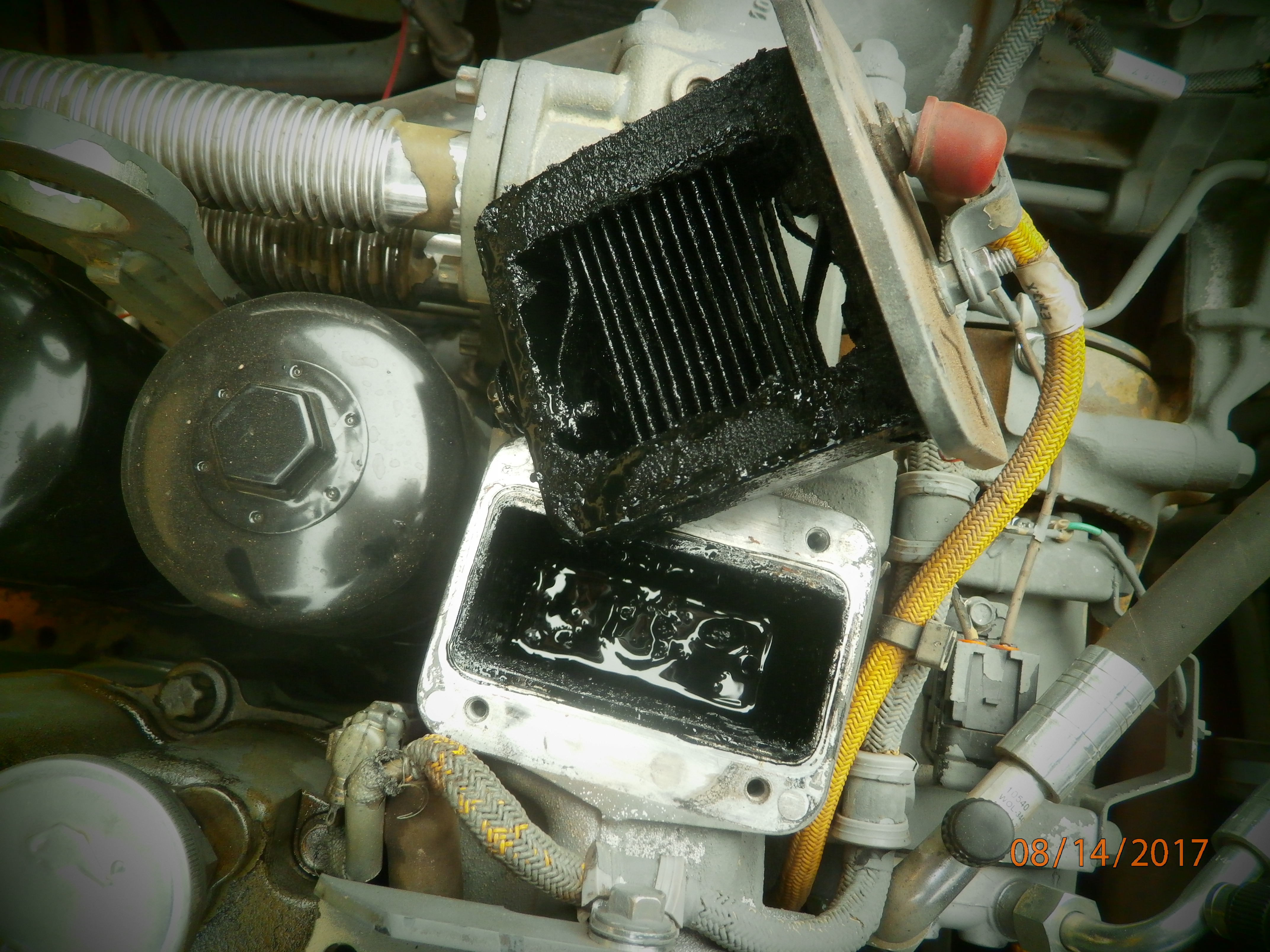

MT, I'm clueless on emission systems. What exactly does "the emissions system support failed" mean?
They had to add a second small turbo with the Interim Tier 4. The bearing cartridge was too small and failed. Blew oil into the intake at a high rate of feed. Exploded cylinders and sheared crown of sleeves off dropping them into the pan.  It had been a 30K-40K hour engine life in tier 3 level.
