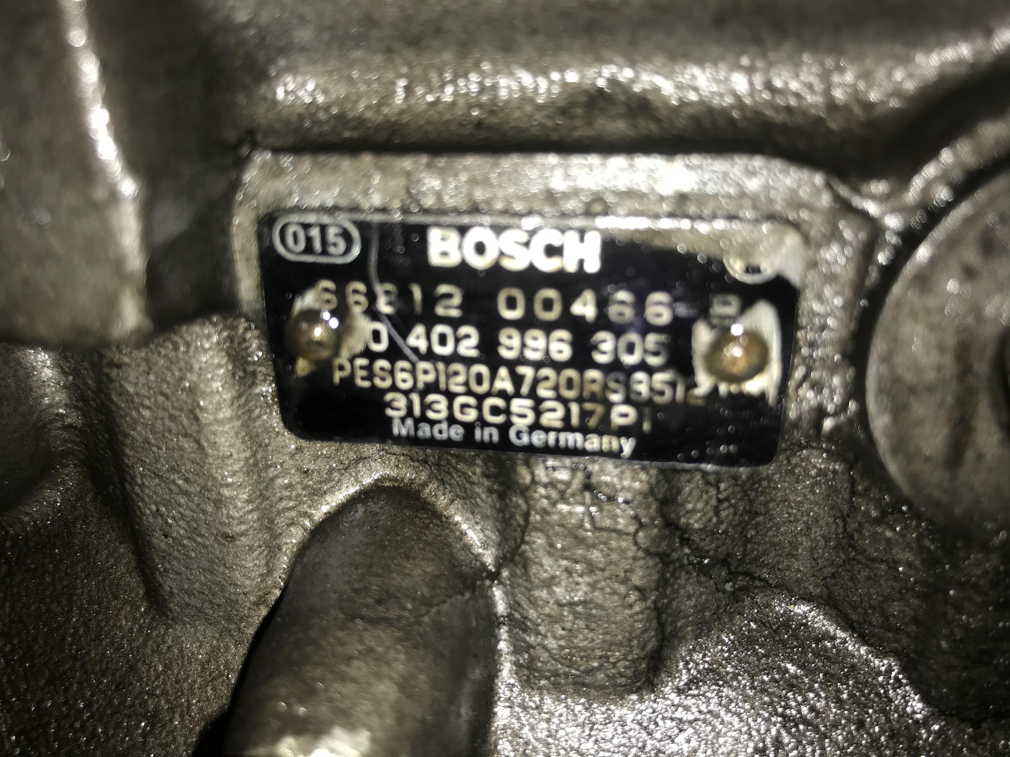

I hate to drag up an old thread but i need to convert my 97 CH613 E7 vmac2 to mechanical due to an electrical fire. Im not getting anywhere asking the dealer or local bosch pump shop. Can I just remove the whole electronic governor assy and install an RQV style governor? Maybe lock the econovance to fixed timing, or run a boost reference switch to activate it. Ill post some pics of the pump and engine tags.

Can't just change the gov. Housing has to be a full mech pump to convert properly. You can lock up the econovance and still use the same lines, etc. Today we just picked up the mech pump we had built. After we do the install I'll write up everything we had to do in order to convert. I know a few guys would love to do this conversion as well. We have everything but the linkages but not sure what way to go about it. We were even thinking about a cable set up over linkage.
The guy that did our pump John Miller, we asked him if it would be ok to send some more guys his way and he said no problem. He knows the guys from antrim very well. Lives upstate ny. Pm me for his contact info or if it's ok I can post his # here

If it is a robert Bosch pump then a E6 will work.
E6 Is  is standard thread I believe! The e7 lines are metric! You pretty much need the fuel line set up from  a donor engine! vmac lines are totally different guess you could disable the syncro vance and leave it in place! Don't know never tryed this!
Scheid Diesel in Effingham, IL will make a set of lines for you with whatever ends you desire. I've found them much better than dealership pricing or "one off" replacements.
Now that i think about it what i did is i used E7 injector lines with the E7engine and they will work with a E6 pump.On my bobtail i have a E6 pump on it and the E7 pump is for a spare.And it has been on the engine at one time.
