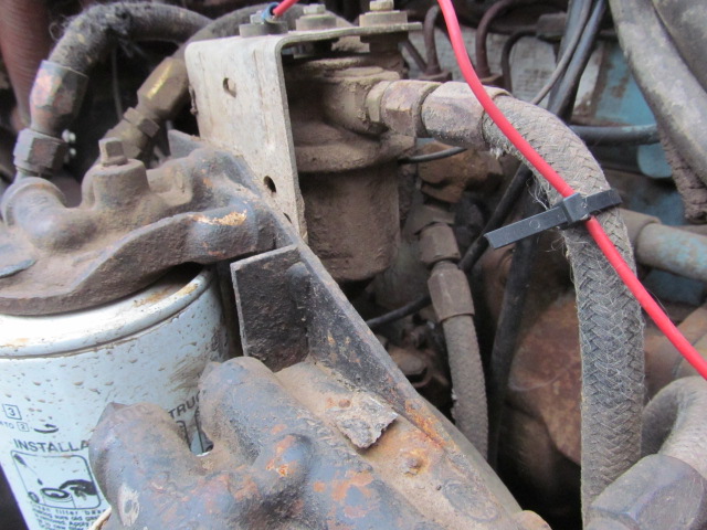

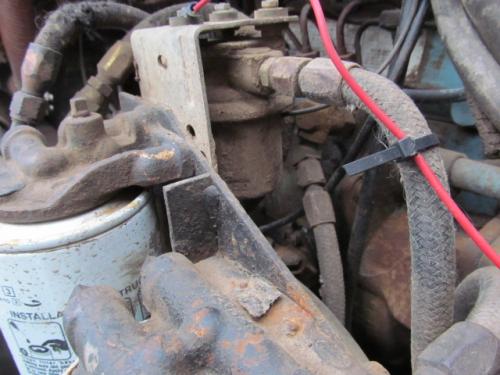

In my 78 RS600L, I have an EM6-300. Not the original engine and im not sure what the original engine was. I have an electric fuel lift pump mounted behind the fuel filters that is energized by the ignition ON. Is this a factory lift pump? Its working just fine and makes priming the system and fresh filters a breeze. Just curious
Don't mind the red wire...that's just a mickey mouse and temporary ground for a marker light I had to jimmy rig recently.

Looks like a regular Carter style electric pump. I'm guessing it is someones handywork to fix some kind of issue.

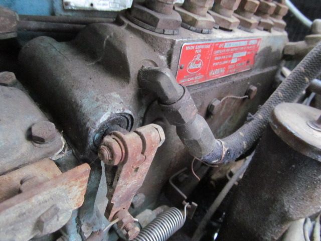

Can you take a picture of the side of the injection pump? If there is no hand pump or lift pump then I guess that is why they put an electric one on it?
Larry

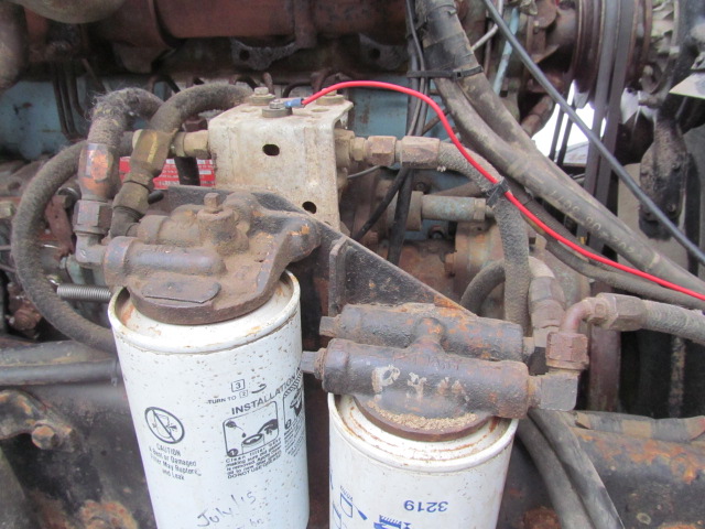

Here you are, pics of the pump. Yeah, that looks just like the electric pump that's on mine. What did these use as a lift pump from the factory? Did the IP pull fuel from the tank on its own?
Im having what seems to be a common Mack issue, with it having an irregular idle from what I thought was worn governor springs; but im wondering if the electric pump is pushing fuel at a different psi then what the injection pump requires?? Just a thought that crossed my mind.....

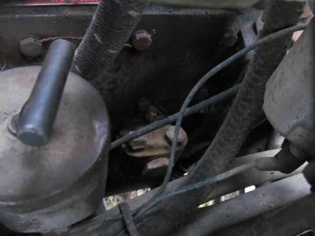

Is that in fact a lift pump, or where the pump used to be? I don't see any lines going to or from it. Is it safe to run an electric in conjunction with the factory pump?
Im assuming there was an air intrusion issue or drain back problem at one point and someone put and electric on there as a band aid solution. Im happy with how its been working however. I will be buying another electric lift pump to keep in the tool box in case it fails somewhere out in them bushes...
That is a original lift pump, no primer on it, the fuel originally came from tank to primary filter, than to suction side of pump then pushed it through secondary filter then to injection pump. And they didn't alway have the primer pump on the lift pump. I would guess the original pump failed, they only have a couple of plastic check valves in them. terry
post-20840-0-88320600-1454127730_thumb.j
Those two hexes on the top of the pump are the valves. My 237 had issues when I first tried to start it. Would not prime(Mine has hand primer mounted where the front hex is at).
The fuel line should come from the tank to the FRONT fitting on the bottom, then out the rear to the filter(if I recall correctly). Doesn't look like there are any lines hanging on the bottom, so I'm guessing they are using the electric pump.
Remove those caps on top, I think there are small springs in there too? Been a month so I don't recall all the details of mine.
