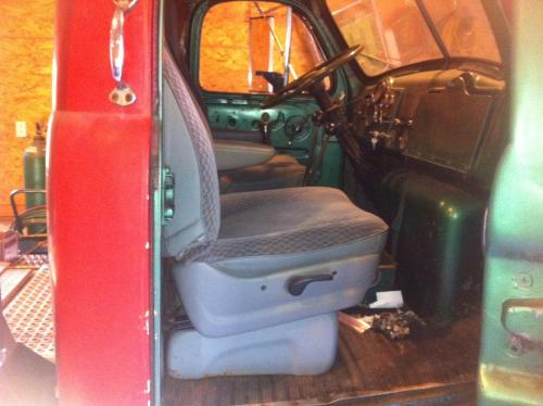

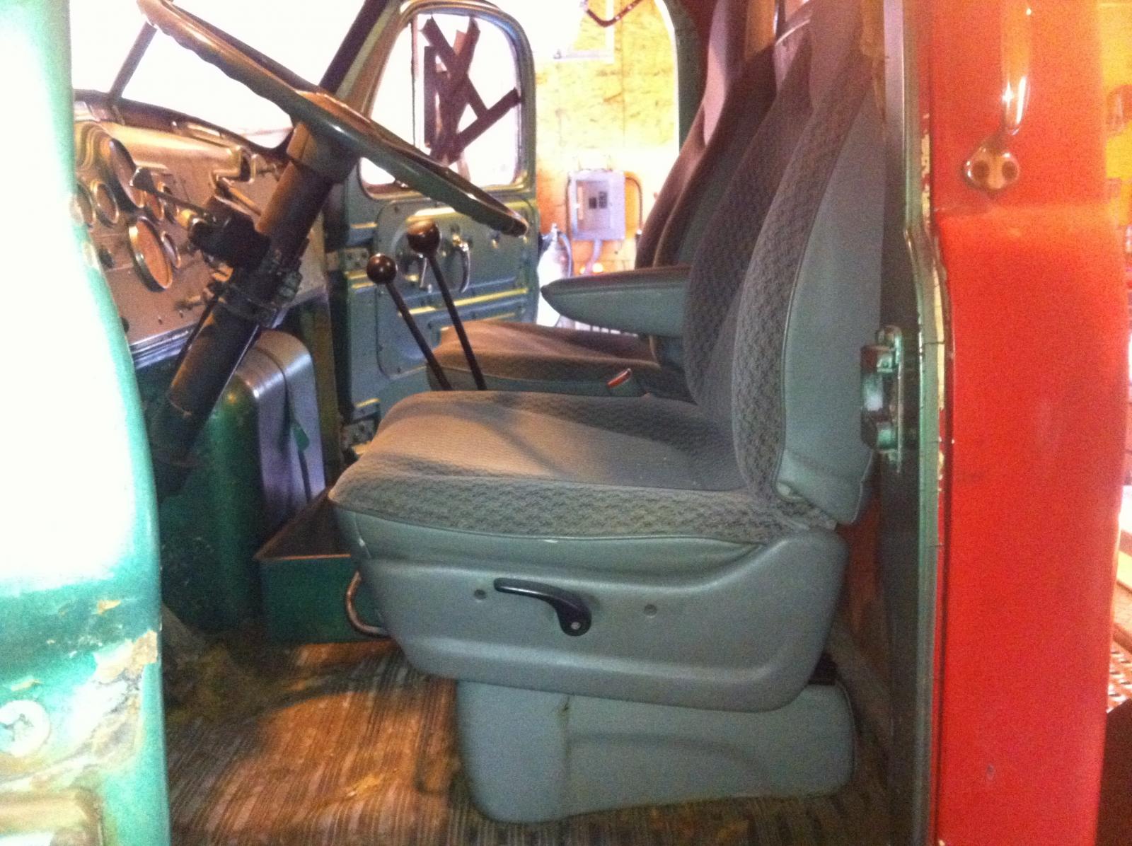

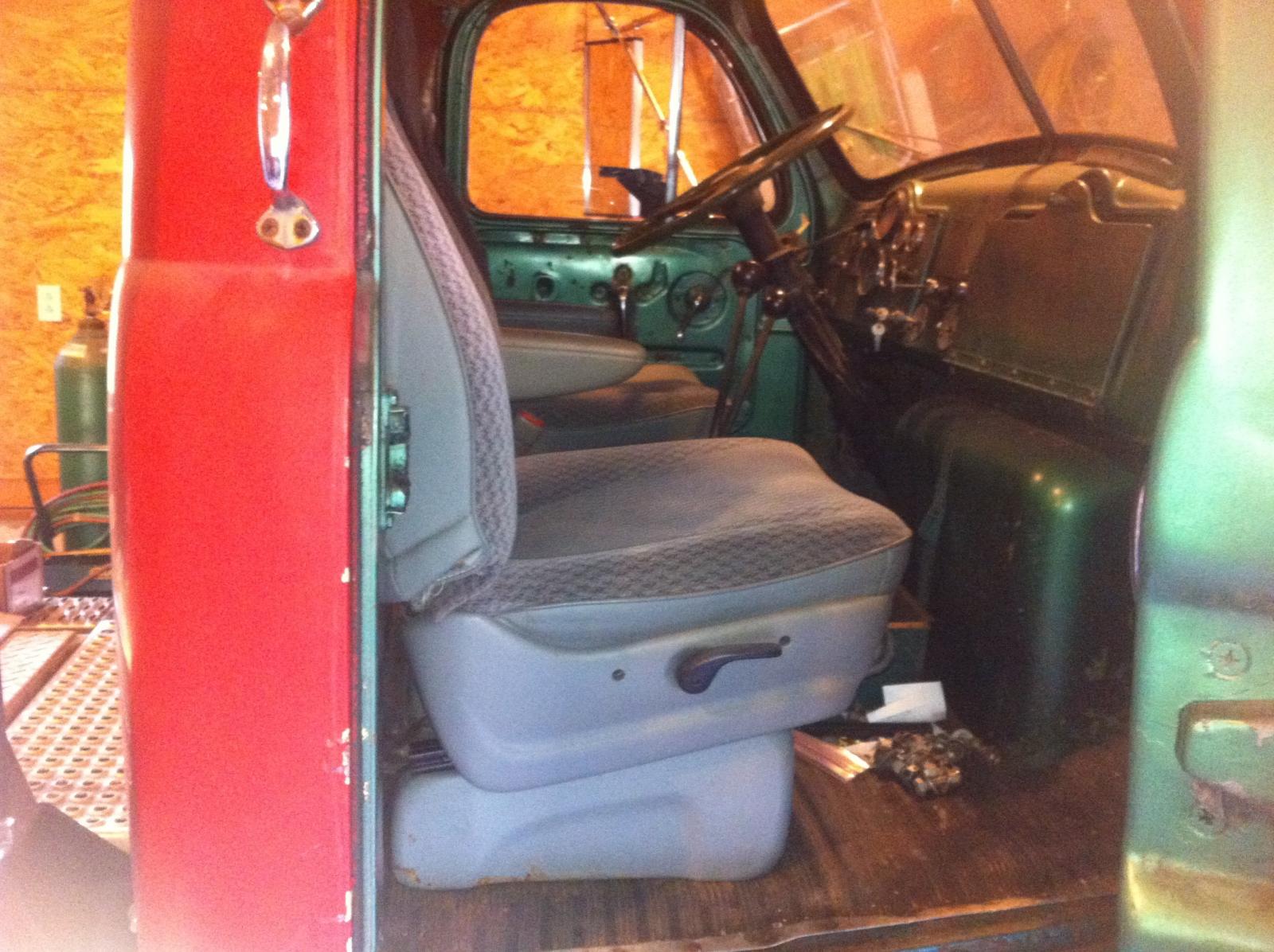

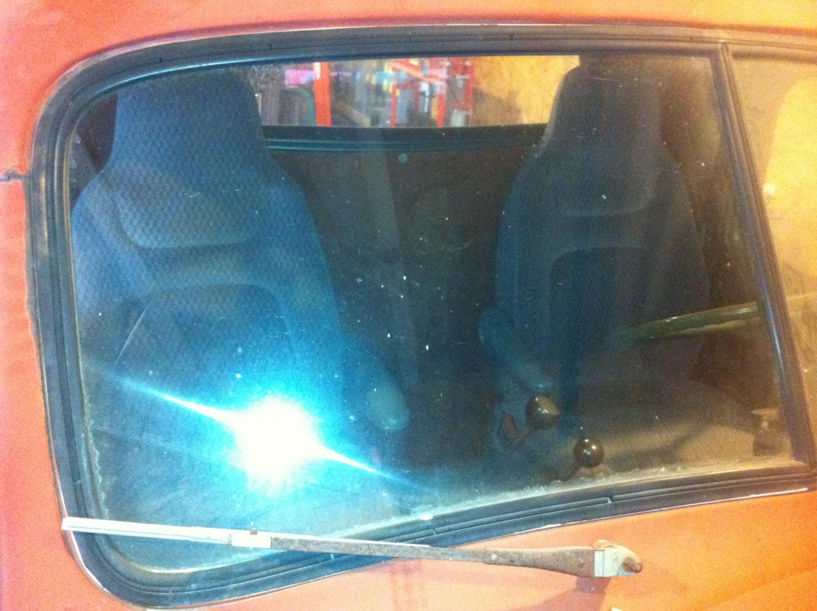

I was looking for ideas for seats for my B67. It's a concave cab and I'm 6'2" so room is a factor. I ran across one on youtube that fit very nice, but didn't look very comfortable. Then a trip to my buddy's junkyard with a tape measure I found 1998 dodge minivan seats are a perfect fit. The van also has a flat floor so the seat bases sit right on the mack floor. post-18910-0-44141400-1449265069_thumb.jpost-18910-0-38392000-1449265193_thumb.jpost-18910-0-43562900-1449265243_thumb.jpost-18910-0-49738000-1449265291_thumb.j

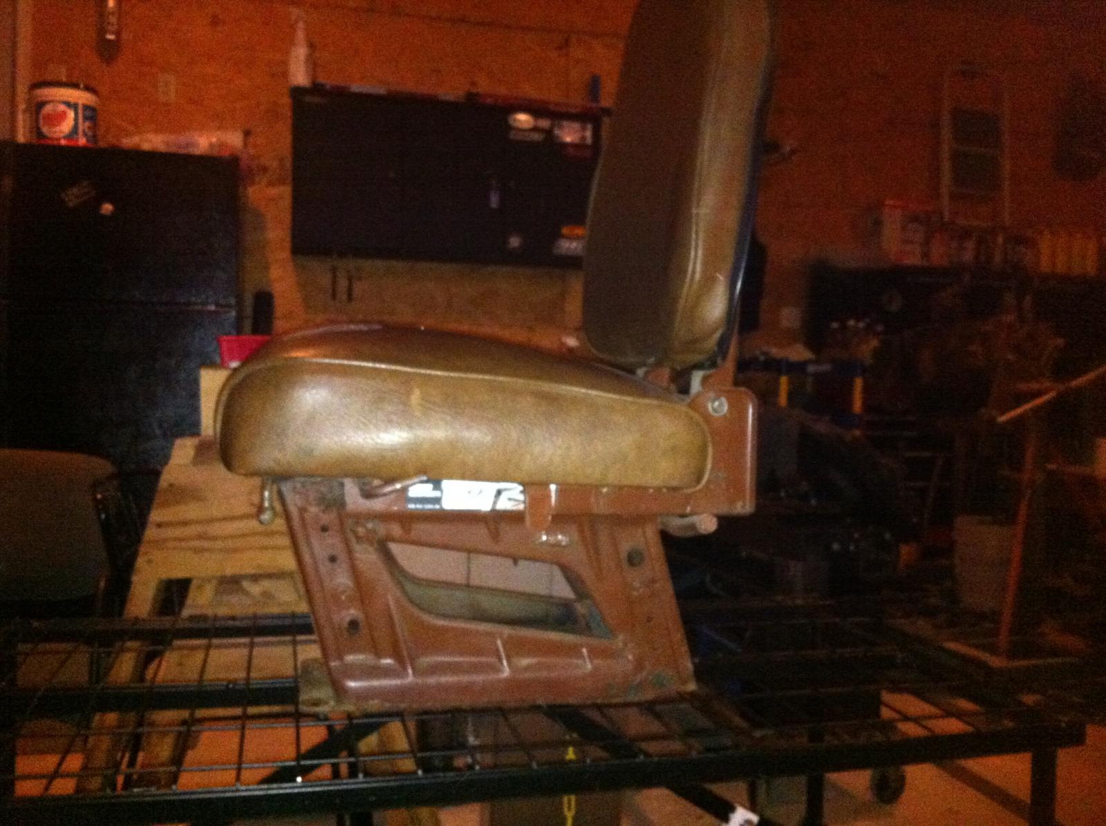

I have 12" with the 20" original wheel. I gained almost 2" over the other seats that where in truck. My " original" seats are about 4 seats that Somebody welded together with welds that looked like lava rock. An original bench style passenger seat would have worked better for me, but I don't think it was available in the B67's. my shifters come through the middle of my floor and I don't think there would be room.

The driver seat is 1" lower and 1 3/4" back further then the seat I took out. I have no idea how that measures compared to an original seat. That one appears to be several peiced together. I could prob sit Indian style on the floor and be able to see.post-18910-0-66461000-1449370733_thumb.j
