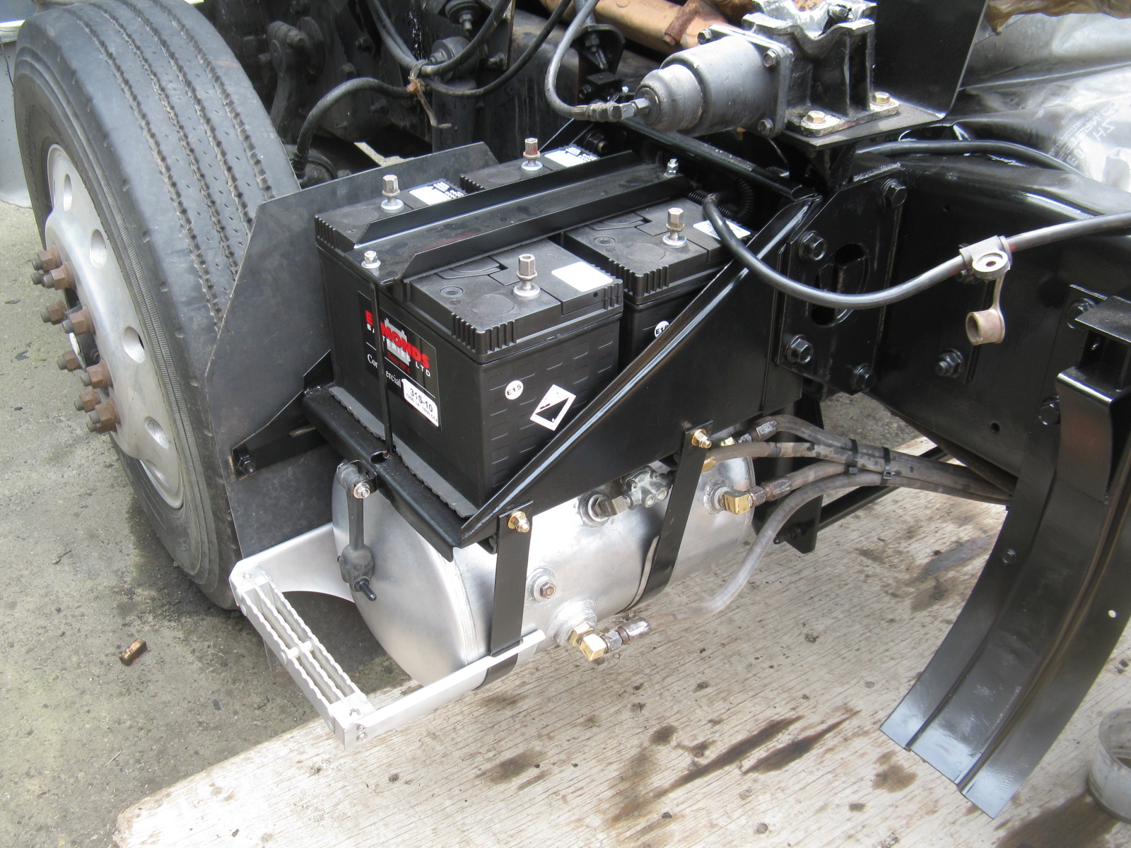

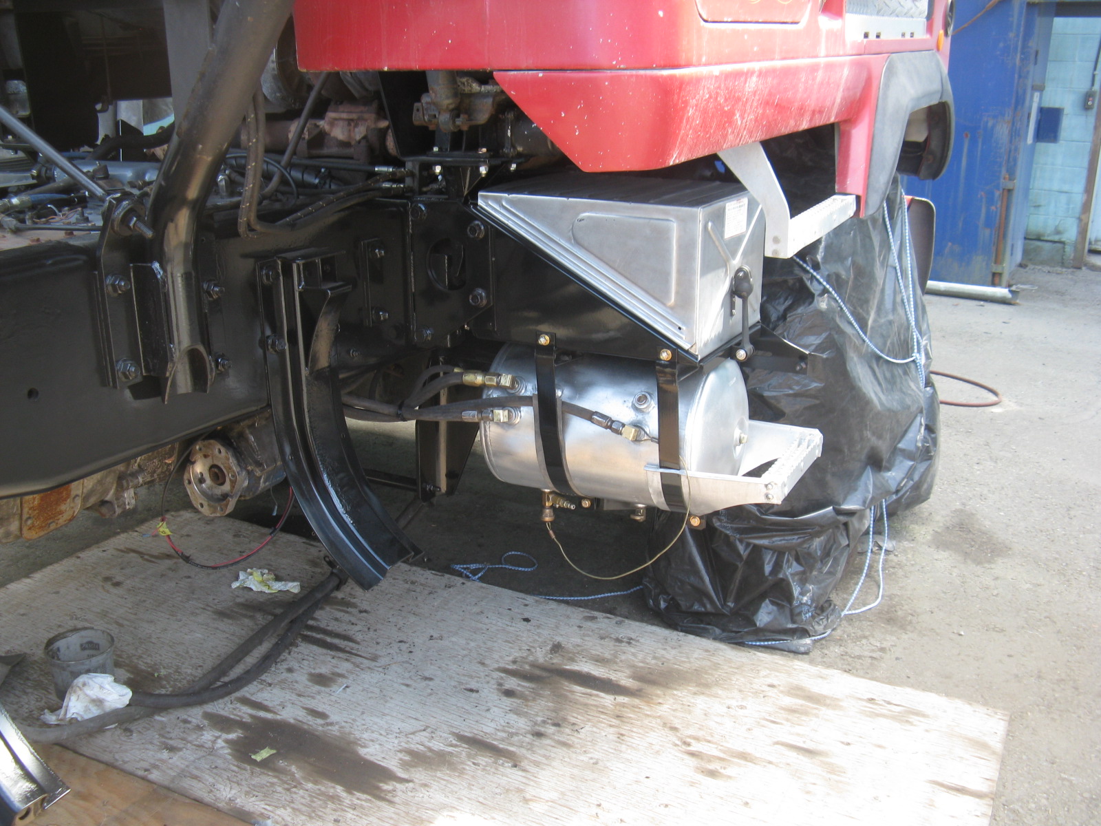

Does that battery box hold two n70 batteries? Might get one for my R model of so. Seems to be good quality.
most usually they fit two Group 31 batteries
not sure of your numbering system but this link may help
http://www.batterystuff.com/kb/tools/bci-battery-group-sizes.html

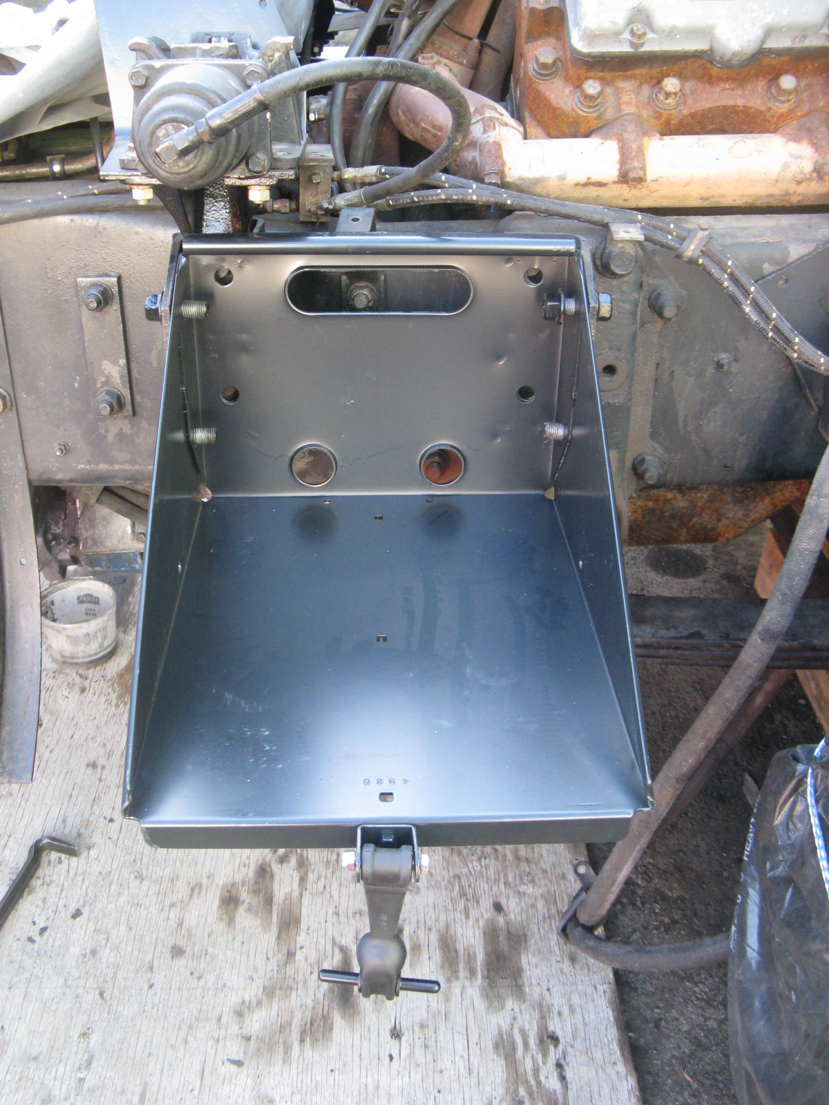

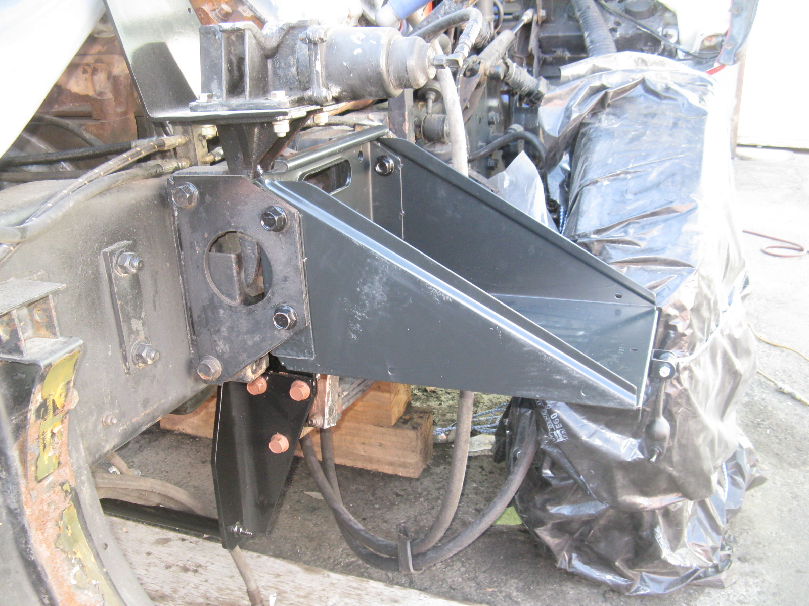

box dimensions are... 18" long x 14" wide x 10" high
note... there is a "lighter duty" version in the PAI book, p/n FBB-4635, it does not have the side mounting holes or reinforcing angles.. I bought the "heavy duty" FBB-4986..
Vlad,
the rubber latch is included
trial fit into my MH this weekend...
Farmer

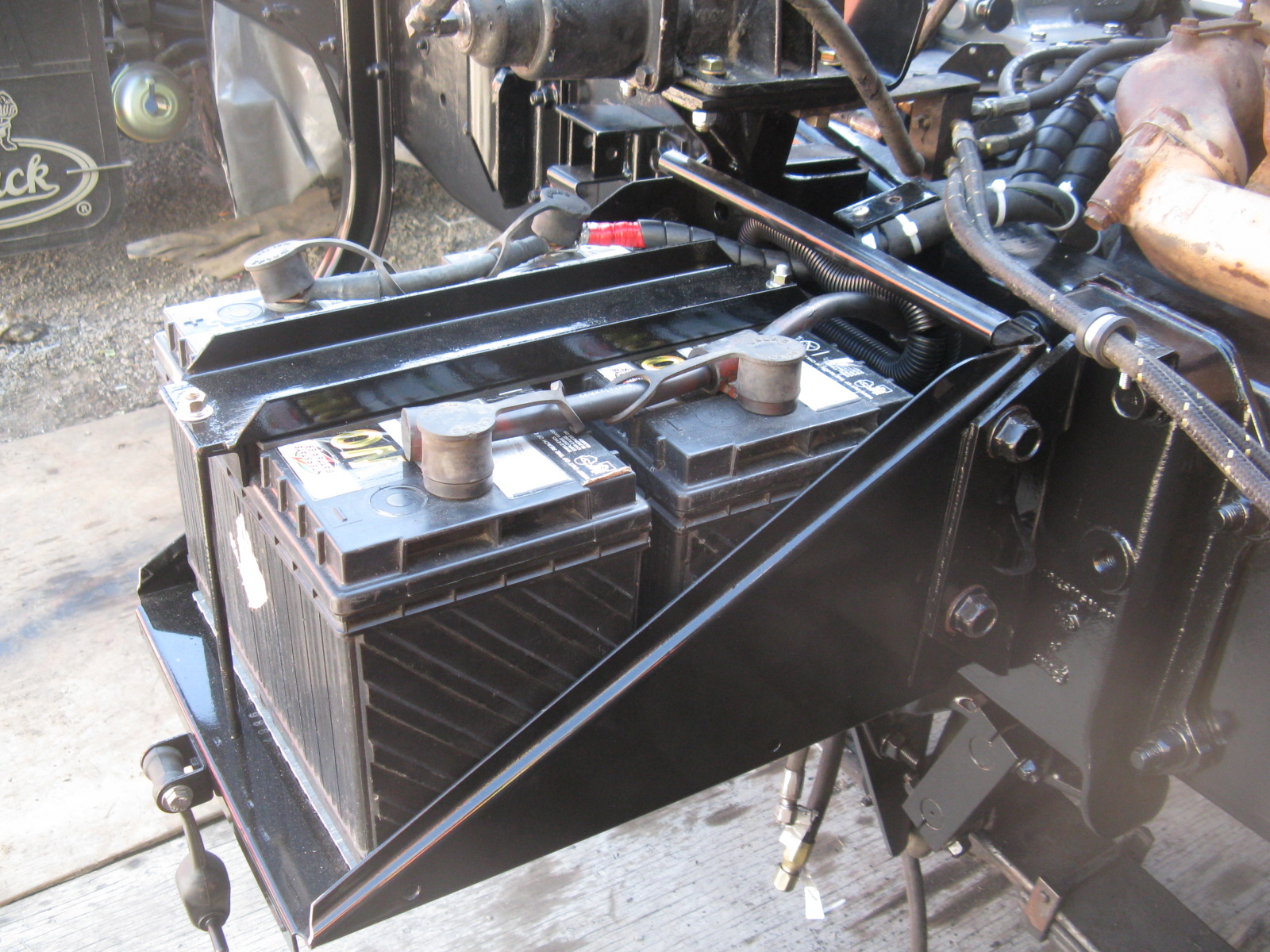

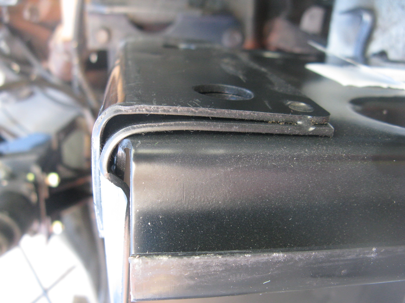

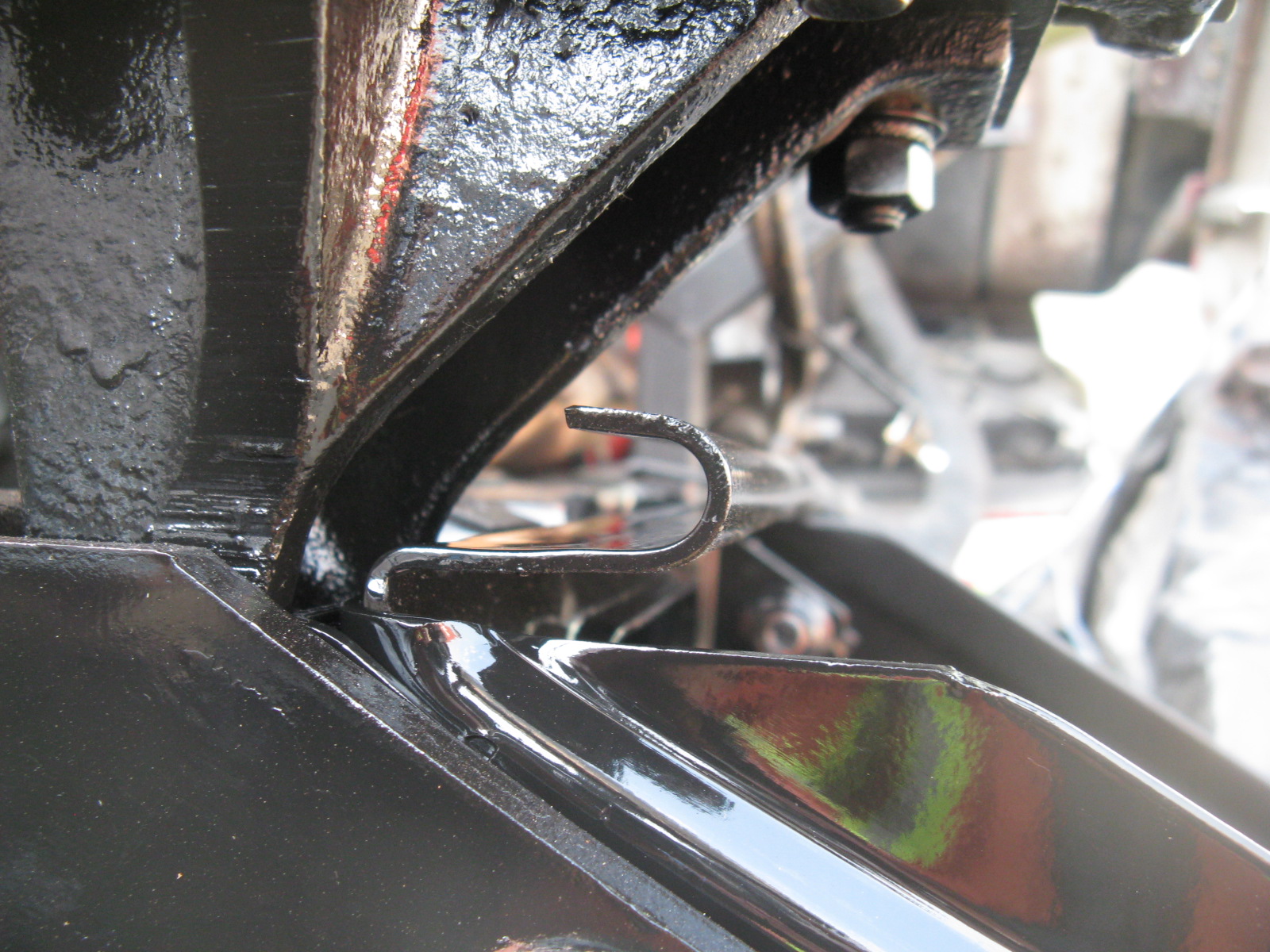

I would say NOT the same, there are a few minor differences, the way the top lip for the cover is rolled and the mount for the rubber latch is bolted where my original is spot welded..
BC Mack

With the help of my google machine, I was able to find that group 31 batteries are very similar in size to our n70 batteries.
Interesting the little differences between the two countries.
Once I tracked down the costs and got the lighter version 4635 more expensive than the heavy one.

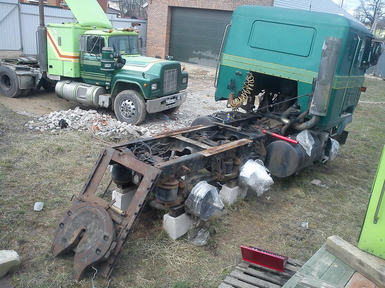

And looks like I'm far from the need of the box at the moment :whistling:
post-3971-0-79696000-1433532798_thumb.jp
Vlad
don't get worried...
one year ago my rear chassis looked like yours... "my summer project" of weekends, just plodding away, your MH will soon be glorious..!!!!

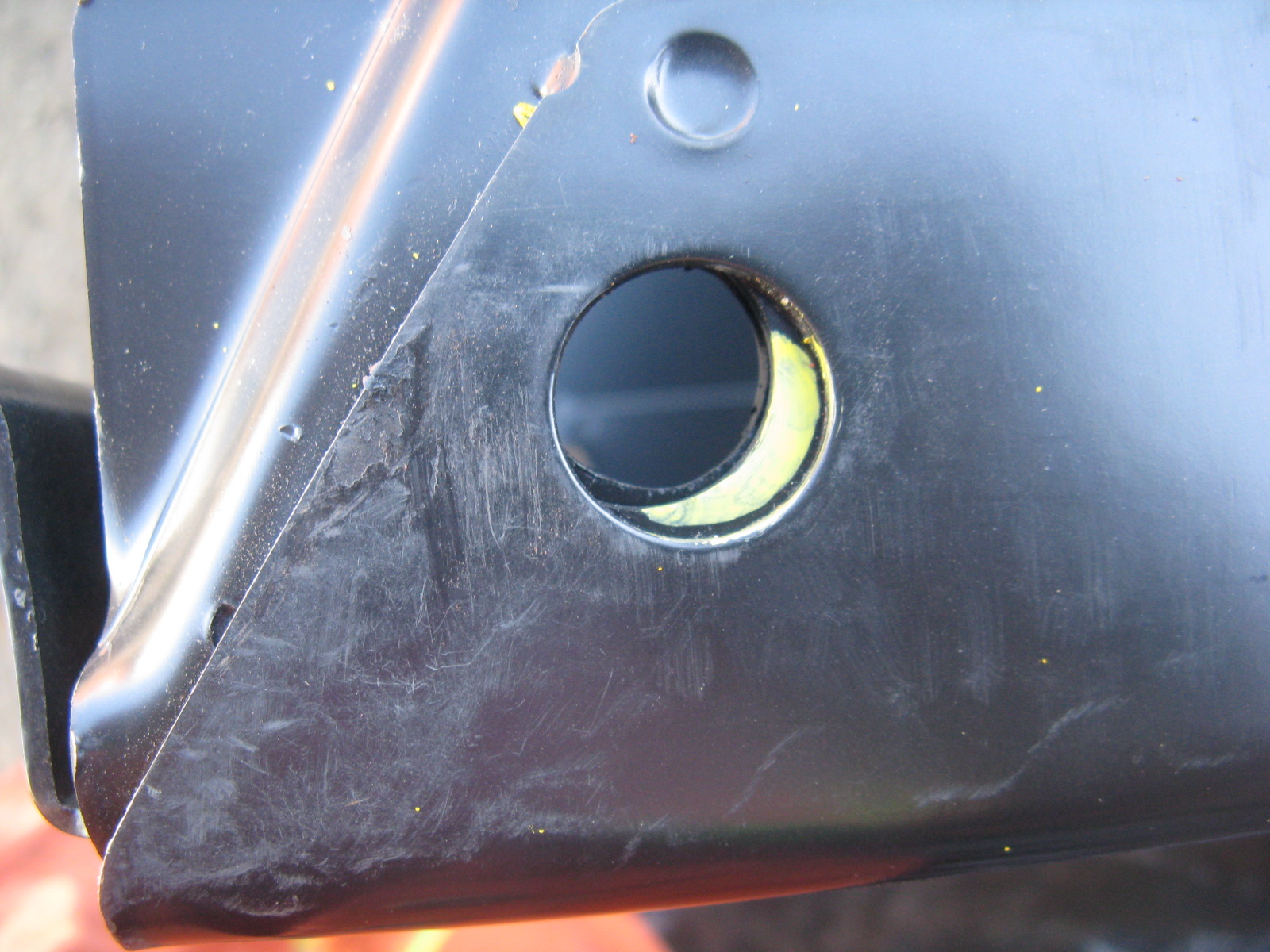

Seems like a good thing in General.
Minor filing doesn't seem to me as a trouble. Worth $300 on my mind.
If it finally sits well and able to hold bataries I would say it's good work out.
Thanks again for sharing the experience.
BC, thank you for pointing out the nuances.
Nobody can do it as perfect if hasn't put his hands on.
Glad to see the work checked off the list.
I used the 4635 bottoms and 4636 tops for my B model and have held up good until I lost a top on the way back from Iowa...the guy down at the napa store got me another 4636 top for 65.00 and i thought all was good till they added 25.00 shipping...what can you say!!!!...Jim
