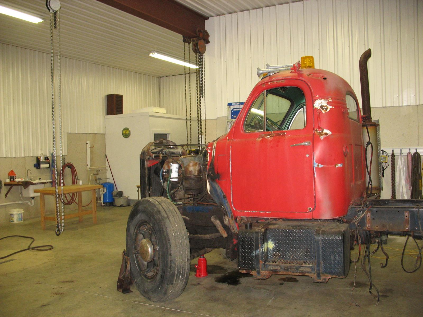

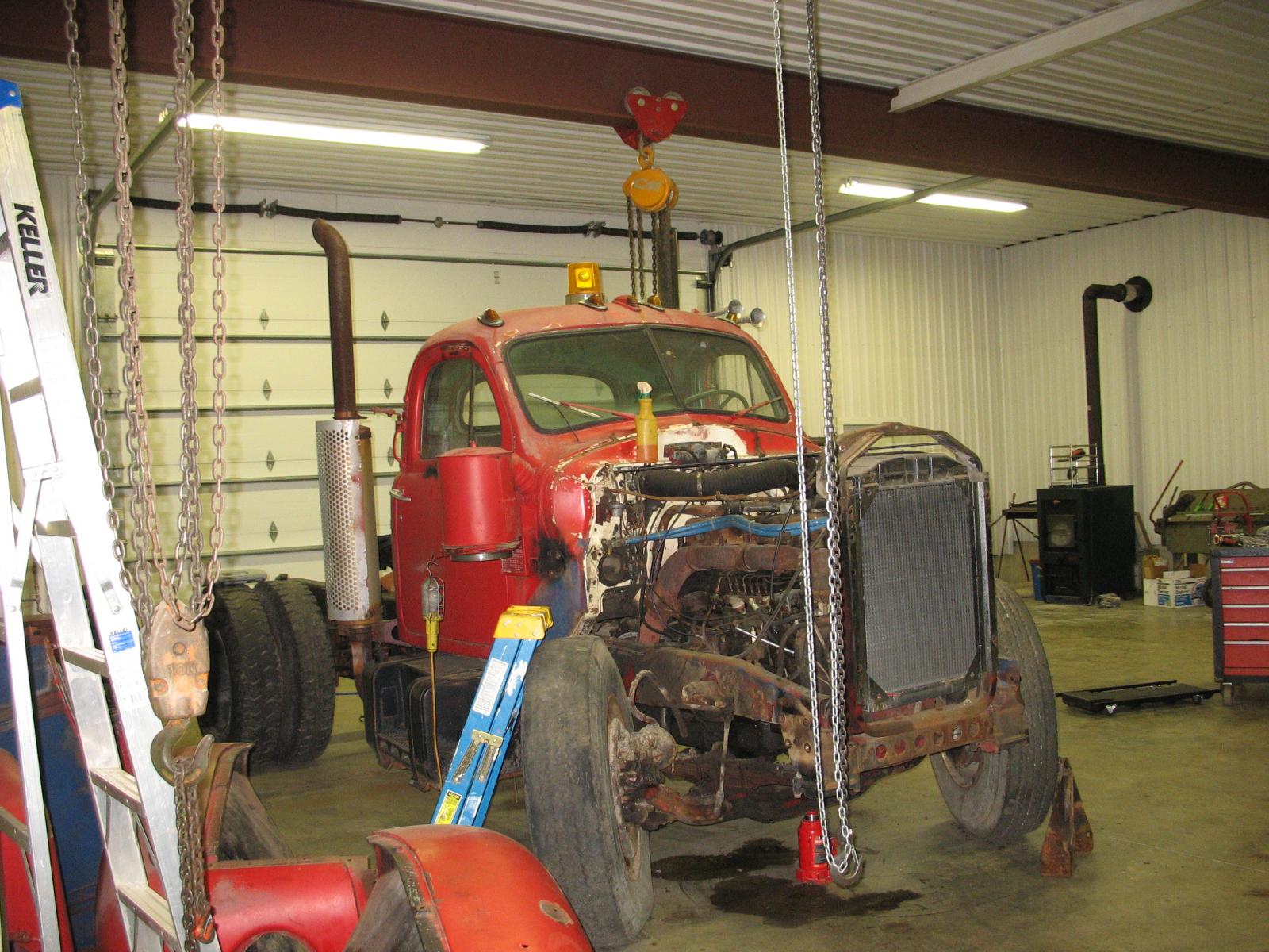

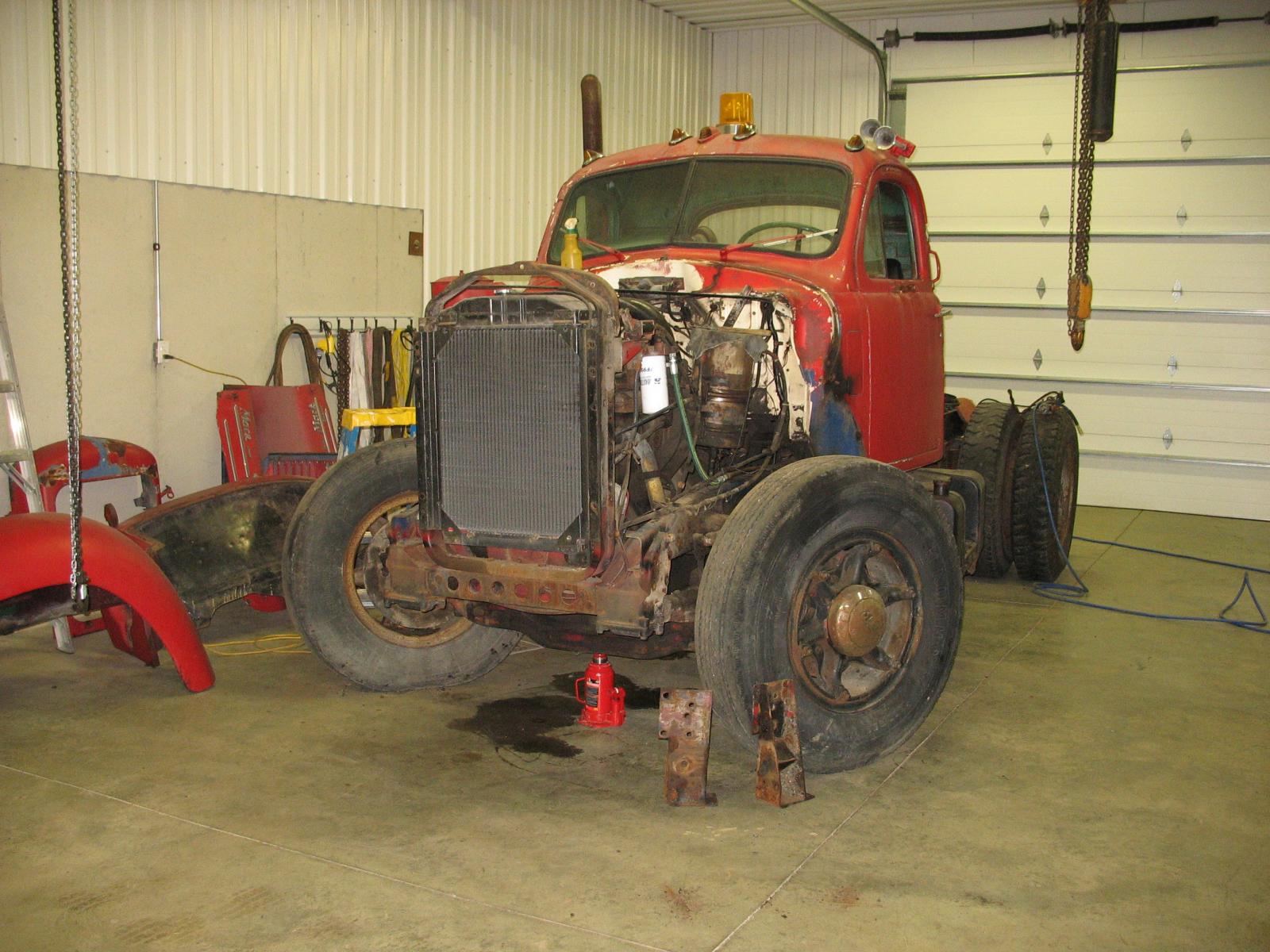

Pictures and a question
Don't know if it is the best way.
