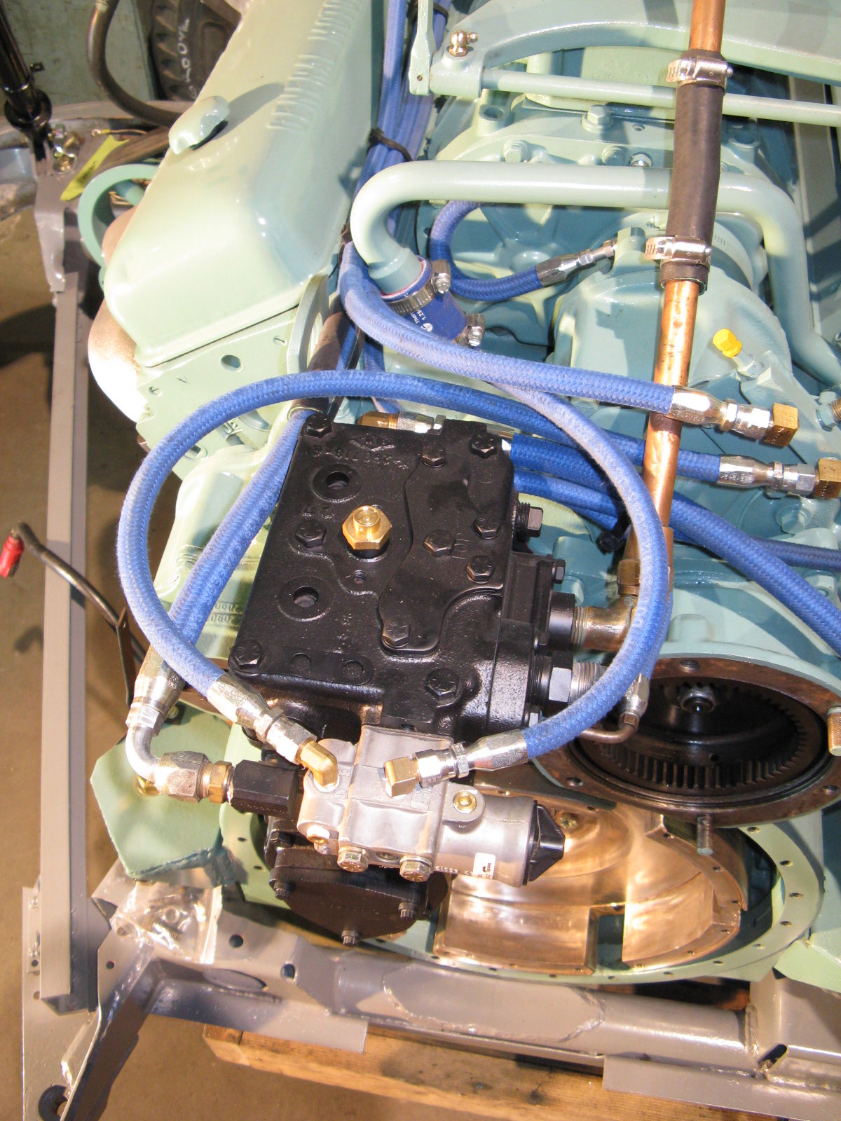

if you are hearing a high pressure or high velocity air purge sound coming from under the hood your over pressure purge pop off valve may be going bad. There should be a small (1-1.5" round screw in pop off valve on the air compressor i think on that truck, it is the safety pop off for over pressure and should bleed air over 150. However they do go bad every now and then and bleed at a lower pressure, its just a spring in there under tension against air pressure, they can sound like a purge valve on a dryer, I have replaced several in the past so theres something to check out.
I replaced the relief valve on the tank(first thing I thought of), didn't realize there is one on the compressor itself? Strangely it never does it just idling at full charge. Only when on the road.
yeah, some trucks have them on the compressor, some the tank, some both. I was going by experience with similar trucks on the placement so I may not be dead on.
