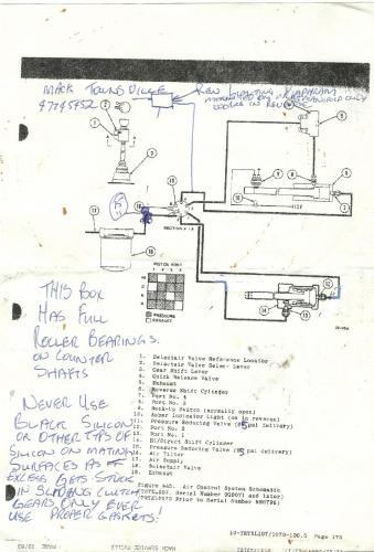

post-7036-0-18743700-1399156359_thumb.jp
Jim

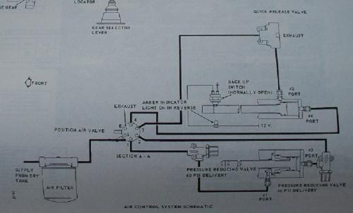

Gudday all the pressure regulator Im talking about is on the top of the box some 12 speeds have 1 regulator some have 2 depends on I dont know someone much smarter than me can proberly tell you this one is set at 65 psi and the regulator is before the gear stick selector if it is set to high you will hear air leaking out all the time even with good seals good luck and keep us informed seeya :)
Paul
post-17290-0-95425500-1399188922_thumb.j
When I was having problems with my 12 speed, an old time mechanic told me to bypass the regulator and the trans will shift like a new one and he was right. It's bin disconnected for two years now with no problems. I think the problem is in the shifter handle. Did you get the O-rings from Mack? Not sure if they're a special size.
