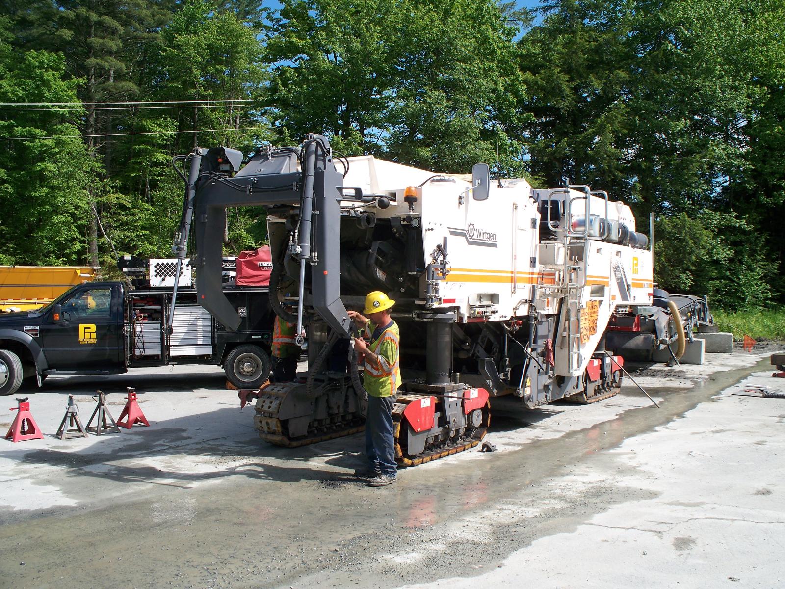

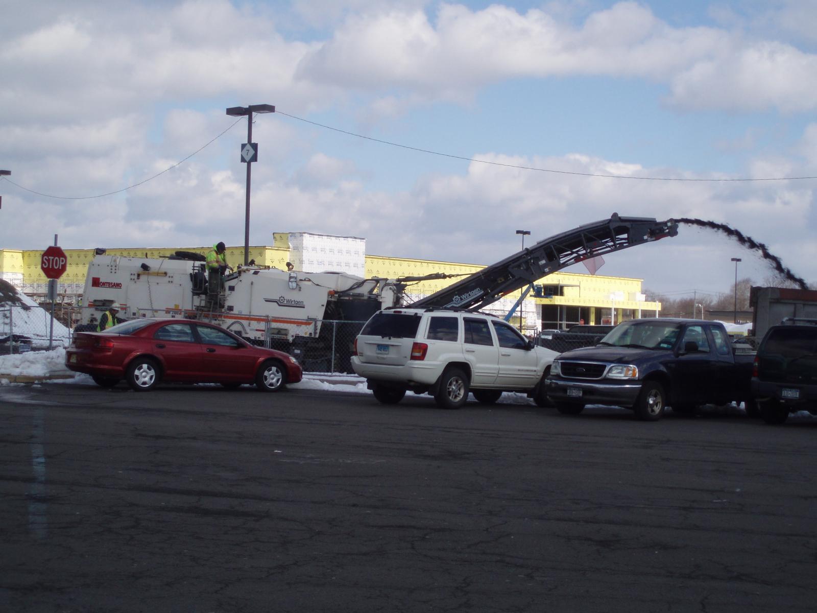

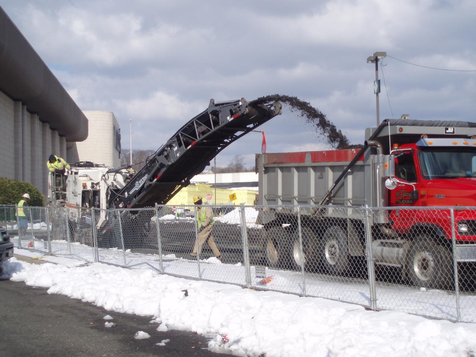

Here you go Tim I was thinking of you when I spotted Montesano (another company all over like horse shit) doing all of the site work at the Nanuet Mall reconstruction.
Cheers, Rob
Ah! now I see it! Rob, is that from this spring? Starting early! That's awesome. Looks Like a 2000 series one size smaller than mine. Couldn't be a state job with snow on the ground still. Thanks for posting these pics!

This was yesterday.
they usually dont mill off that much, what was it about 4 inches below the surface?????
The deepest we go is 12" normally and that doesn't happen very often. What has happened in the past was a gas station leaking fuel and it was under the pavement then....FOOM!

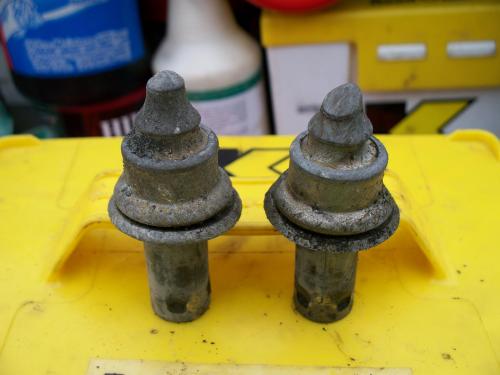

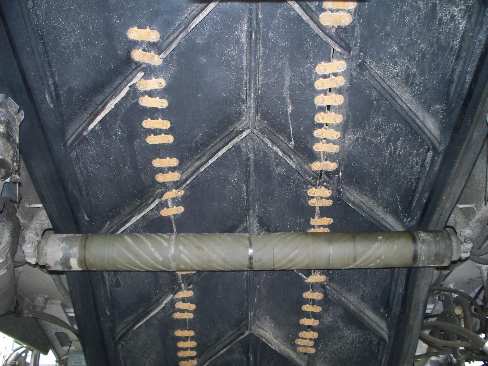

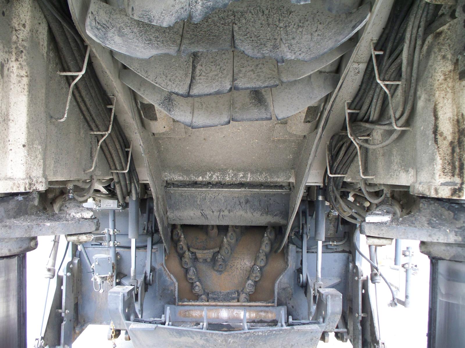

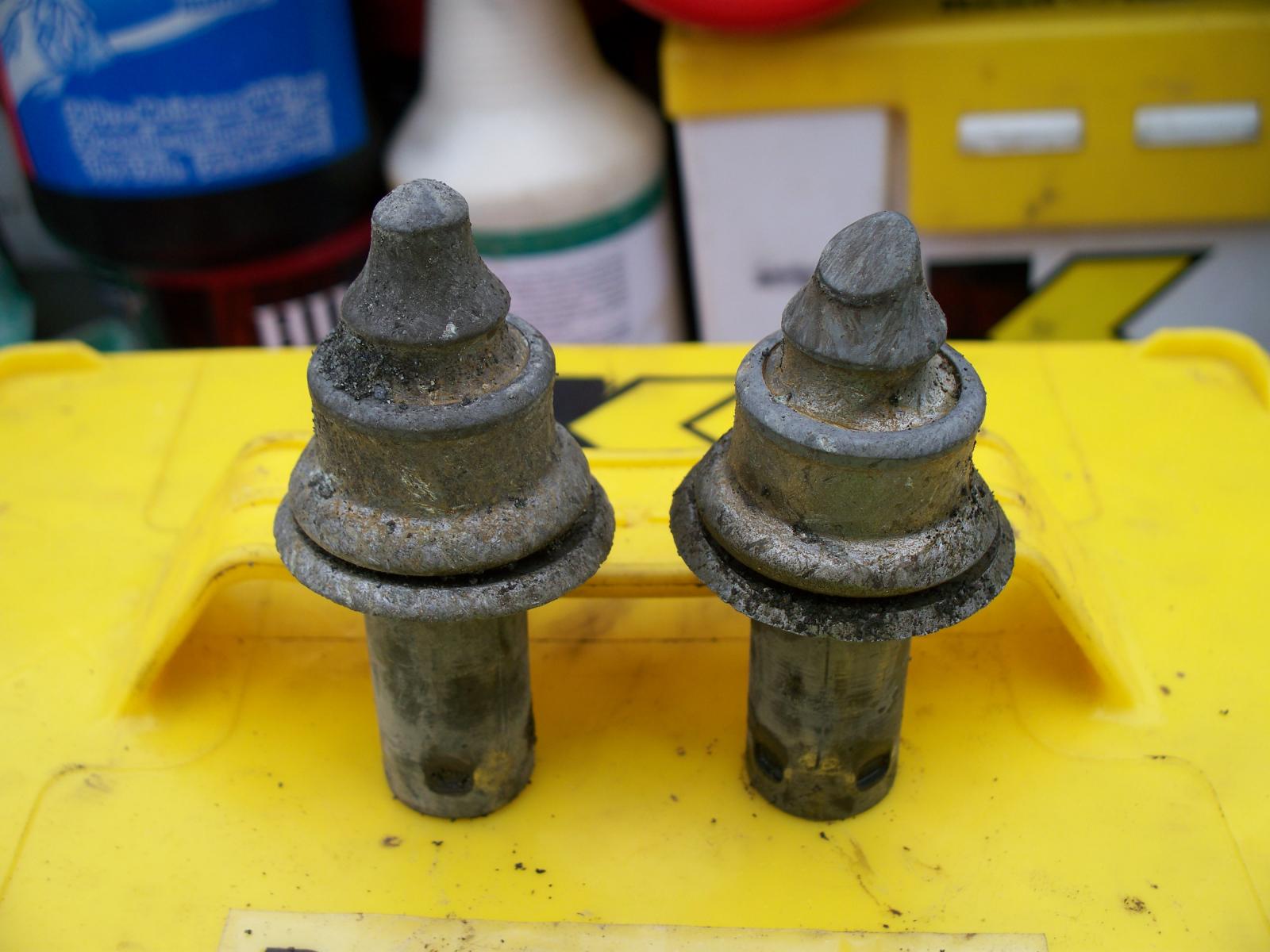

One the interstate at 2" we can mill up to 28,000 SY on one set per day. It depends on the stone mix. Granite will eat teeth fasterpost-426-0-63188900-1363916016_thumb.jpgand if your in a 4" cut with sharp 6 inch ballast under the mix you will be replacing the lower conveyor belt in less than 300 hourspost-426-0-17285100-1363916225_thumb.jpgpost-426-0-03259600-1363916312_thumb.jpg

OK, follow up question. About how many teeth on the machine and how long to change them? Cost?
Can they work on a concrete?
Thanks, Jim
There are various drum patterns and my past Cat mill had 260 teeth and the new Wirtgen has 186 teeth. Interstate work change everyday about 18,000 to 28,000 square yards depending on abrasiveness of road. Teeth cost can range from $4.00 and up per tooth and "good" used teeth are saved and giving to the reclaim crew who are not very happy to receive them but is a great cost savings. Yes concrete can be milled but very slow going and frequent changes on the teeth. The mill dislikes all types of steel and is a horrid sound when this happens.post-426-0-87365600-1363958350_thumb.jpg
